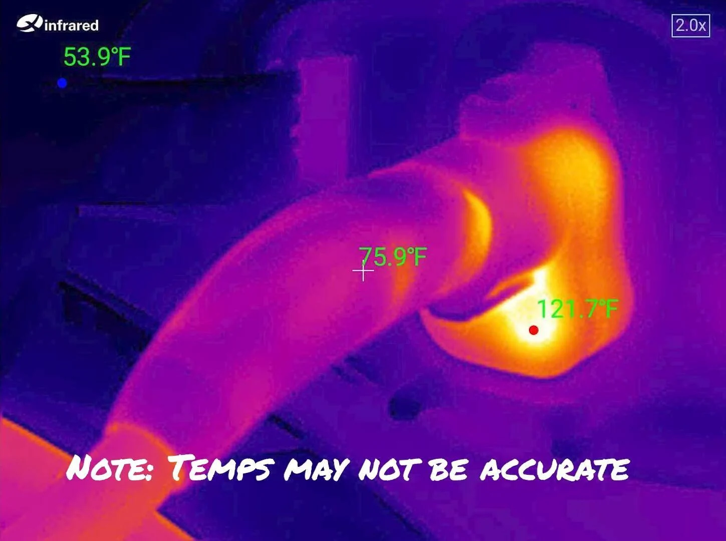

EDIT: Right side of case is expected to be hotter due to the internal design of adapter (right side bus bar is closer to the case than left side), see post #27 below. Not a problem.
What I see there is a little bit concerning, because it looks like one of the DC pins is a lot hotter than the other. This could indicate a bad connection on the one pin. The two pins should be approximately equal temperature. Not sure if you guys have Car Scanner to look at the DC pins temps from the car side of things?
I suppose it's possible the internal design is asymmetric (e.g. one bus bar is more rearward than the other), but you might want to share that thermal photograph showing the heat on only one side with A2Z and see what they say.

With the angle of your IR camera photos in this video, and with the extra casing around the Ford adapter, it's difficult to see the relative temperature disparities very well. If you charge for 10-15 minutes, get the camera ready, and then pull the adapter off and immediately take a photo of the pins on the adapter and on the car, you can better show the temperature differences between the two pins and also between the two adapters.

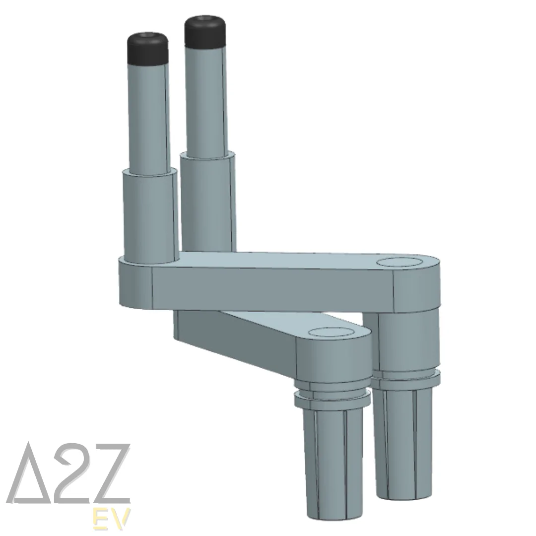

I asked A2Z about this and their CEO sent me this image. They way the pins go from NACS to CCS in the adapter they form a crossing pattern. That is why the heat looks uneven, the bars inside are not symmetrical. The thermal image is basically showing more heat from the bar in front.
Ford Mustang Mach-E A2z fast charger DC_PINS
11,410
25,166
Cool, that's exactly what I was thinking about if the internal design was asymmetric. So yes, the right pin will appear hotter because that bus bar is closer to the case than the left side.
I forgot that positive and negative pins swap sides with NACS vs. CCS, so the bars would have to cross over internally like that.
