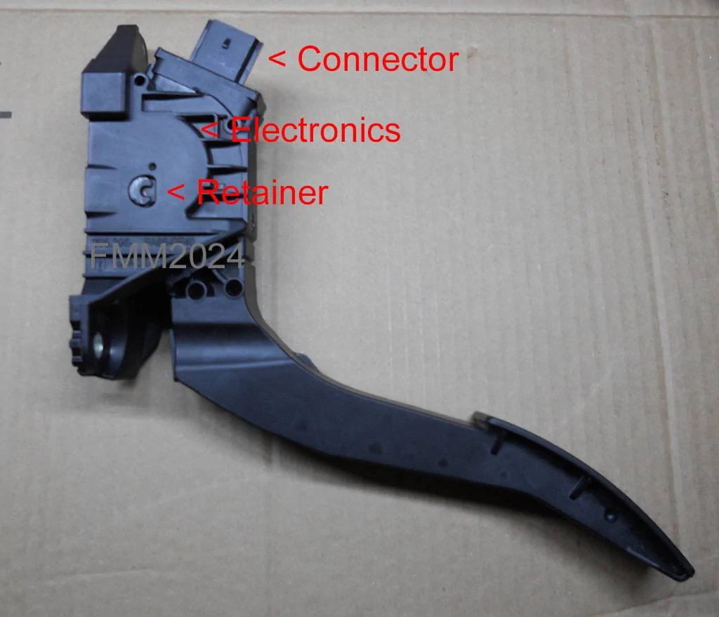

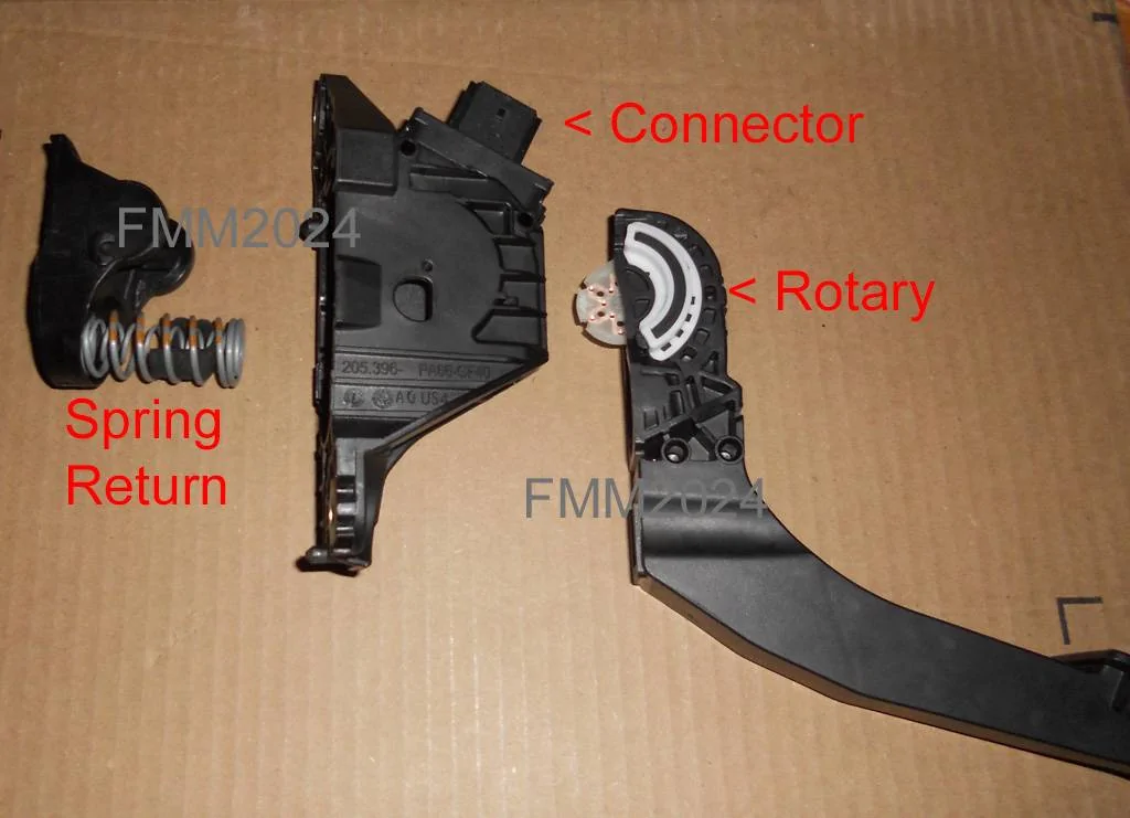

Well, I finally got around to investigating the failure mechanism. The only thing that could have happened is that the assembly (either one or both tabs) was not fully engaged in the retainer. There is one on both sides. This is what would cause the spring to relax and make the pedal feel loose. The deceleration was caused by the elements losing alignment. The connector and electronics are one assembly. The rotor aligns with the electronics to set the accelerator pedal position (APP) and send the data to the PCM. It appears to be a capacitance device. The schematic shows it as 2 variable resistors (no doubt for simplicity). There are 2 of them in the assembly with 6 connections. It is possible that the third press on the pedal may have caused the assembly to seat properly. Testament to why it never showed up again and when removed and inspected, it was in the retainer.
