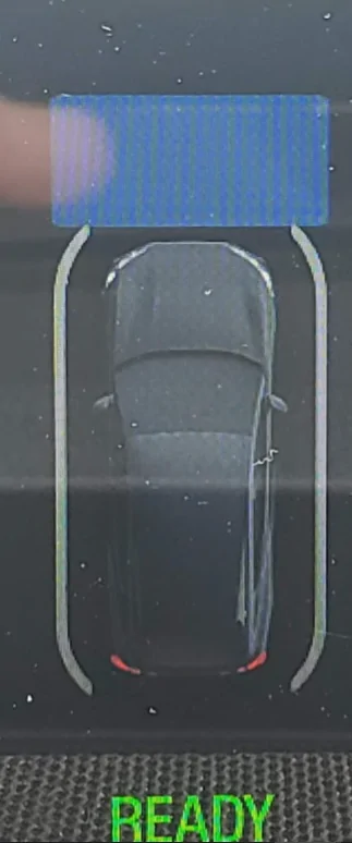

I don't kno what does this mean
Ford Mustang Mach-E Adaptive cruise control symbols greylineson-the-sides-png
⬆ This means cruise control and lane keeping are enabled, but at this time, the vehicle is not tracking lane markers with high confidence. As a result, the vehicle is not assisting with keeping you within the lane.
You will see a gray Lane Keeping System (LKS) indicator to the left of the odometer.

This is like your first example... Cruise control is on. Lane keeping is on but not currently functional (the vehicle isn't confident about lane markings at this time). The LKS icon is gray.
You also have follow distance indicator turned on. This is showing you a blue box since you have ample distance to the vehicles ahead of you. It shrinks and turns more alarming colors as you move closer to the vehicle ahead of you.
