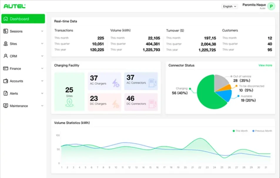

I'd take a look at the Autel MaxiCharger AC Elite Business.
https://autelenergy.us/products/maxicharger-c50-ac-wallbox-ev-charger-with-in-body-holster
I think it checks most, if not all of your boxes.
- There's an App for residents/users. https://apps.apple.com/us/app/autel-charge/id1578454464
- There's an App for installers, operations, and maintenance. https://apps.apple.com/us/app/autel-config/id1607007731
- There's a management portal to track charging, billing, etc.
- It will connect by Bluetooth, WiFi, or 4G SIM card for management, etc.
- You can issue RFID cards for access by residents, also restricting access by non-residents.
Autel offers RFID cards but you're not limited to theirs. You can buy them cheap, in bulk on Amazon in case people lose them, etc.
- The RFID card can be tied to a credit card for billing/payment.
- You can use a QR code on the charger display to pay with credit card.
I guess you could have a contract with a service to handle billing, etc., but I'd imagine they're going to charge for that service, which will increase costs, etc.
My understanding is that Autel's management portal pretty much runs itself and needs little oversight. With a well designed management portal, I would think that the Condo association could give the treasurer access for billing and reports, and, if there is a maintenance person, give them access to it for their duties.
