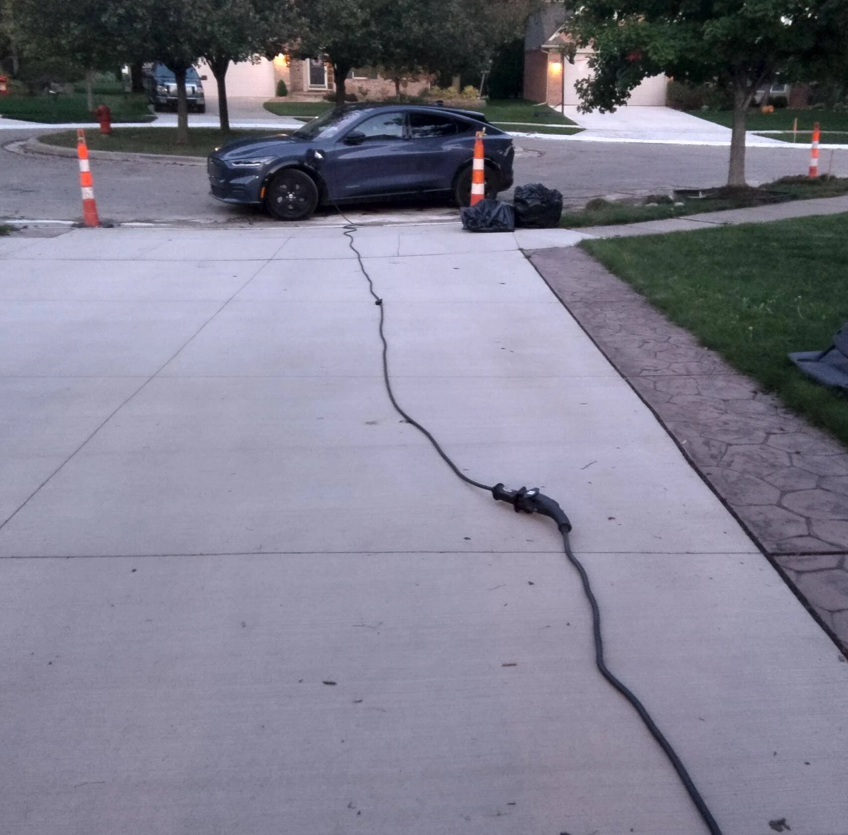

I have a 40' J1772 extension and use it occasionally when camping or when I can't park the car in the driveway.
Such as when they are replacing the curb:

I particularly enjoyed reading about markboris's experiece and JamieGeek's photo said a thousand words.
