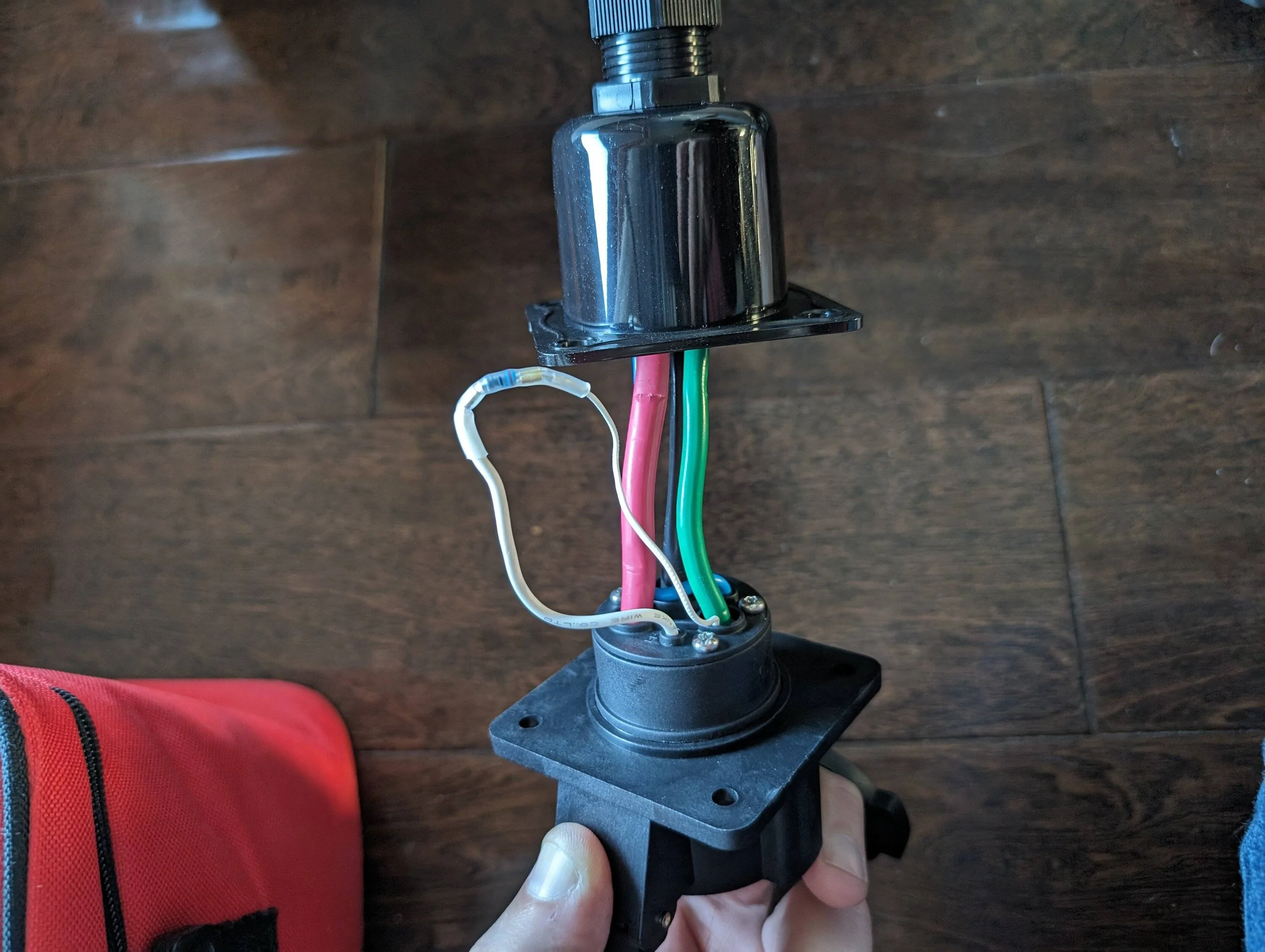

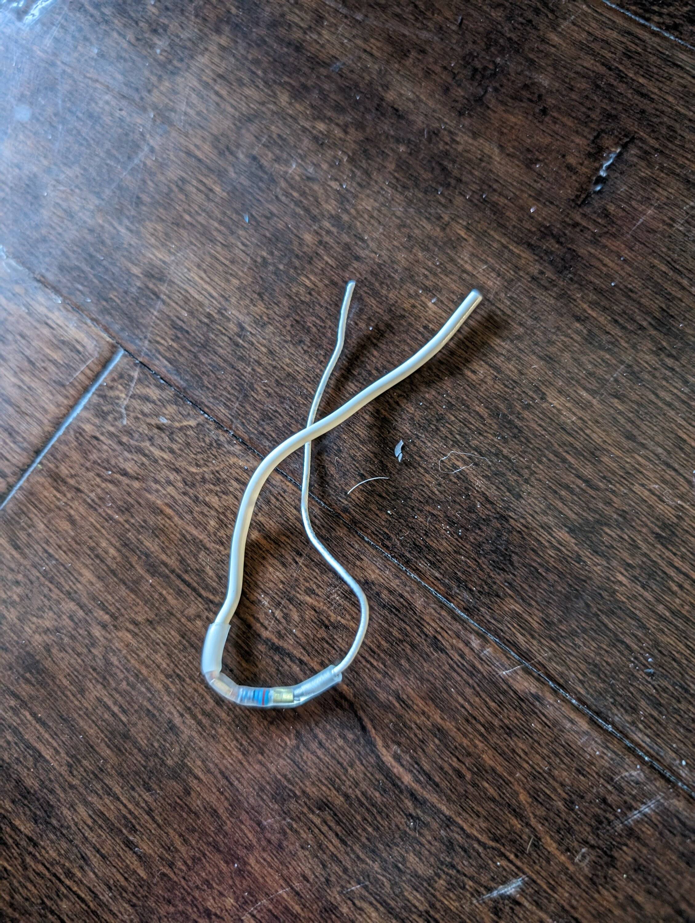

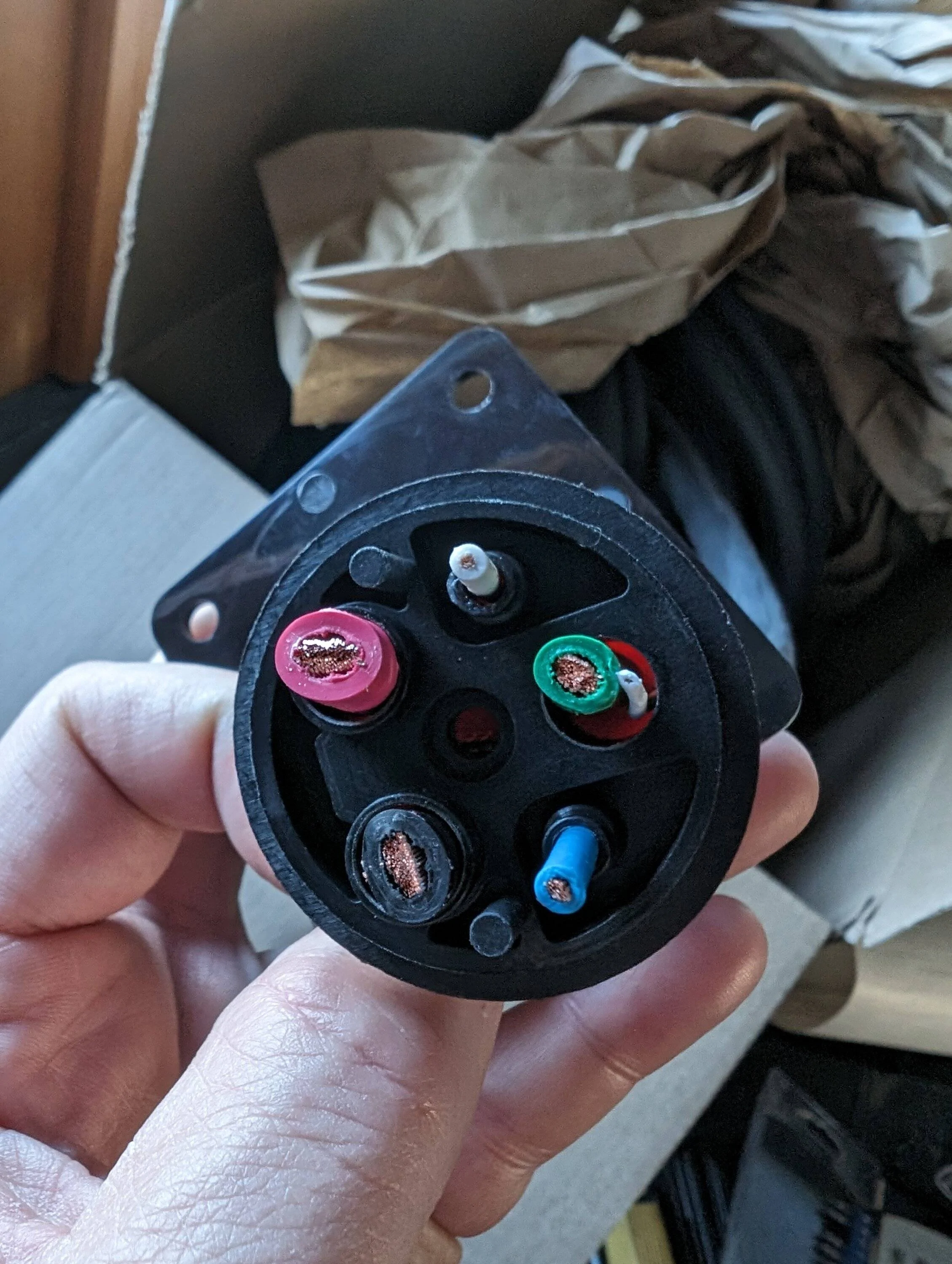

I did this and wanted to close the loop on the white wire and the pics. Attached is what it looked like in the extension cable.
