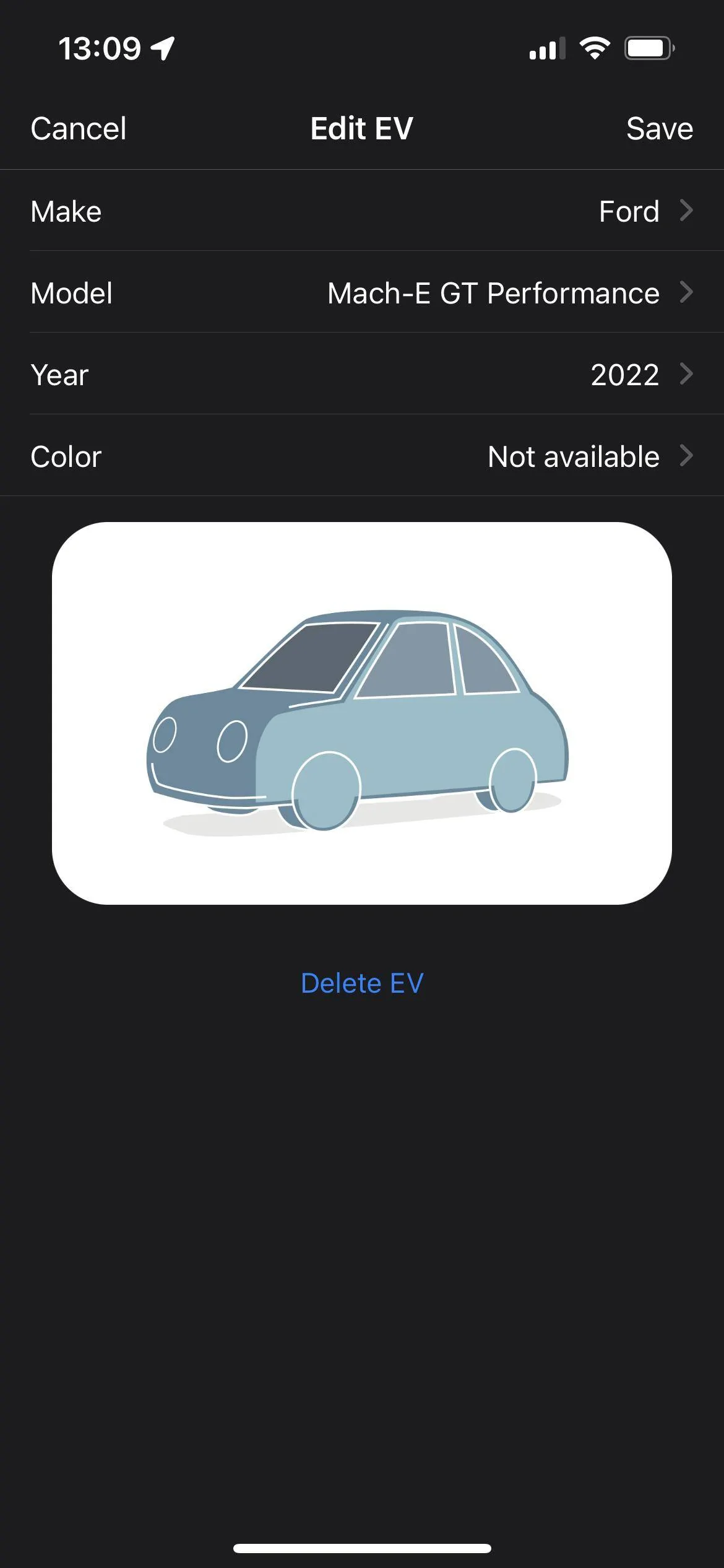

And btw, the EV image in the CP app sucks, I hope they will update that, XD:
Ford Mustang Mach-E ChargePoint HomeFlex questions IMG_1609
