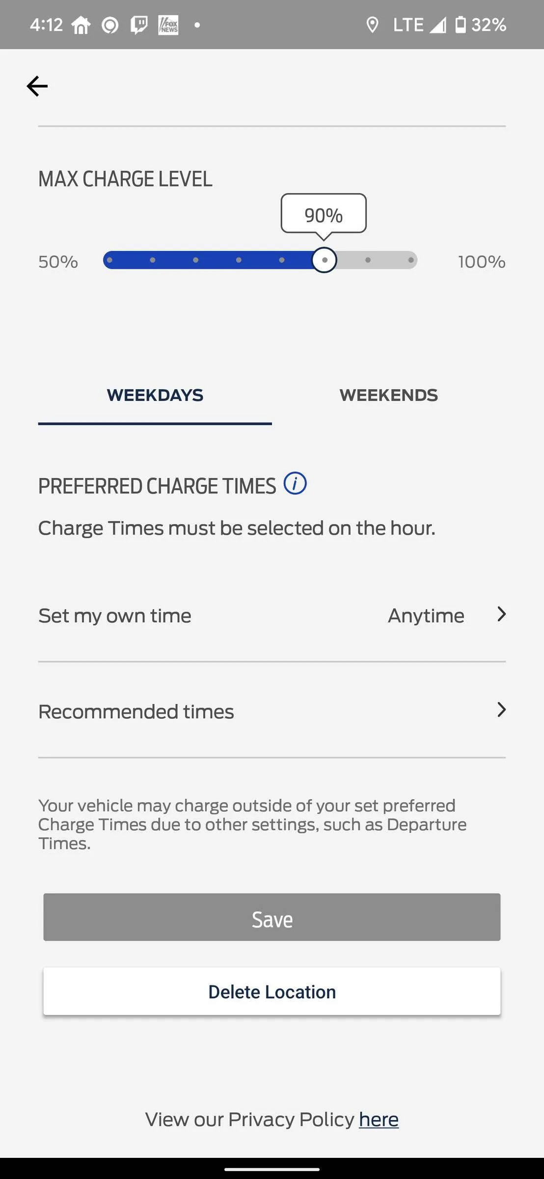

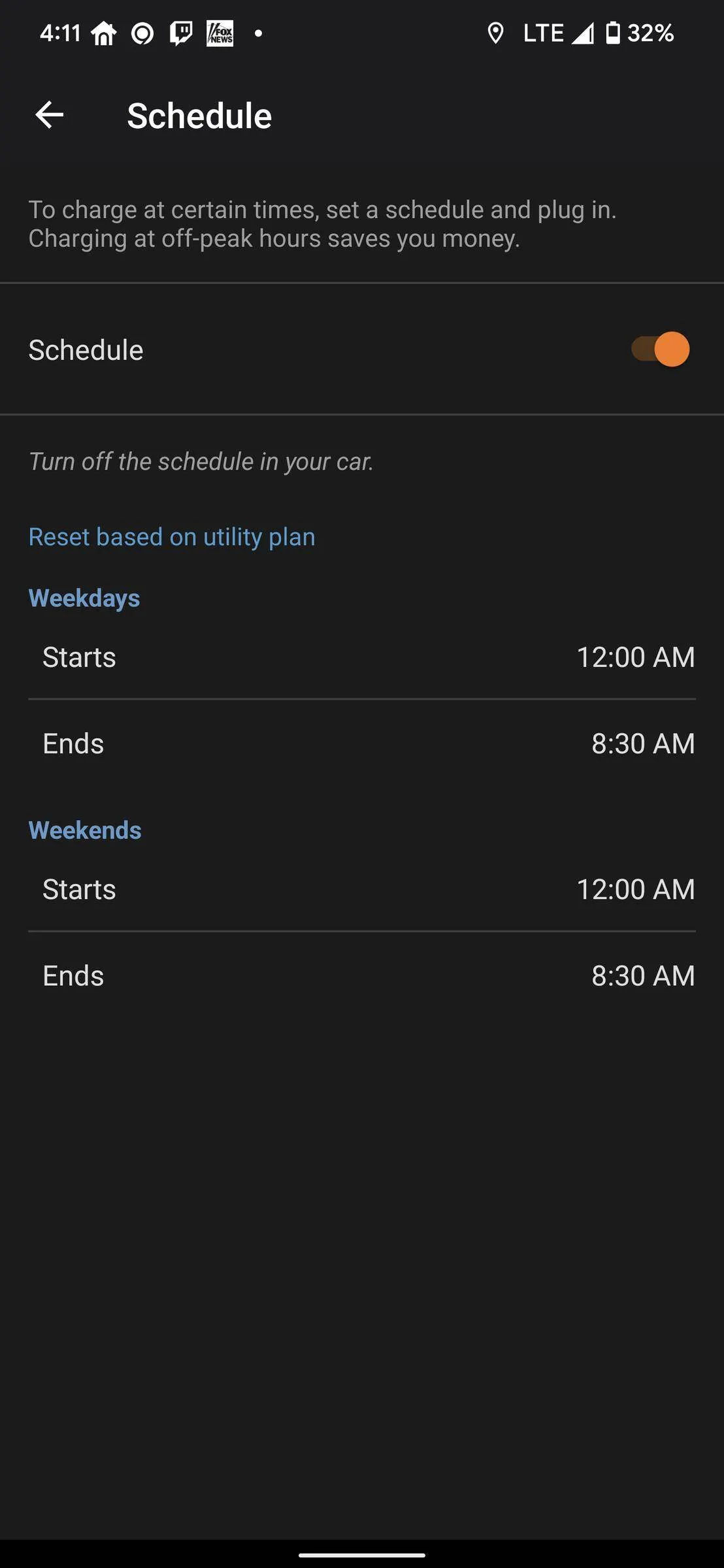

I have the same car and charger. In order for it to work set the following as shown.
Do not let the car manage anything other than the percentage. This works flawlessly.
If you need to charge in the middle of the day or outside of the schedule the car will always accept the charge this way. Do a quick double plug in and it'll charge at that time.
I hadn't thought of this. I'm on a TOU plan and occasionally (but rarely) needed to initiate a charge off my overnight schedule. I've found overriding the FP app to start a session to be a pain and maybe using the CP app (w/ siri commands) might be easier set up this way.

CISO
You can also double plug to start. In other words:
hold the button on the charger
Plug into the car with the button depressed
Remove it immediately
Plug back in releasing the button
The double plug action on charge point tells it to override and charge immediately. Since the car is set to charge anytime from home it starts charging. You don't have to open an app or anything.

I would remove the charge point charging restrictions, let your Mach E handle everything. Seems people run into problems with both set
This is exactly what I do. I leave the ChargePoint set to always charge, and let the car handle the scheduling.

First thanks to everyone for the quick responses. I tried what @DevSecOps recommended and it worked fine. Started on time and ended when the car got to 90 percent. Just for grins, I will try the opposite, and next time I charge and set the Ford App to control and set the Charepoint to anytime. Again thanks everyone
One thing to note using the way I told you because a lot of people are screaming "precondition".
I leave for work at 7:15. As you can see my schedule is until 8:30. For starters I don't precondition, but I have tried it. The charge point, as long as it's in the schedule window will precondition in the way I told you. Just set the stop time to after your departure time by 30 minutes.
It will stop at your 90% whenever it gets there, like normal, and automatically resume to precondition.
There area lot of "let the car manage it" people, but I drive so much that I need the more than occasional charge mid day so not having to fiddle with a finicky app is best for me. Also, I had this charger with a previous EV and if the EVSE didn't manage the schedule it would often result in a charge error and no charging. So it's been habit for some time.

Just got my Mache GT last week and I am having trouble with charging. I set the Ford App to charge at home from 12-7 am and to 90 percent. I also set the ChargePoint App to charge from the same time. For some reason, the last couple of evenings the charger started at 4 am and cut off at 7 and I did not get up to the full charge amount. Not sure why the charger is not starting at midnight but instead at 4am. What am I doing wrong?
I have the same same setup and as others have recommended, go with the car's scheduling and unschedule ChargePoint. I have found ChargePoint to be a both little glitchy and less informative than I hoped for.

It is a bad idea to set schedules on both ends, whether to set it in the car or on the EVSE is a personal preference. I am on a TOU rate plan, with the lowest rate from 12AM to 6AM, the highest rate from 2PM to 6PM on weekdays (more than twice of the two off-peak rates), and the 2nd lowest rate during other hours. I set my ChargePoint to 12AM to 2PM daily, when I plug in my car late afternoon/early evening, FordPass shows "Charging Paused" until ChargePoint allows charging to start at midnight. It has been working as expected every night for months.
