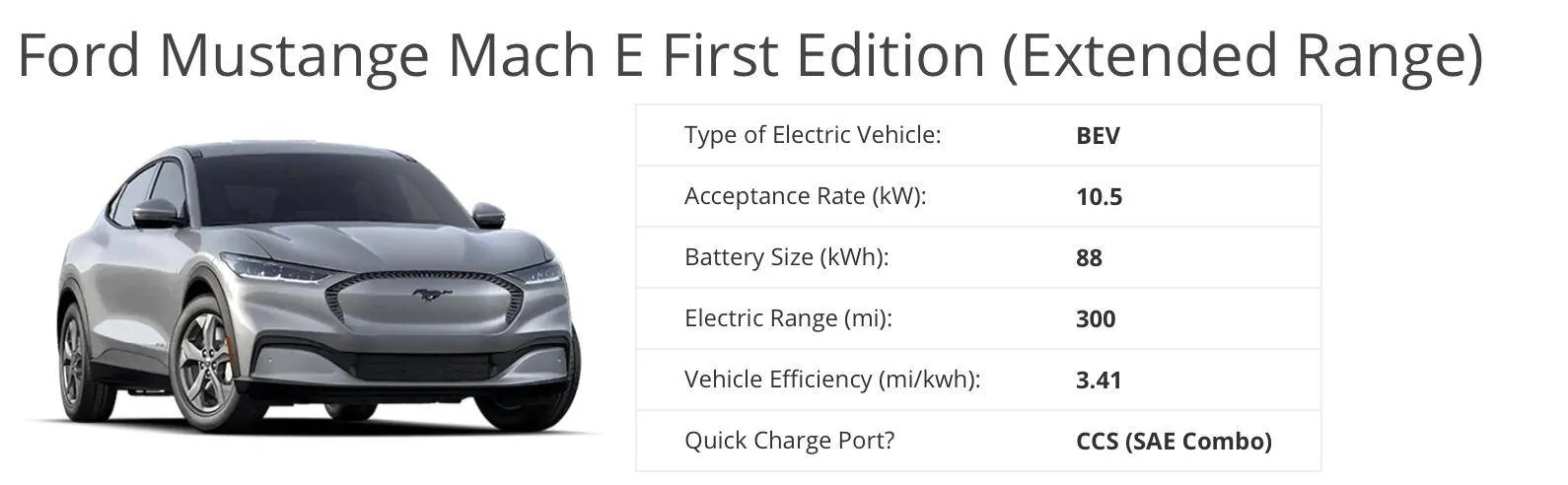

Okay, but in theory, if the Mach-E can really do 48A at 240v, that's 11.5 kW.
Agreed. Maybe even at 12 kW with current peaking to 250v.
ClipperCreek seems to think the Mach E is limited at 10.5 kW:
Ford Mustang Mach-E ChargePoint Discount Screen Shot 2020-12-08 at 10.39.23 AM
The problem is we just don't know.
