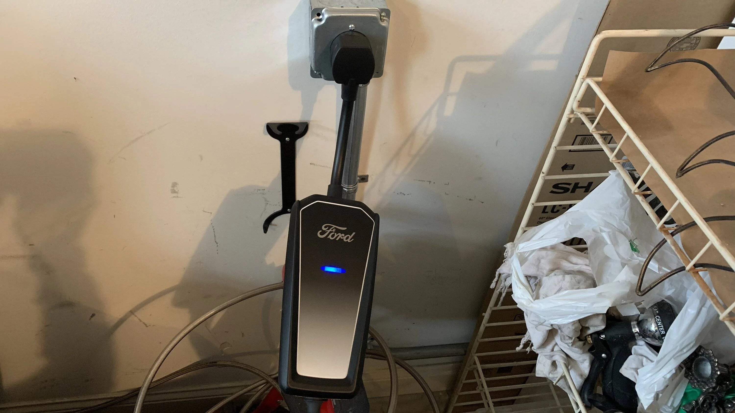

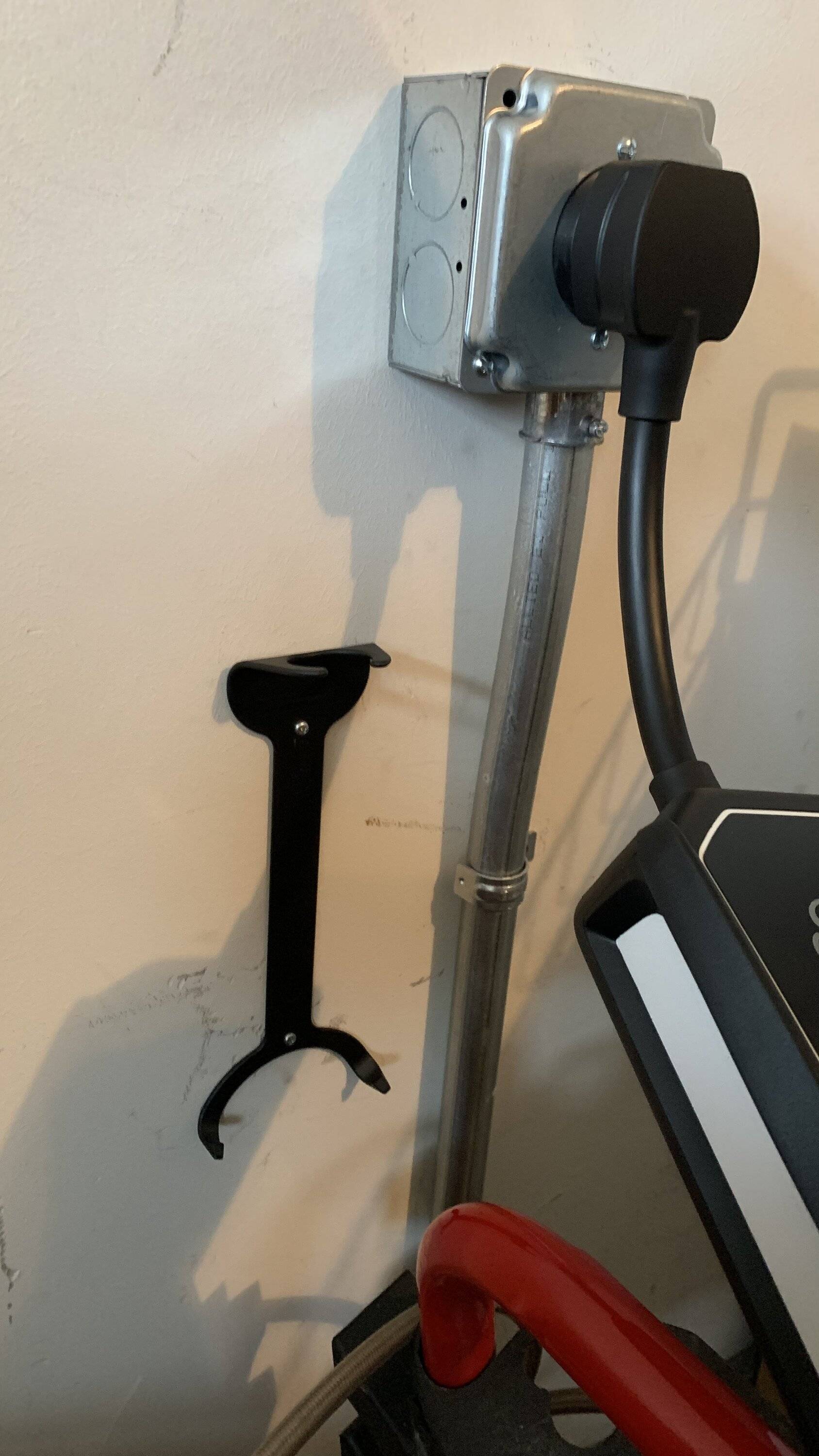

Mounted the bracket on wall but the mobile charger just comes right off when I pull the wire to the car
Currently being held up by my pressure washer to relive downward tension
Not much wiggle room due to the metal conduit in the way
I don’t have any tools to bend the conduit
Any ideas on what I can do to get this to work?
the 'holder' is upside down.... try repositioning it with just a little 'S' in the cord to the outlet.
