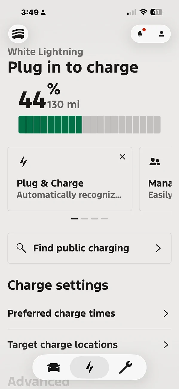

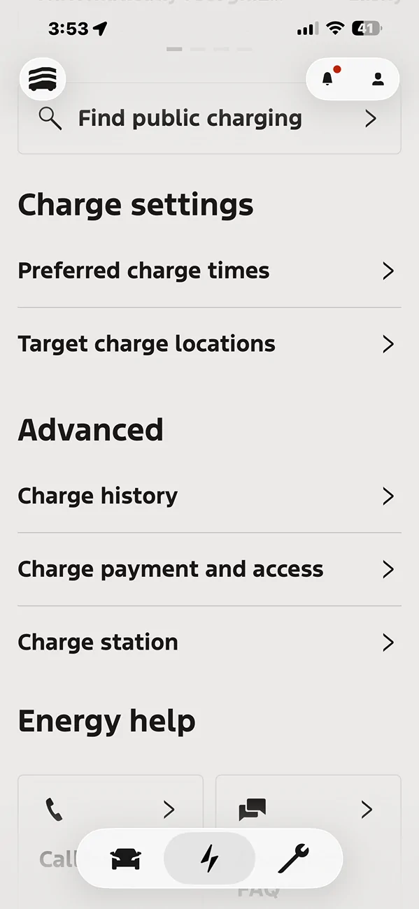

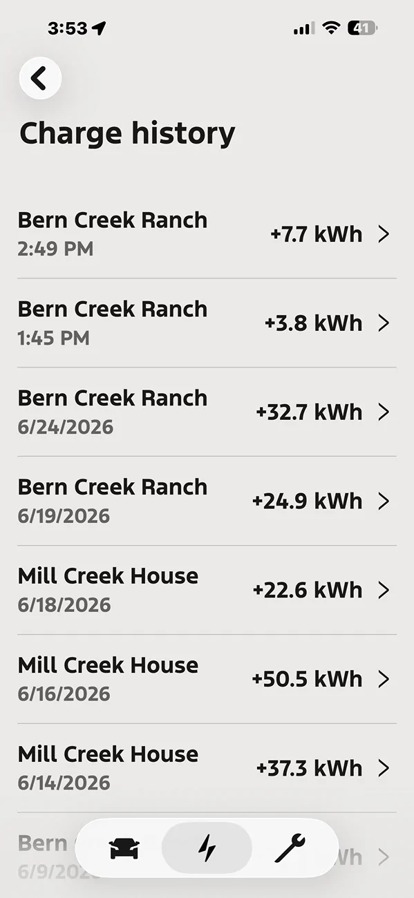

@Kygolfer
You have the details you need on your app, assuming the app reports the same for the MAch-E and Lightning.
Go to the app
Click on the Lightning bolt at the bottom
Under Advanced, click on Charge History
Add up the kWh usage
Multiply the kWh by the kwh rate
Add about 10% for efficiency loss
You can see I used 179 kWhs since 6/14 to replenish my Lightning
My kWh rate is 14 cents/kWh 0.14x179= $25.06 beore charger 10% loss
I drove my Lighting 358 miles since 6/15 at 2.0 mi/kwh so it cost me about 7 cents per mile. I suume your Mach-E will do about 3.0 mi/kwh.
BTW, My Tesla does over 4.1 mi/kwh so it cost 3.5 cents per mile, 1/2 the running cost of my Lightning, Your Mach-E
