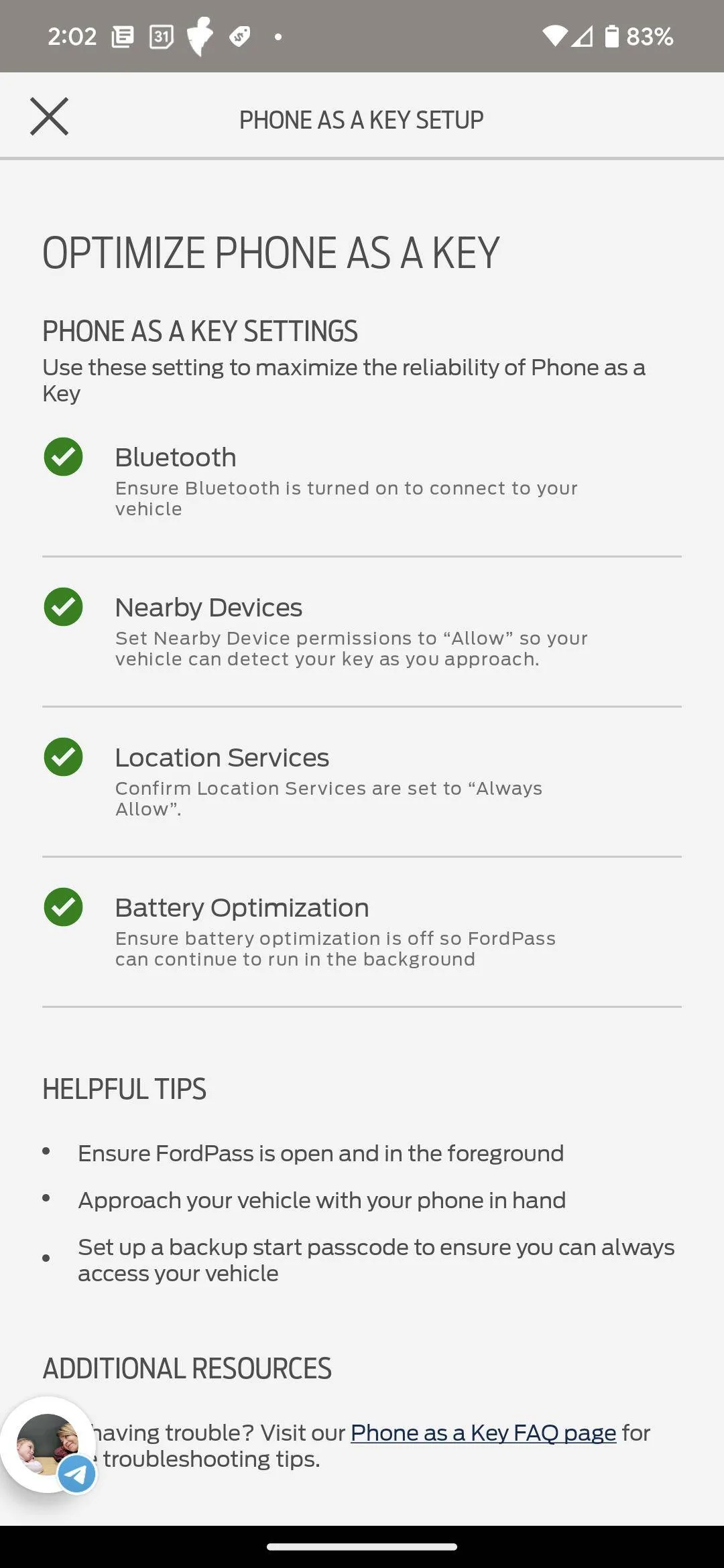

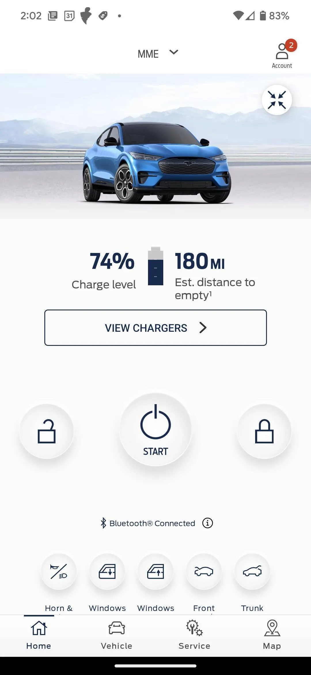

Bluetooth is on, everything is checked in green. Any ideas?

What the problem, looks like it's connected ( basing this on your second pic) as those frunk and trunk icons are live.
Problem is when I near the car with phone in hands it does not unlock automatically I had to use unlock button in the app.
