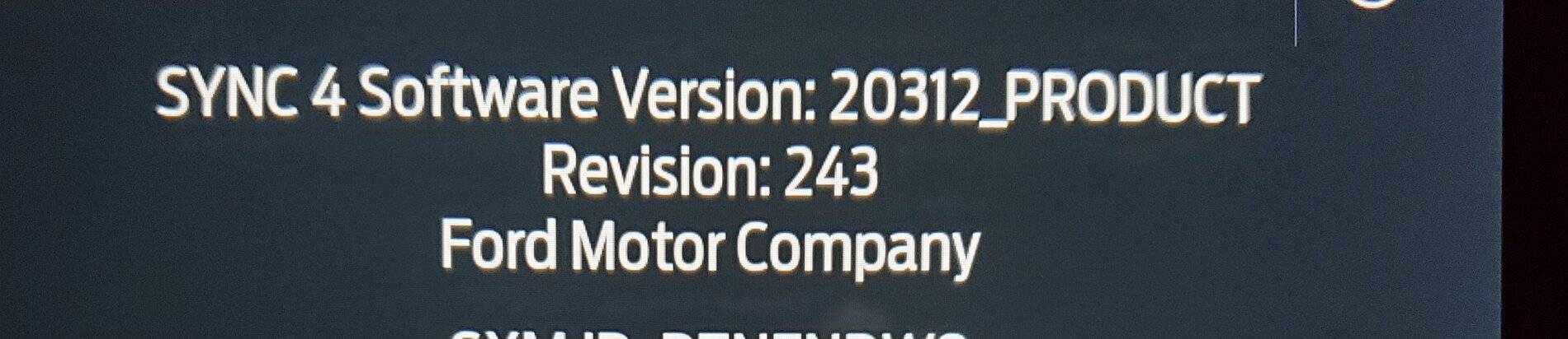

My PAAK is working perfectly so far. I leave my FOB at home. Here is my software version.
that's half the equation perhaps.... what phone, and version of phone OS do you have?
I just checked my sync4 version on MME display > settings>general>about sync , and I also have version 243... apparently all up to date.
I uninstalled, and re-installed FordPass on my phone, removed and re-added my MME vin, and FordPass errors out early in the config process... saying my phone is not capable of PAAK. ... my phone is a Samsung Galaxy j737v (android), with latest update software version j737vvru8bt12

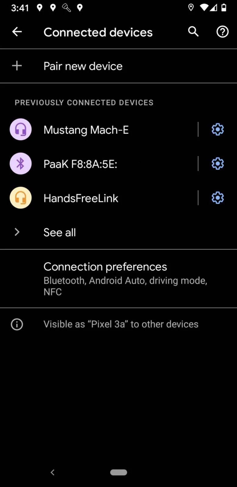

Some tips for phone-as-a-key (PaaK) on Android:
While setting up, I got to a screen where the FordPass app said I'd need to wait one or two minutes for it to finish pairing multiple connections to the car.
It didn't seem like anything was happening. After a long while (though less than two minutes -- I'm not that patient), I noticed there were notifications popping into my status bar.
So I dragged down from the top to see what they were and it was Android 11 waiting for me to confirm Bluetooth pairing requests that were initiated by FordPass.
So I confirmed each of those. It might have been three or four? I can't remember. Then PaaK worked.
Ok. Second tip. The audio/phone/AA connection to the car is called Mustang Mach-E by default. That's fine.
But the PaaK connection is just a string of hexadecimal numbers.
Android lets you rename this. I recommend giving it a better name so that when you inevitably pair with other nameless bluetooth gadgets in the future, you'll be able to tell which is which so you can forget the correct items if you ever need to.
To rename, go to the list of previously connected devices and then tap the settings gear next to the hexadecimal entry for PaaK. Then tap the pencil to rename it.
Ford Mustang Mach-E phone as Key NOT working ?! Screenshot_20210307-154130
HandsFreeLink is my parents' Honda. I'll rename that now, too.
