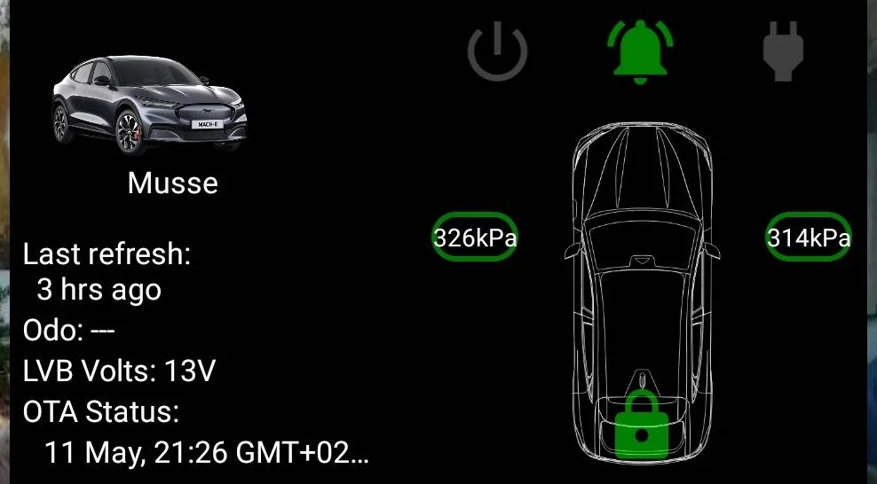

It's possible; the question is how to make it smaller. Shrink everything? Rotate the vehicle image 90 degrees? Remove some information? It's already supposed to hide the left side info when resized below a certain width, but I see it's stopped working and I hadn't noticed so that's back on my to-do list. :confused:
Rotating the vehicle image when the widget height is decreased would be cool. Possibly even remove the tire information (or toggable?) and move the battery bar and range up underneath it?
Right now when you shrink the height, some information is lost and the lock icon is being missplaced.
I'm using a OnePlus Nord 5G with andriod 11 if that matters.
Attaching an image on how it's displayed for me when decreasing the widget height.
Ford Mustang Mach-E Android Widget for Mach-E [Less Complex] Screenshot_20220605-173713
Yeah, shrinking the height will chop off info. Moving the location of the lock icon is... weird.

Right now when you shrink the height, some information is lost and the lock icon is being misplaced.
I was able to reproduce the lock icon being misplaced. It's actually in the correct place; the real problem is the car's image is being shrunk. I believe it's dependent on the launcher respecting the minimum widget height. Pixel Launcher works correctly, but Nova 7 does the same thing you're seeing.[/QUOTE]

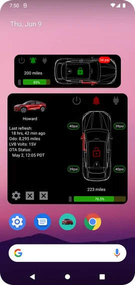

Would it be possible to have an alternative, smaller, widget as the current one takes up too much space (according to my preferences)?
Here's a mock-up of a smaller version of the widget. For reference, Its dimensions are 5w x 1h. Feedback?

Very nice!

Nice small version. I don't know if it's feasable but may I suggest a 2h version similar to this?
Looks awesome! If possible, add "last refresh" somewhere :)
