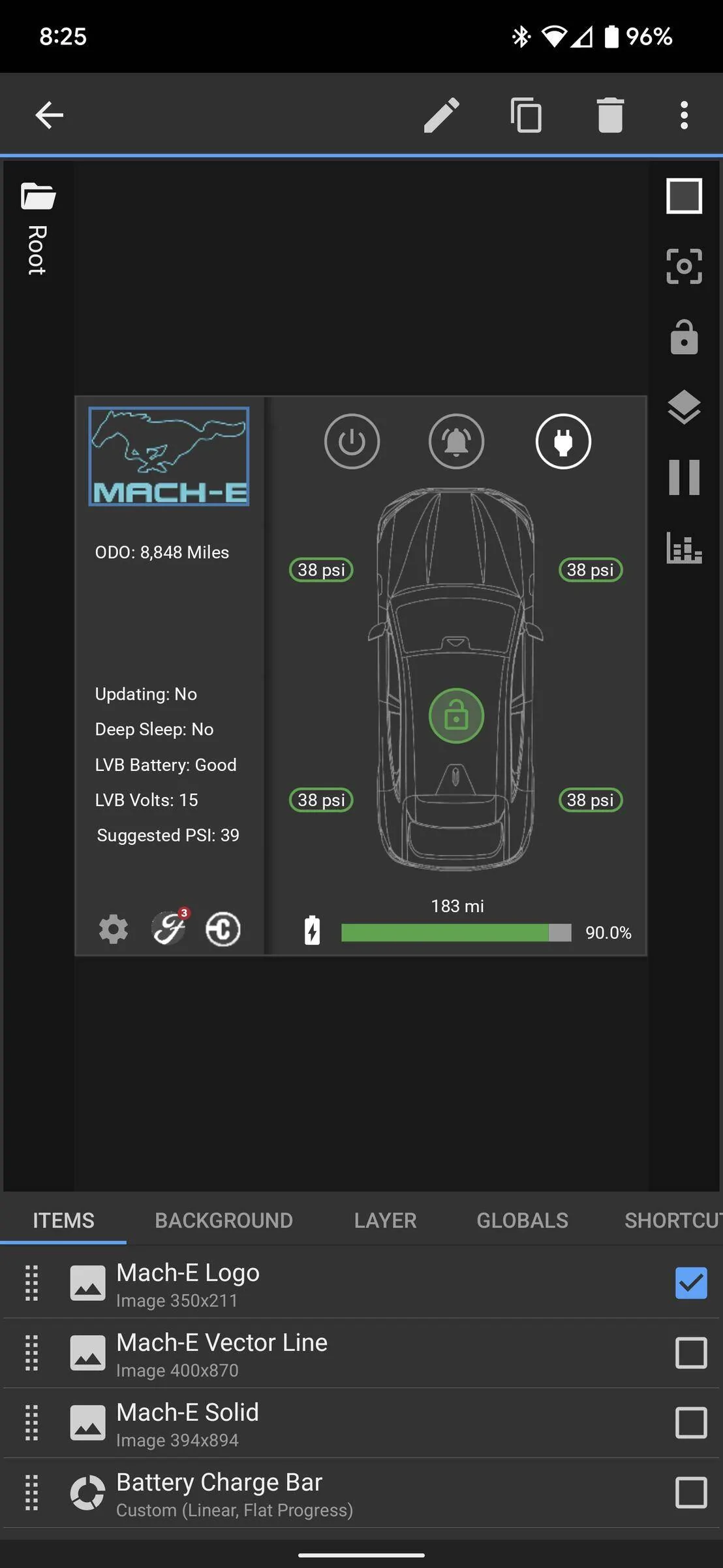

Of course. Just to let you know there's also a less complex Android widget but you are at the mercy of the developer with that one.
With my version it's more complex, but with complexity comes customizability. Anything can be changed by whoever uses it.
As you can see in the below screen shot you can just change out the images:
Ford Mustang Mach-E [Guide] Android MME Widget [More Complex] Screenshot_20220221-082512

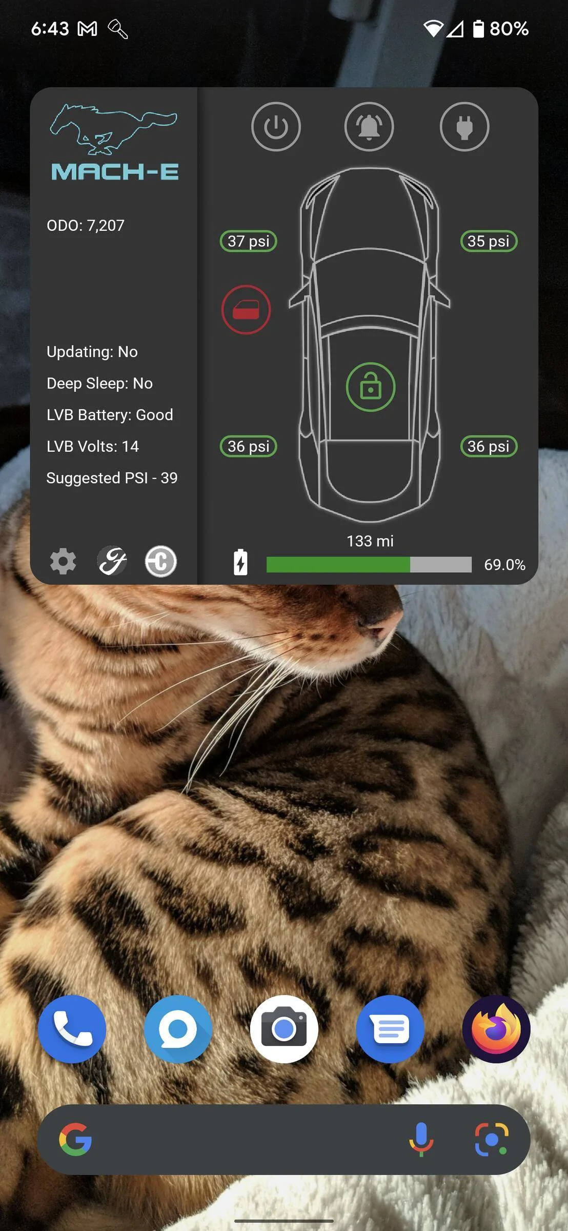

Okay, so I've kept quiet on my little project over here regarding an Android Widget that I've been in the process of developing.
If you are looking for something that is easier check out this post here by @kennelh : https://www.macheforum.com/site/threads/android-widget-for-mach-e.13563/. I believe that the biggest difference is look/feel and the fact that my widget has buttons that command the car to do things just like within FP.
IMPORTANT: Due to the complexity of the widget it's not going to be available for everyone. I wanted something that was very functional and informative and to accomplish that I used a number of different things including listeners for event changes, pushing notifications from the listeners to the phone, the phone intercepting these events and then performing queries of the data which populates the widget. I also wanted something that I can style infinite ways and this gives me, and anyone else, that ability. Once setup you can customize it easily in the GUI to however you'd like.
So to go along with this there's a poll. I want to see if there's interest out there for some of the more technically inclined folks for me to publish a "how to" on this. Edit: guide was posted below.
ON TO THE WIDGET:

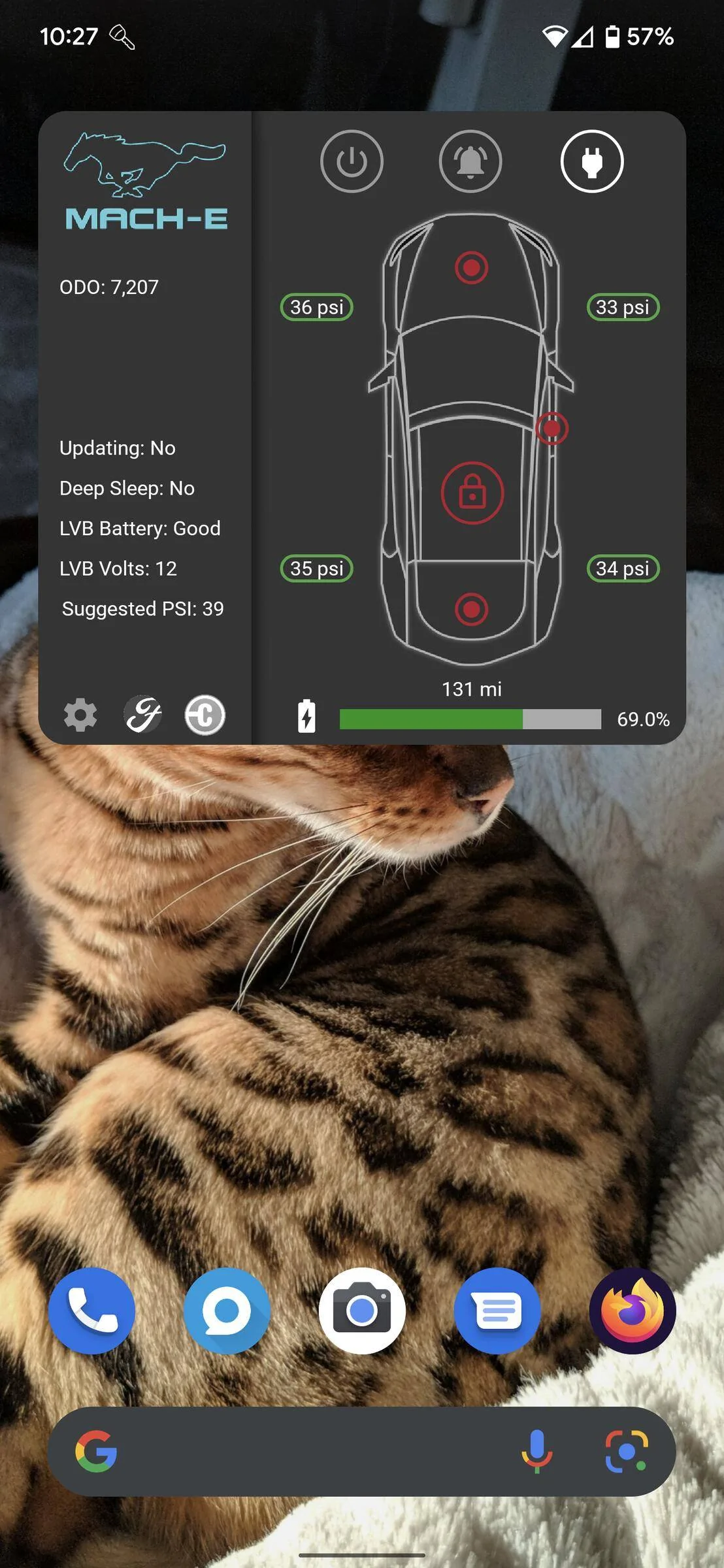

All of the data is in real time.
  • If a door, window, trunk or frunk is open the app will alert as shown below in the area where said object is open.
  • If the tire pressure falls below the limit the circles will turn red.
  • When the car is turned on the power button changes to blue. This button also serves as a remote start.
  • If the alarm is set, it turns green, of alarm is sounding it turns red.
  • When doors are locked it turns red. This button also serves as a door lock/unlock button
  • The FP Icon opens FordPass
  • The ChargePoint Icon opens ChargePoint
  • The charge button is grey for unplugged, white for plugged in, blue for charging.
  • Touching the Mach-E logo will force a refresh of HA from Ford, which will in turn update the widget if changes are available.
Examples:
Unlocked vehicle, passenger window open, not charging, not on
Charger plugged in (not actively charging, frunk open, tailgate open, passenger door open, all windows closed.

  1. Unzip the attached file.
  2. Create a 4x4 Widget using KWGT and resize the widget to be a square that takes the top half of the screen. NOTE: I have not tested this on different size devices. I am using a 5x5 app grid which isn't standard. But everything can be configured for your device.
  3. Click on the widget to go into the settings. Import the below file that was extracted from the zip.
  4. Profit

KWGT Modifications:
You should be able to look around and see how I coded things to work. Anywhere you see a little calculator icon is where there's custom code controlling the behavior of that object. Most of the time this is in the colors and visibility of layers.
Buttons to control actionable events are created as layers. Thus, for example, if the vehicle is locked then display the locked icon with a button action of unlock. In this example the layer is only present if the conditions are met. This allows the button to be able to switch between lock and unlock since lock actions in HA don't have toggle properties. Same goes for remote start.
There's other areas where I changed words because the returned results are not so pretty. You can easily modify all of this as you wish.
For the battery gradient, it goes from green > 50%, Orange > 30% and Red below that. If you go into the color calculator you'll see the formula I used for that, you can change those ratios or colors as you wish.
Have fun!
