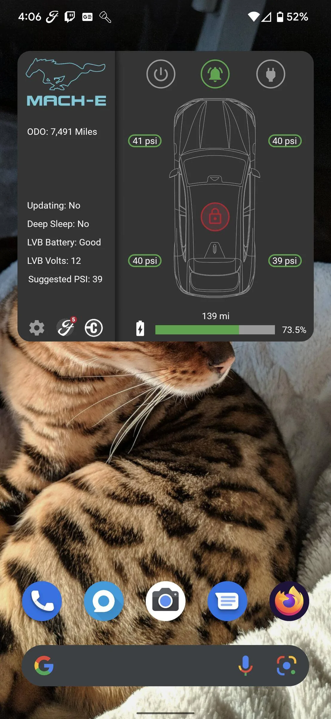

So let me explain a few things. The reason I originally did this was because I, and many others, can't stand the fact that we CAN NOT check FP to see if the car is locked. This was the main inspiration and I actually used a very, very simple way of doing this for months by using a default HA widget. It was that easy, no code required, but easy is boring!
Second, the way I've written the code is very easy for anyone to customize so therefore if they only want 2 data points they can remove the rest.
Third, my way of doing this opens up a word of possibilities. Here's a couple examples:
  • Notification if there's a window down when rain/snow is in the forecast
  • Notification if a door is left open for xx minutes
  • Notification if the doors are left unlocked after being closed for 10 minutes
  • Any number of notifications based on location etc for someone who has a child driving the vehicle.
I have a number of guides on here, from dashcam installs to LVB battery access to widgets. I prefer to find solutions to problems instead of complaining about them. So for me and many others developing things like this is fun and personally I can't wait to see what people do with my ideas and how they build upon them.

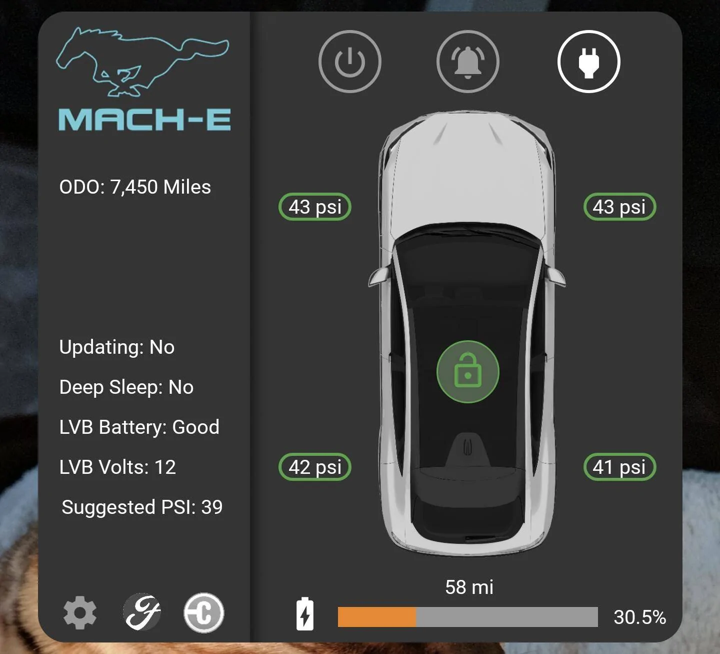

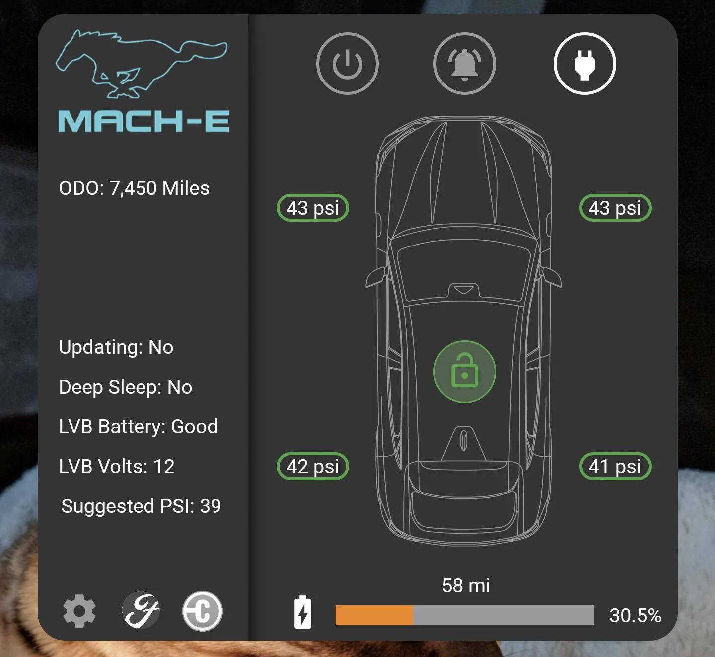

I've made a couple tweaks to the widget to reflect the actual image of the MME. In this version you can pick the vector line art or the solid art.
I'll be updating the file with these changes after I make a few other modifications in my to-do list.

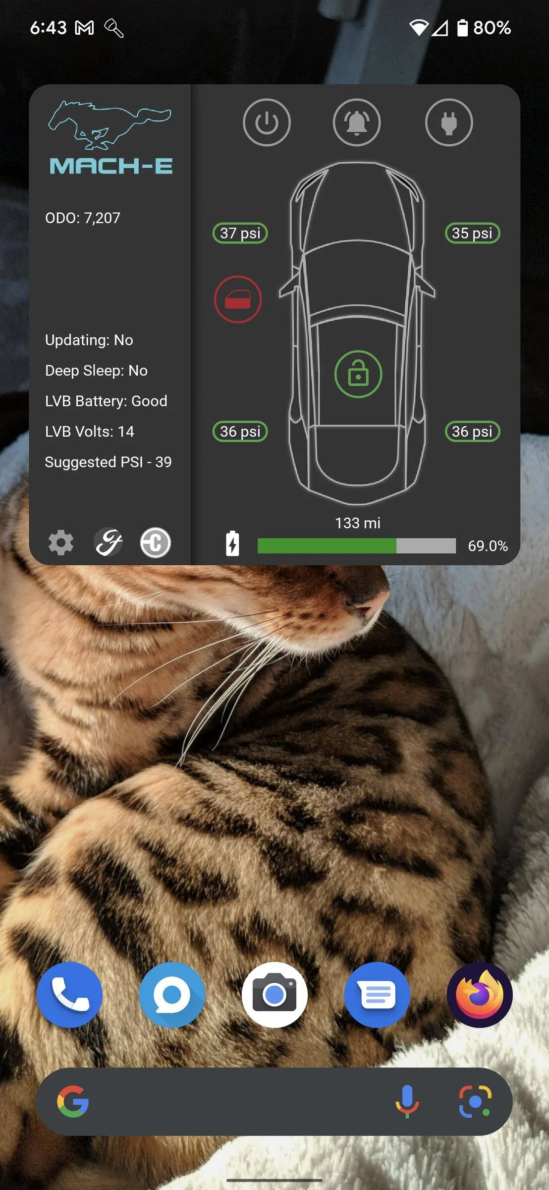

For anyone monitoring this thread I've updated the MME Tasker Tasks and added 8 more tasks. I've fixed a few minor issues, updated the chargepoint icon to more visually match (which you can change to any app on your phone or remove completely), added the badge count, added charge notifications, added the ability to click on the mach-e logo to force HA to pull a refresh from the vehicle, fixed colors and made red/green circles easier to see. Lastly, I've updated the vehicle images.
All of the files on the main post are updated and there's a new task for Tasker to perform the HA refresh. I've also included another automation example for those who want to query the vehicle every 30 (or whatever interval) minutes.

I had to purchase them. They are CAD drawings that I converted into SVGs.
