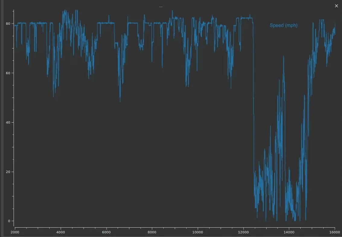

The graph below is for 233 minutes of travel (Almost 4 full hours)
Travel Speed (I was moving pretty darned fast, speed limit is 75mph for a good portion of this leg):
Ford Mustang Mach-E Any Comma.ai OpenPilot users here? Speed

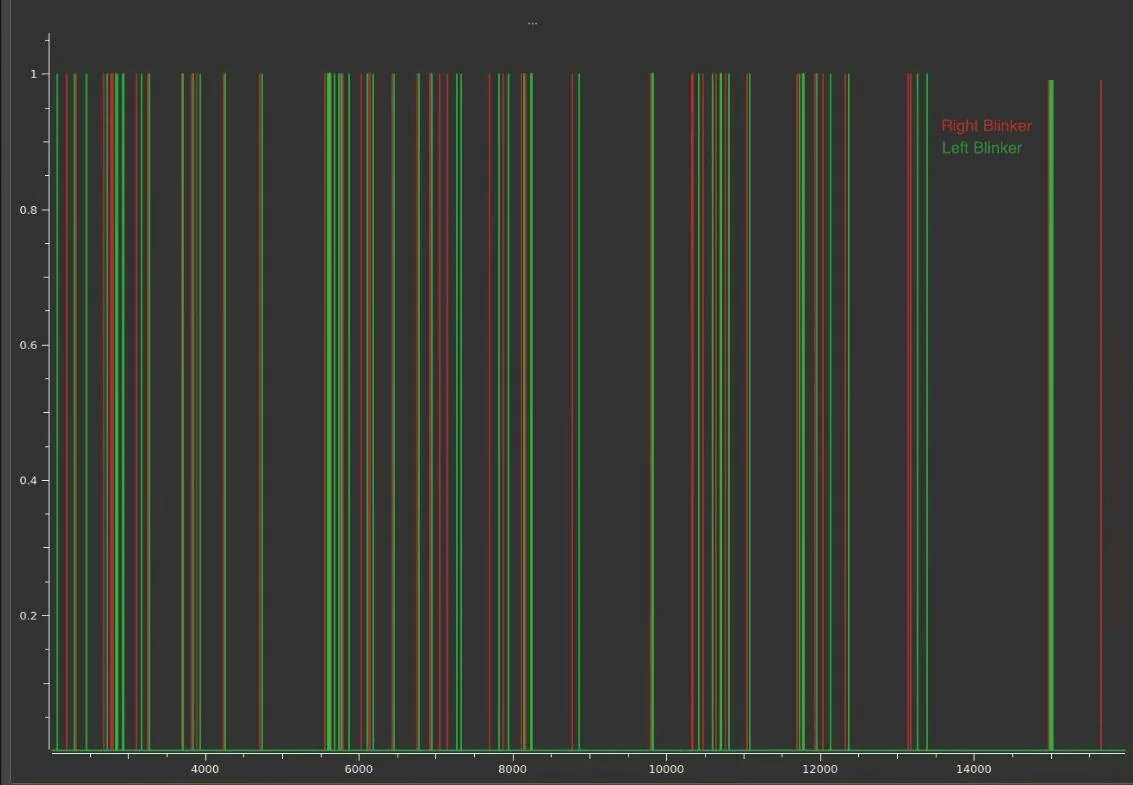

Blinker Status (You can't move that fast and camp out in the right lane, I had to change lanes a bunch):
Ford Mustang Mach-E Any Comma.ai OpenPilot users here? Blinker

Some statistics:
  • Number of wheel touches: 13, coming in bunches.
    • First group: Aggressive driving to get around two nimrods racing at 55 mph in the left two lanes (75mph zone)
    • Second group: Construction zone with very aggressive lane shifts. The old lane markings not being erased and new lane markings dropped right on top of them. There was also a touch or two in this group related to passing an 18 wheeler that was swaying, and there were no shoulders on left or right
    • Third group (only 1 touch): Had to quickly brake (disables open pilot for me) and let an 18 wheeler into the left lane due to a trooper writing a ticket on the right shoulder
    • Fourth group: Crossing the Mississippi River and navigating the I-10 / I-110 exchange. 15 years of crossing this bridge has taught me that 97% of the drivers in Baton Rouge lack the intelligence to pull this off. I wasn't even going to let OP try, not at 5:06 in the afternoon.
  • Total time touching wheel: 153 seconds out of 13,980 seconds of driving (1.09% of the drive my hands were on the wheel)
  • Longest time between touches: 96 minutes
Just wanted to get this out there so someone who is coming along new doesn't get overwhelmed with all of the experimental features being talked about and think this might not be for them, when all they really want is what they expected when they plopped down the coin for a blue cruise capable truck.
