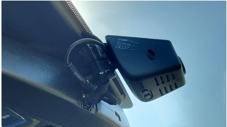

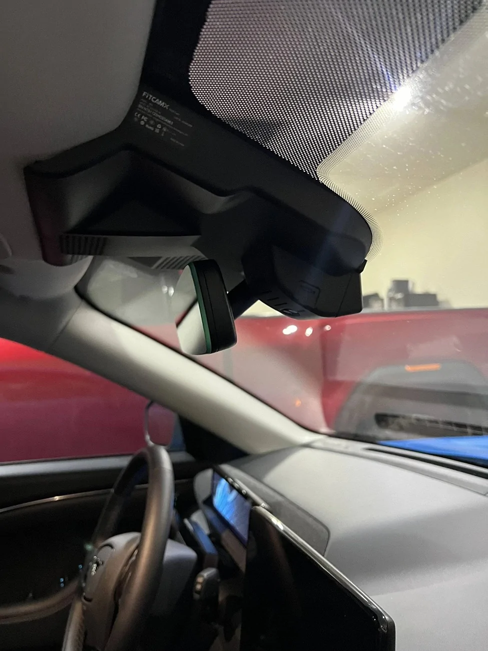

It looks like the FCX implementation differs between the models. The Mach-E version comes with an entire replacement cowl for the mirror (picture below):
Ford Mustang Mach-E Installing Comma.ai / OpenPilot (BlueCruise alternative) Mach-e FCX
Whereas the F150 version looks like a standalone unit:
Ford Mustang Mach-E Installing Comma.ai / OpenPilot (BlueCruise alternative) Screenshot 2026-03-19 092339
I guess the adjustment wouldn't be needed? I'm thinking I would just have the C4 dock sit lower/centered so that the C4 can function without obstructing the FCX field of view too much. Just trying to cover my bases before I place orders for my C4 and your dock.

if you dont Mind the C4 being lowered it will work.

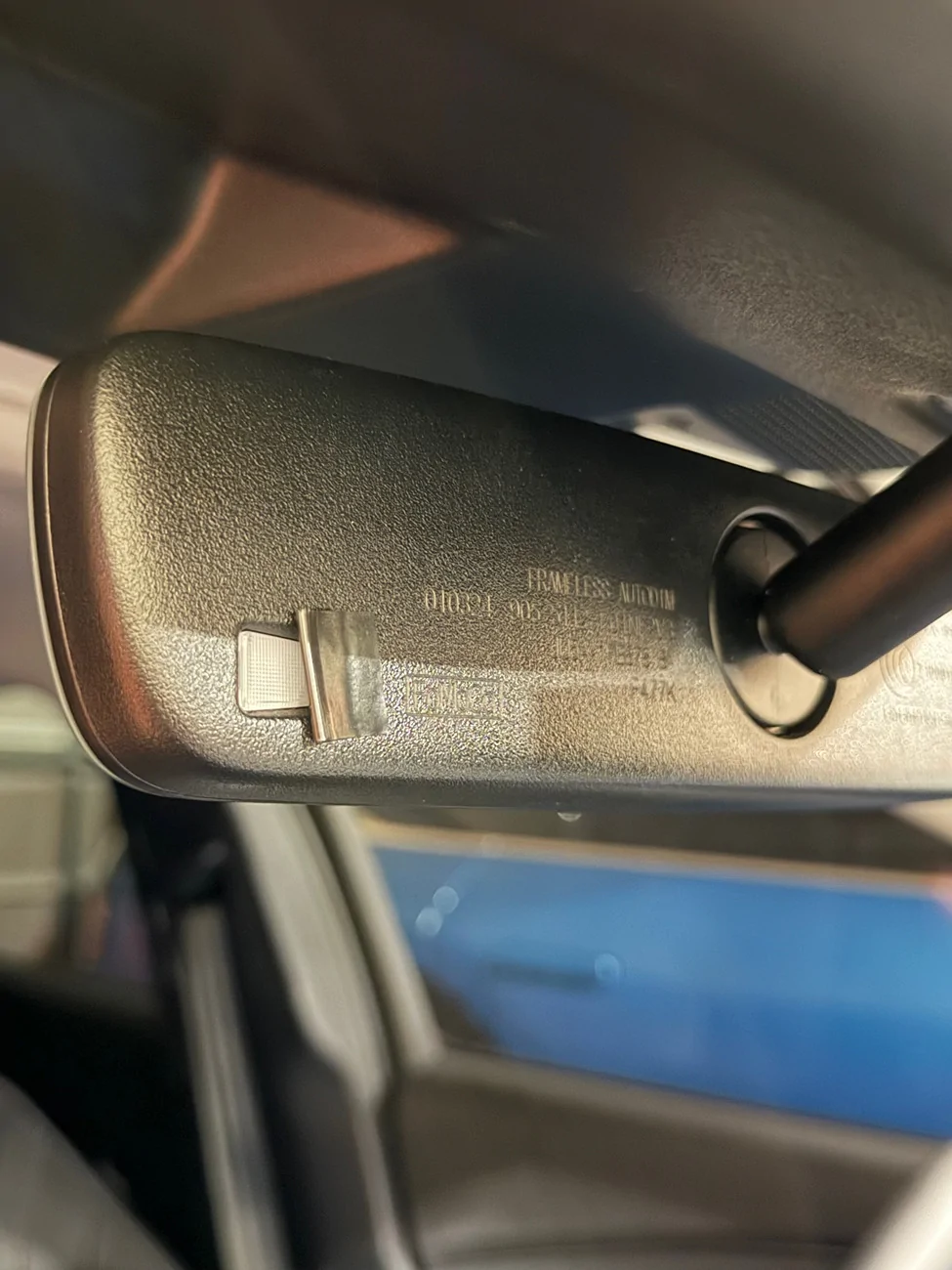

It was definitely the comma causing the issue, as soon as I unplugged it the mirror started dimming again. I also drive in very pitch black areas where there is 0 lighting on the roads so I don't know if that plays into it at all.
I will have to try to rig something up with my printer, thanks.
Have you found any relief for the auto-dimming mirror issue? I have the C4 mounted so that the screen is positioned right below my mirror to minimize the visibility impact, but I also have the auto-dimming issue now. I haven't played with it a lot, but noticed that covering the C4 completely with my hand doesn't seem to affect it.
I stuck a piece of electrical tape over part of the light sensor on the back of the mirror, the half that faces the comma. I have not had any issues with it not auto dimming ever since.

Sweet! I will give that a shot, thanks!
