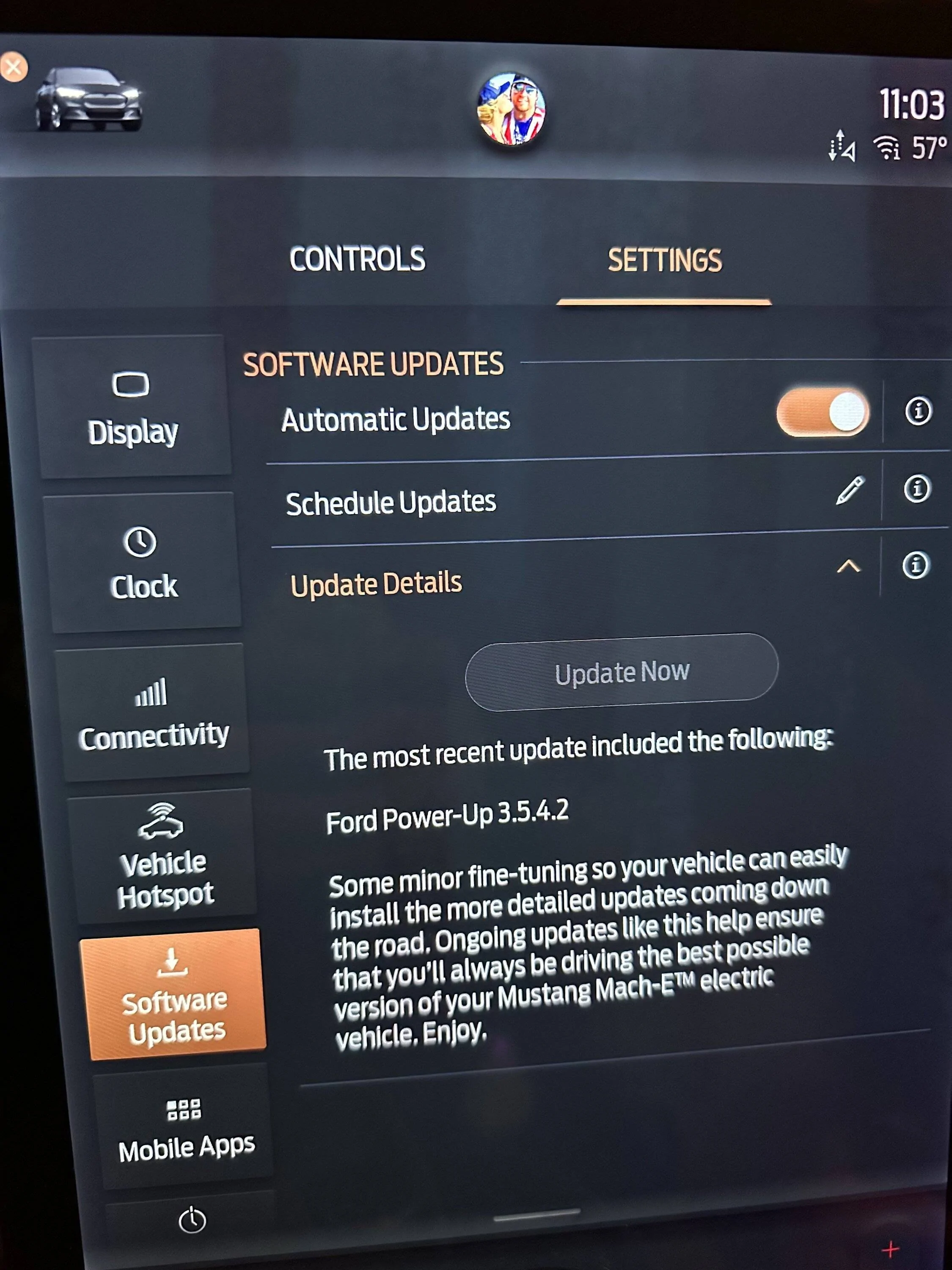

On a separate thread, @Mach-Lee noted that my OTA updates were behind. I checked the car and the most recent update installed was 3.5.4.2. However, 3.6.1 was released in October, and 3.6.2 was released in December. The UI to view these updates is limited, and simply says everything is up to date, with no way to force updates, or even see that there are more.
Anyone had this issue and/or know how to get these updates to run?

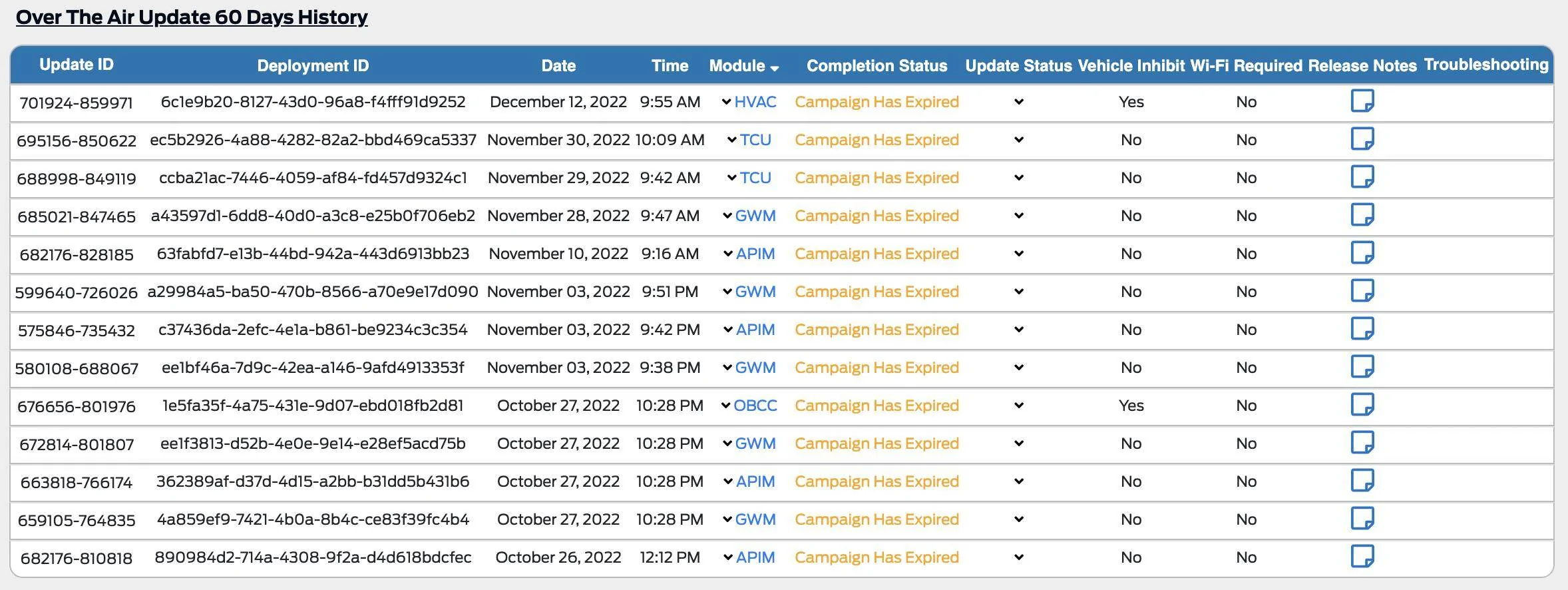

Yes there was an issue here with OTAs not installing:
Ford Mustang Mach-E OTA updates not installing? Screen Shot 2022-12-15 at 2.55.04 AM
They did the HVAC update (3.6.1) manually and repaired your APIM successfully on Dec 6th. The next day they updated your powertrain modules (3.6.2), gear shift module, and wireless charger. However I don't see another attempt at an APIM update after the recovery procedure? Do you have an A/C button below the AUTO button in the climate controls?

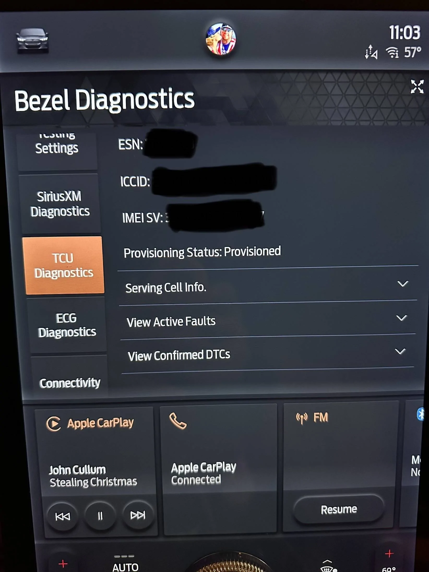

The other thing I would check is if your TCU is provisioned, follow the directions here to check: https://www.macheforum.com/site/threads/ssm-51228-inoperative-fordpass-remote-features.23858/
I'm still not sure if things are fixed 100%, you don't have any OTAs pending currently but you can see if the next one installs or not.

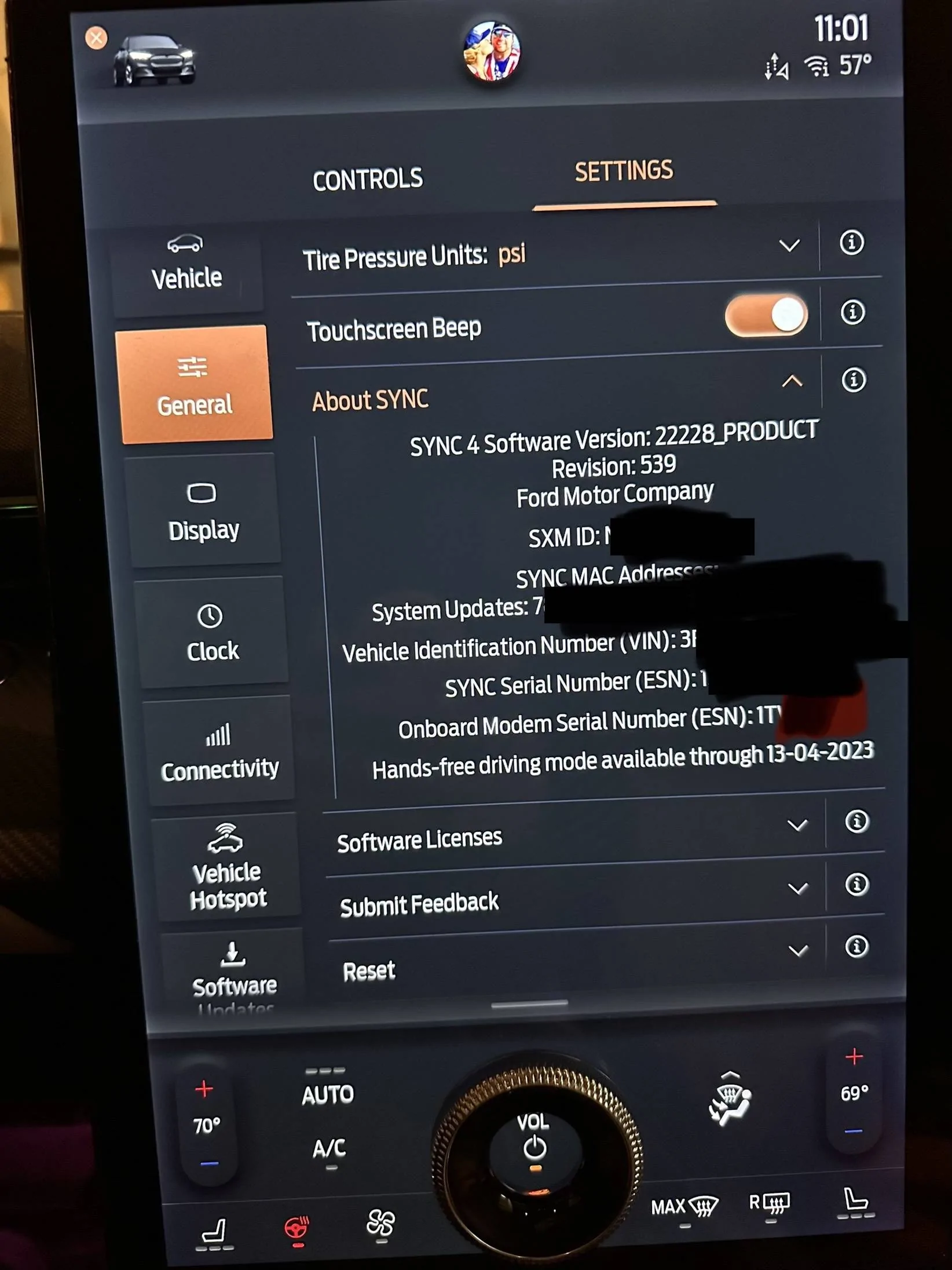

Thanks @Mach-Lee - appreciate the reply! Attached a few screenshots.
1. A/C button is below the AUTO button
2. About -> Sync does show a modem serial number
3. Bezel diagnostics shows provisioning status of "Provisioned"
I guess that means the car is ok, just not taking or doesn't need the updates?
Yeah that all looks good so maybe it’s fixed.

How do you get to diagnostics screens?
Go to the Radio app where you can see the stations etc on the SYNC screen. Then hold down the steering wheel buttons for previous track and volume down for about 10 seconds.
