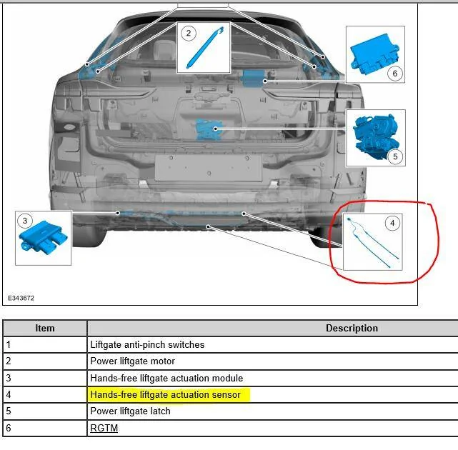

Ran across this today. Check out where the sensors are.
If you are having trouble getting the power liftgate to open, make sure you are sticking your foot into this area where the antennas are located.
