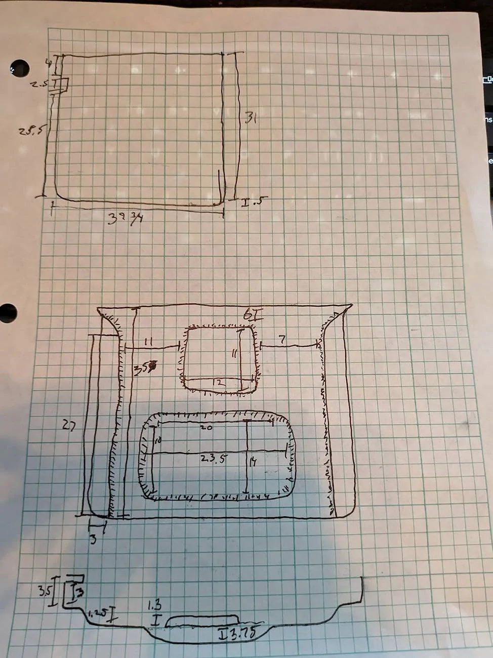

Nice custom build! Do you know what the max width and length a box can be in that space?
These measurements were a draft, not quite perfect but should get you close enough. The first measurement is the floor in upper position, the left 2.5" is where the floor sits nearest the back seats. Second measurements of the bottom showing dip and raise with hash marks. Final measurements are a front view as if you chopped off the bumper. Unsure if this is significantly different for ER battery models.

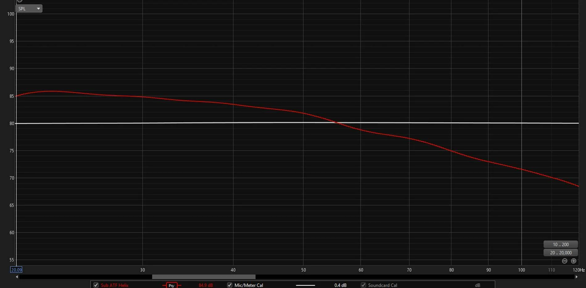

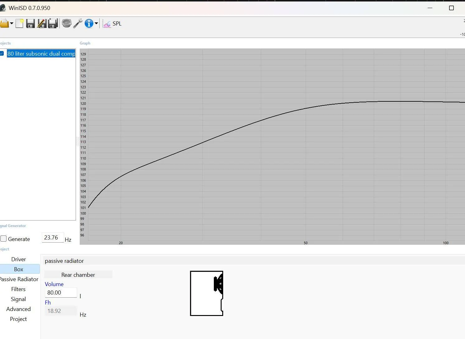

WinISD is my go to for box modeling - . You can load in all the sub parameters and then figure out how changing parameters (IE box volume, sealed vs ported, etc) will play out. You'll get pretty significant cabin gain between 20-50hz by having the sub in the trunk under the floor. You can get WinISD to model this, but by default it's going to show you what the sub would do in an open field.
IE the predicted measurement for my setup-
Ford Mustang Mach-E Anyone build a custom down fire sub box 1737747657287-bg
Vs the actual measurement-
Ford Mustang Mach-E Anyone build a custom down fire sub box 1737747715675-gd

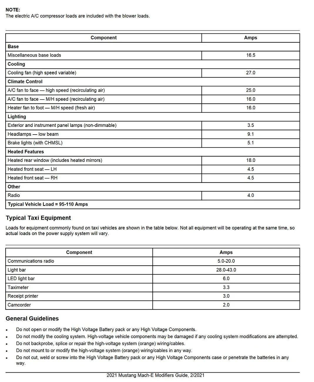

Thank you @iexiak for the response and sharing your details! Good point about just turning it down and with the price difference is like $30, it's kind of a no-brainer. I wasn't sure if I should worry about 50 amps vs 30 amps on the Mach-E, so that's why I thought about going lower power.
That's an interesting sub. I picked up a Hertz MPS 300 S2 (2 ohm) which is rated at 500W RMS so I'm looking at 2 ohm amps.
You are welcome! I'm running close to 2000W RMS of equipment with no issues so far, though I kinda expect to need to replace the 12v sooner rather than later haha. Once it warms up I'm installing a voltage monitor just to be safe.
I based the 'safe' voltage off a handful of threads in this forum that indicate we should have at least 160 amps available, and then this manual on converting a Mach-e to a taxi on just how much overhead we actually have
https://www.macheforum.com/site/threads/12v-battery-faq.32744/
