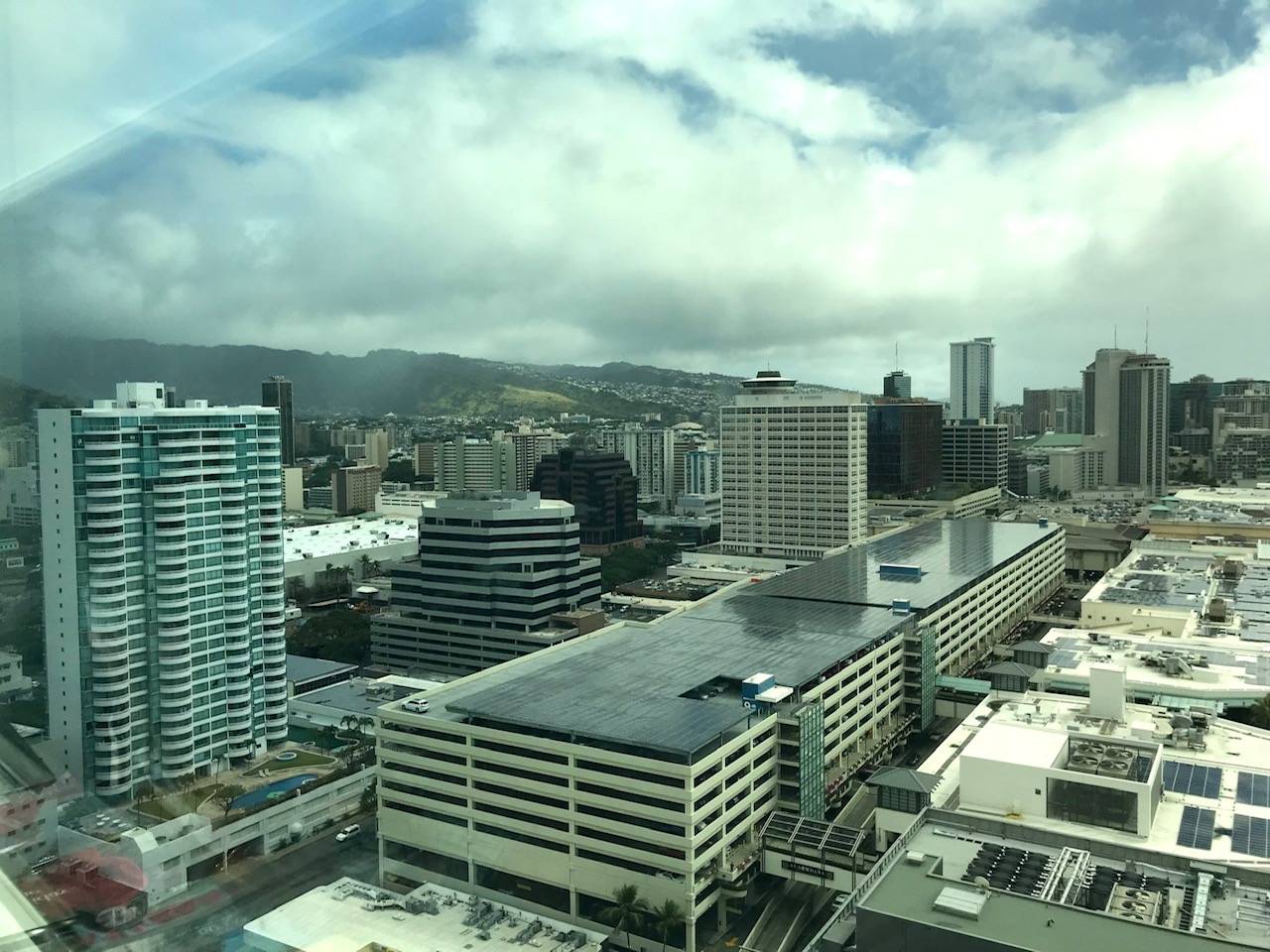

View out to the solar roof across the street. Wonder why not more places have these types of setup. And if they offer customers free/cheap charging, its a win/win for everyone.

the spouse working for a company that has a 17 MW solar roof array so she ends up doing most of the charging there
That would be the more efficient use of solar for BEVs - charging during the daylight. Nighttime charging (which most people need to do, at home) requires time-shifting, that adds cost. Typically by relying on the power company to time-shift (which can be problematic with duck curve demand), or with storage (that's expensive).
Well, probably not for everyone, since someone has to pay for the hefty purchase and installation expenses (and ongoing maintenance). And make up for tax subsidies. Whether that's a "win" depends on how it all compares to power company rates.
In the case of the locale where that picture was taken, the base electrical rates are stunningly high. Almost as high as mine.
