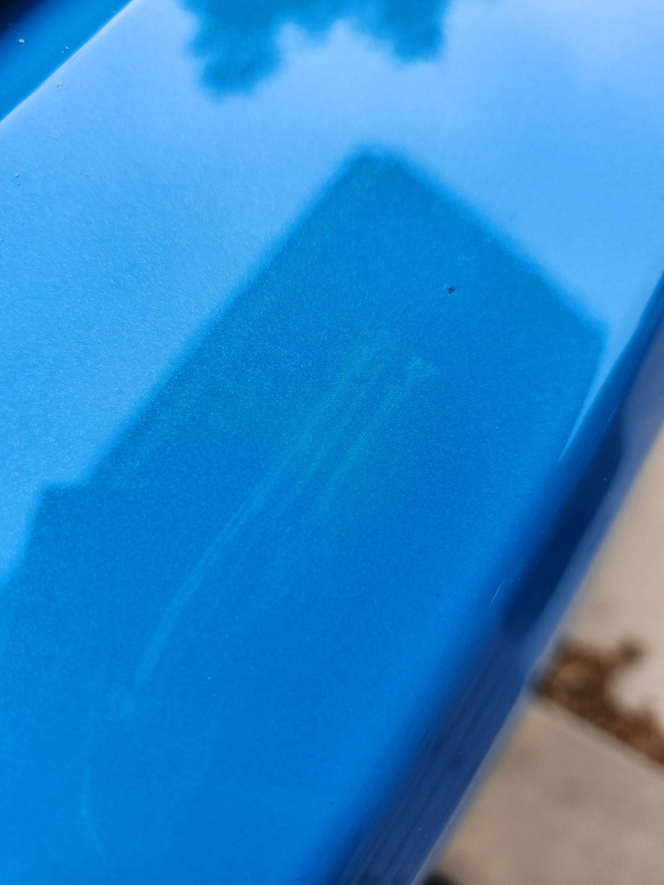

The edge on mine was starting to come loose so I decided to remove the spoiler. I used a heat gun, generous amounts of isopropyl alcohol, and patience (to let the alcohol soak through). Only got a small chip and some slight marring after taking it off.
Have you tried Dr. Colorchip? I've had good luck with it in the past but that was with black.
Ford Mustang Mach-E AOSK rear spoiler warning!!! 20230314_163713
