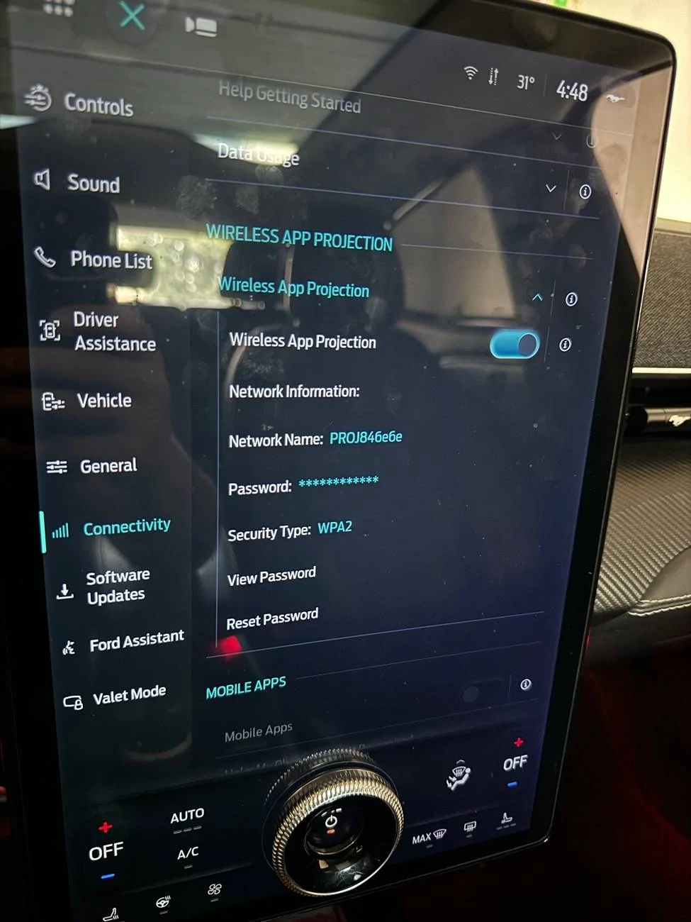

Remember that CarPlay syncs first by WiFi. Make sure WiFi turned on the phone then attach with your wifi

I found what the problem was! This network connected to the phone glitched, I reset the password, deleted this network from the phone and reconnected it and everything worked!
This saved me. Thank you!
