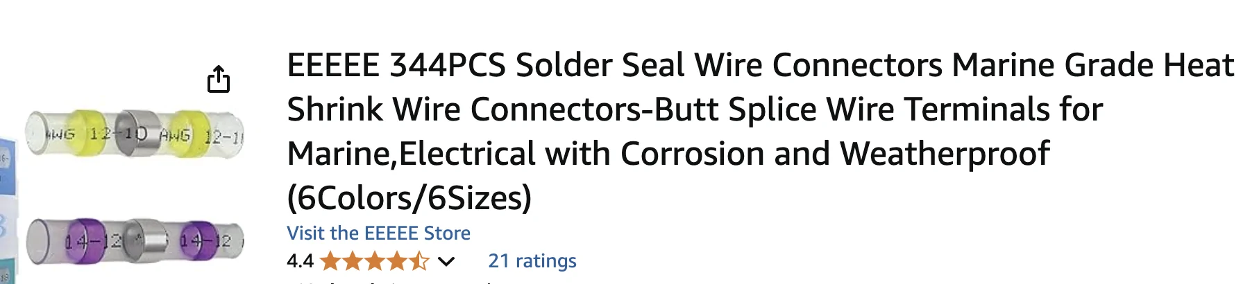

In lieu of soldering which is the most reliable, use a weather proof crimp connectors to avoid intermittent connections in a car that moves, shakes, rattles, and is exposed to the outside elements.
I recently purchased a set of Solder Seal connectors (maybe this exact set). These things are magical! Super handy to have on-hand for car repairs like this.
