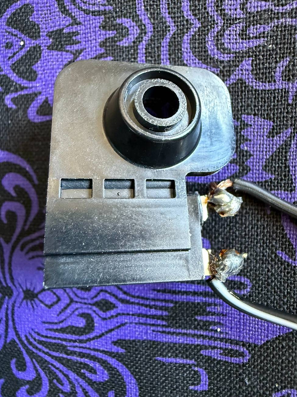

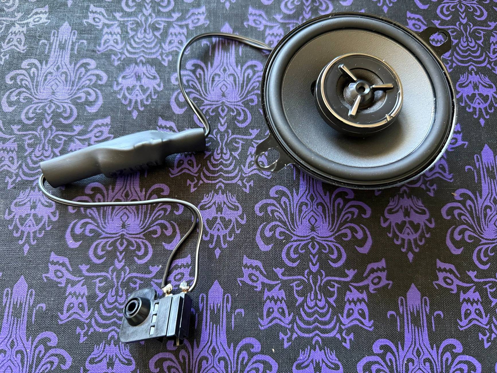

I did the center speaker mod using Kenwood eXcelon KFC-X3C, but hit a snag.
Running my DTC check, I am always getting a `B1A02:13-0B` circuit short error. Speaker is working when I attach speaker wires from a different receiver outside of the car. But when installed it's much lower volume in comparison to the other speaker volumes.
Is there anything else I should via settings or otherwise, or is this truly a valid error?

Lose the crossover. It’s already receiving a proper signal.
That is correct. If you are just replacing the center speaker and connecting it with the stock speaker wires, then you do NOT use the crossover module that comes with the Kenwood speakers.

Installed and still getting B1A02:13-0B.
But a wrinkle: One of the contacts in the plastic adapter slipped out while I was soldering, but was able to get it back. I'm getting radio audio just fine, but the system based audio is not happening through that speaker at all.
Any thoughts?

I see the black tube crossover network that comes with the Kenwood speaker, but what is the plastic piece with circular nub that you have soldered to the end? That doesn't look like anything I saw in my installation. If the speaker plays when attached to another source and doesn't play at all when attached the car's front end, you may have shorted out the center channel when doing your initial installation. More likely, you have a poor connection to the center channel plus and minus wires coming from car system. Switch the system from stereo to surround a few times to make sure it is not playing at all.

Sorry for the false alarm! I'm clear of DTCs now.
Having the car off for about 30 minutes and then testing again solved everything, including system beeps from touching SYNC buttons. Lesson learned!
