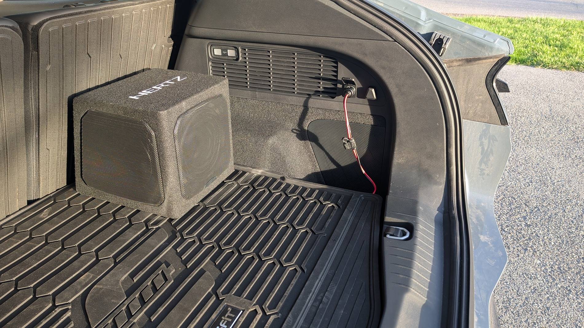

Great to hear that the speaker arrived and you had no problems with the install. I have a big smile from reading that you too are a Surround mode convert with the Kenwood center channel. I'm loving it and can't go back to stereo. Today I finished my subwoofer installation. I used the Hertz DBA 201 which is a very compact box with a built in Class D amplifier. It has one active 8" driver and two passive 8" drivers. It's current draw is very low, so I was able to power it with the 12v accessory plug in the back deck. I have a wide velcro strip on the bottom and on the rubber mat, so it stays put, but can easily be unplugged and moved if I need the space. I'm quite satisfied with the sound.

Thanks for the info! Looking into subwoofers now. Nothing too crazy. It’s a lease so keeping mods to a minimum.
Mine is also a lease. That is partly why I went the Hertz sub route. I got the connector for the stock subwoofer from Mark Boris and used it to connect the new sub. I can easily reconnect the stock sub to return it to stock. Same thing with using the 12v accessory plug for power.

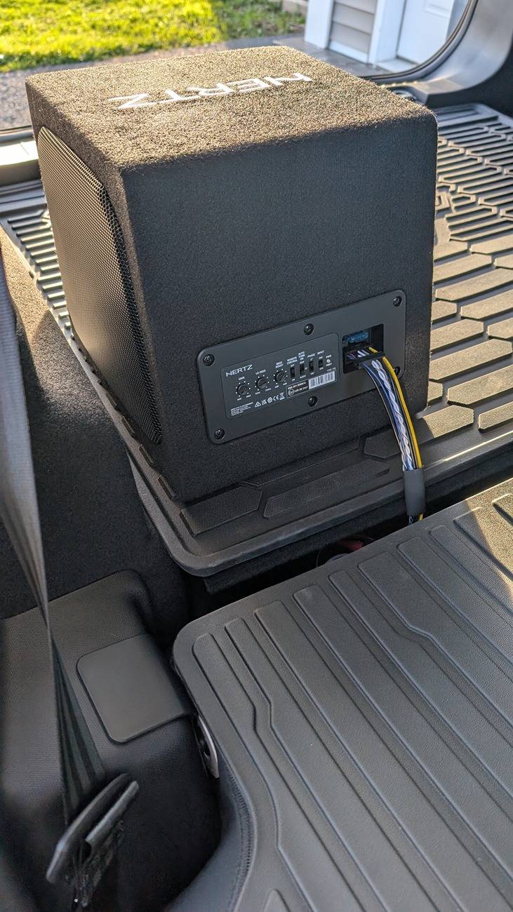

I used this 14 gauge one from Amazon. I just cut and stripped the non- business end and attached it to my sub's harness.
