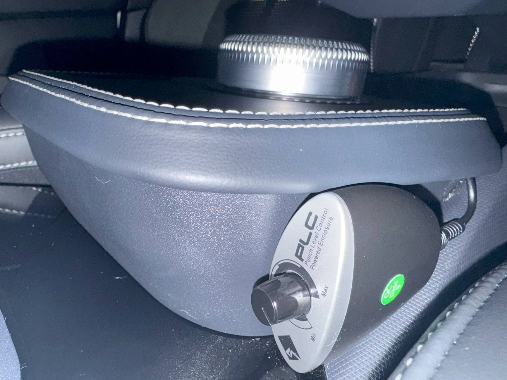

I secured the remote knob to the console using a bit of Gorilla Putty (it seems to do a good job of staying stuck until you want to be unstuck, then it's entirely removable without trace).

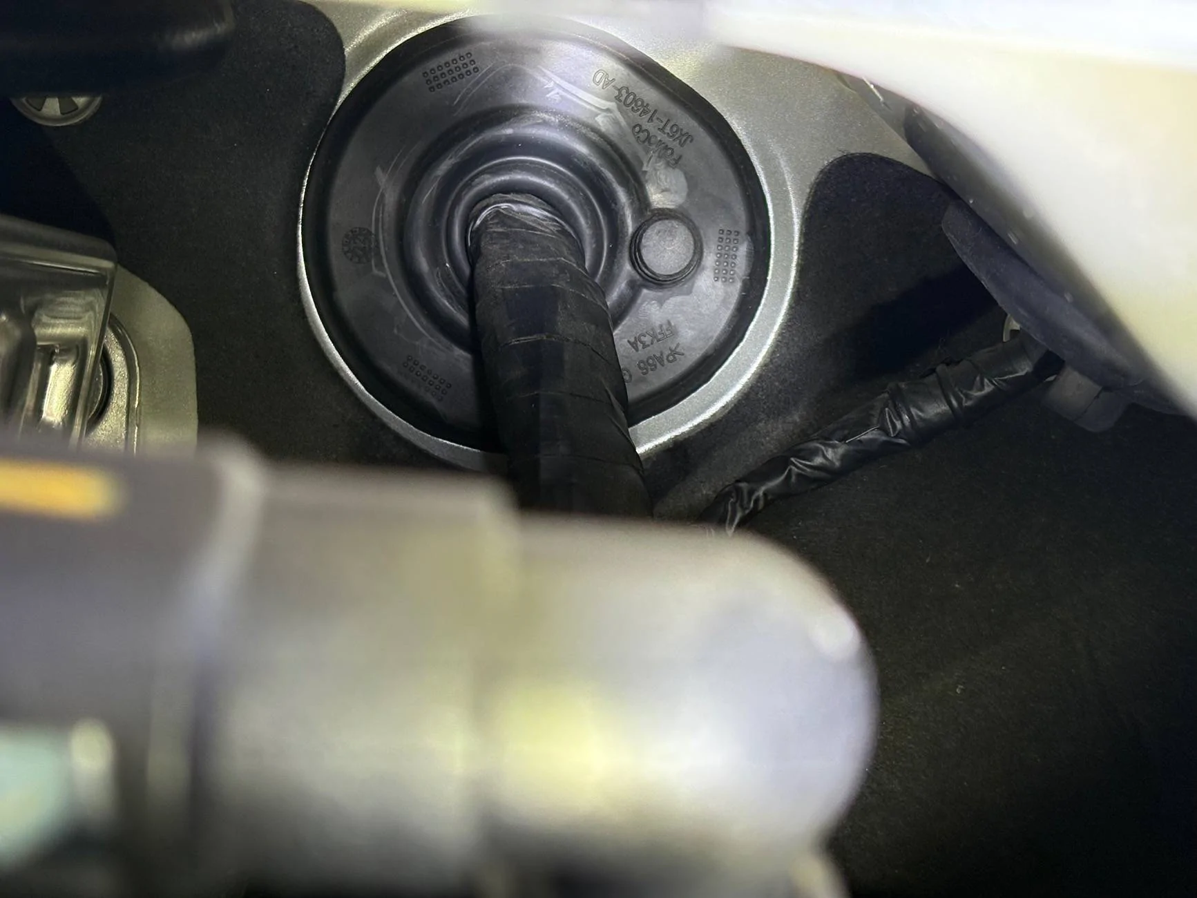

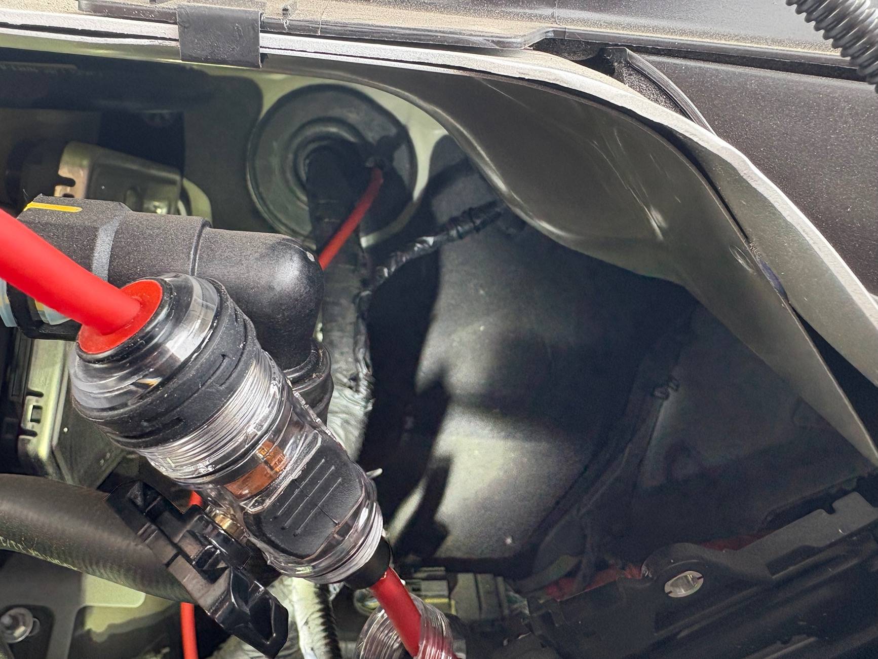

It’s finally warm out and I’m going to start with the sub install!!
@markboris from your picture it looks like you ran the wire though a hole in the firewall. I have a nub there. Did you just cut that off?

I cut a slit in the nub to pass the wire trough.

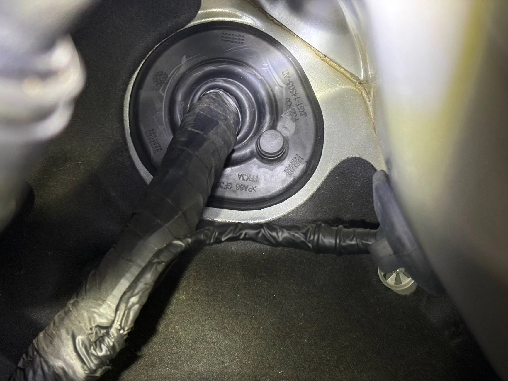

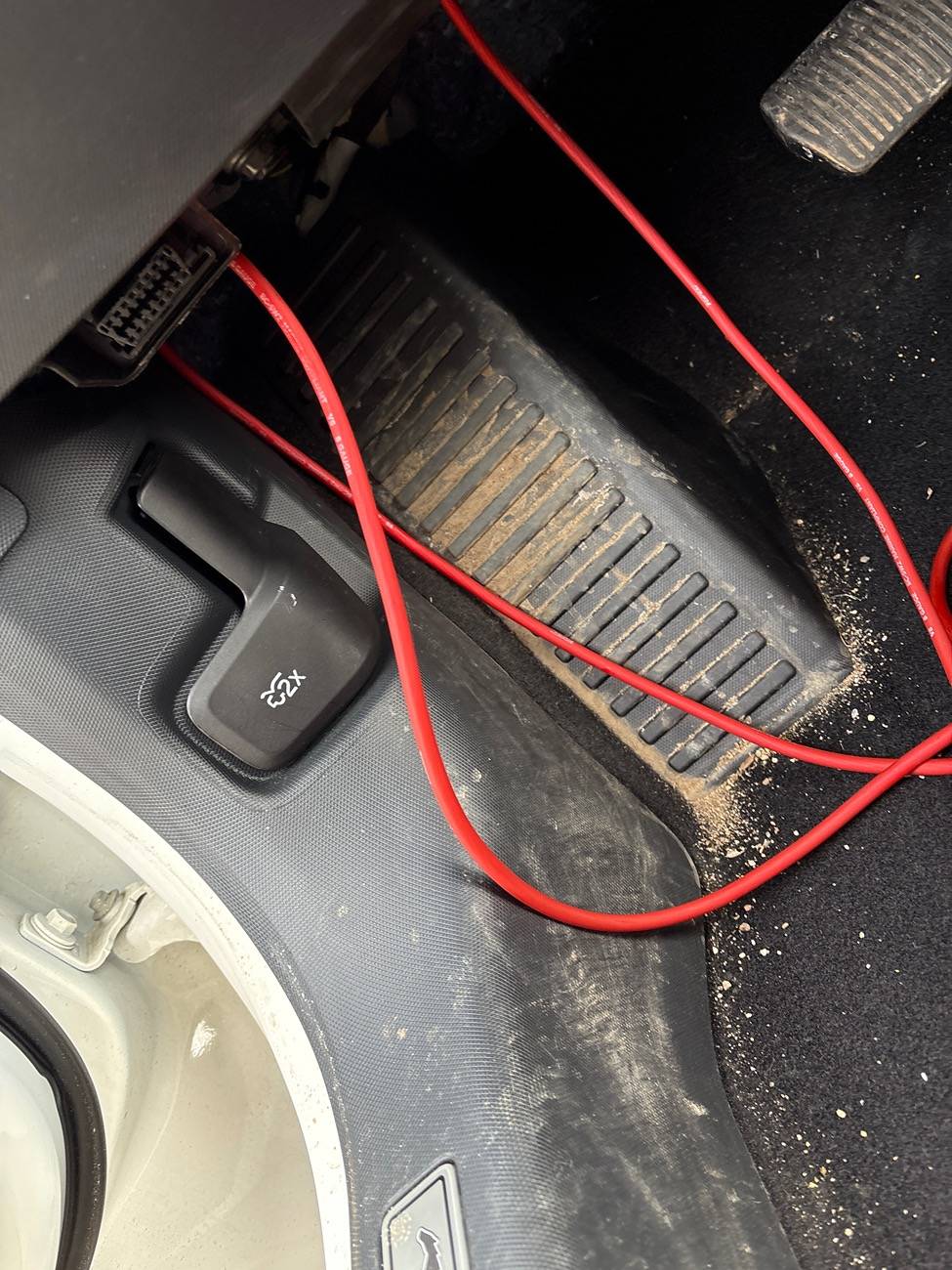

Any tips for running it down the left side? Does the panel with the hood release pop out? My release is in the way.

That hood release handle comes off easily. Then you can remove the kick panel. Probably better to DM me and then we can go back and forth easier.

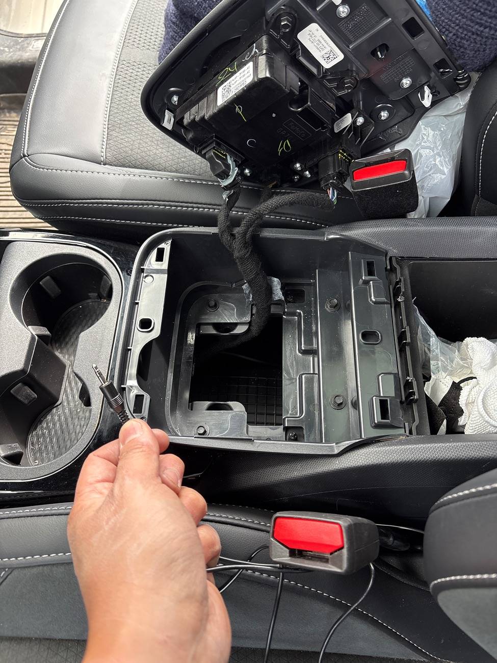

Last question, how did you feed the remote cable to that centre console nicely? I think this might be something that helps other people out too!

Unbolted the drivers seat and tipped it back to run the wire from where you are at under the carpet across to the kick panel your running the power wire.

Better than I did - I was too lazy to unbolt the seat, so I stuck my hand as far down the console as I could until I felt carpet and some sliver of airspace - I think it was near the front of the left seat rail of the passenger seat. Once I poked it through there and got hold of the other end, I worked it to the extreme rear right bottom corner of the center console near the right rear passenger's footwell. Then I just put it under the weathertech rubber mat and up under the rear passenger seat and into the trunk under the carpet. It's invisible and neatly hidden from passenger feet, at least.

There are several ways to do this but yours may be better. You do need a 55 and 50 torx to remove those seat bolts and most people don’t have those sizes.

Here's a close-up of that no-drill/chewing gum (Gorilla Putty) mounting method - I'm pleasantly surprised at how well it stays put and out of the way.
