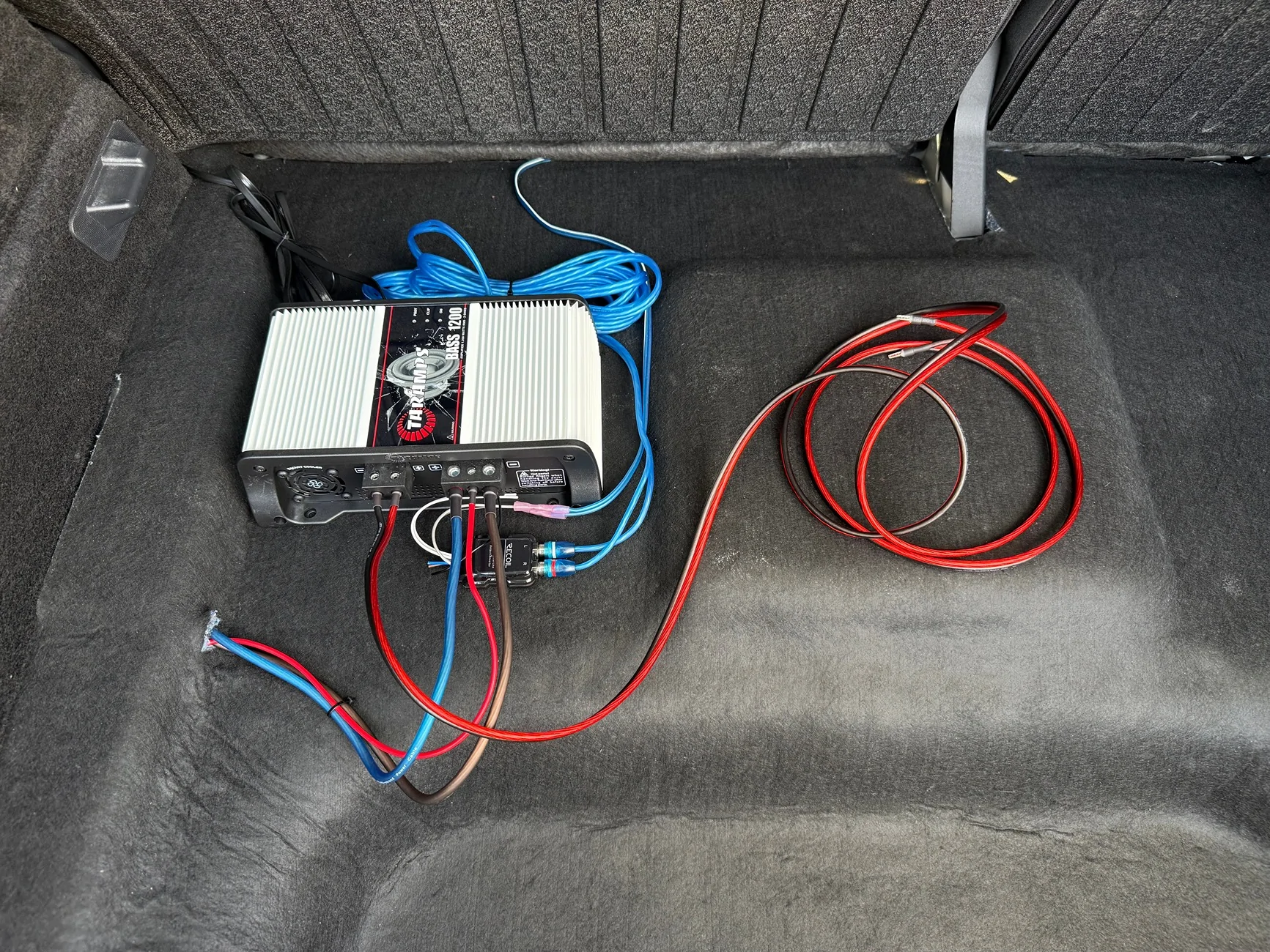

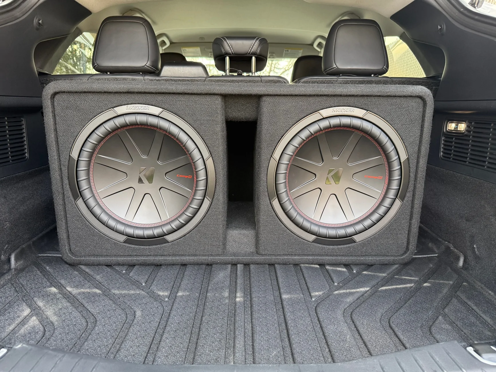

Well after a little project over the weekend and really just a proof of concept to myself, I got my 2 Kicker CompR 12's installed. Its pair with a Taramps Bass 1200 watt amp at 2ohms. Doors and tweeters I went with Hertz all around. For me sounds amazing and slams damn well. Next week or 2 it'll be 4 gauge power and ground, CT Sounds LOC, and amp rack to finish it all off.
Ford Mustang Mach-E Adding a real subwoofer w/amp to your Mach-E IMG_1855
Ford Mustang Mach-E Adding a real subwoofer w/amp to your Mach-E IMG_1856

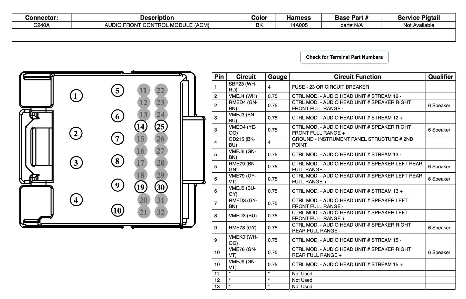

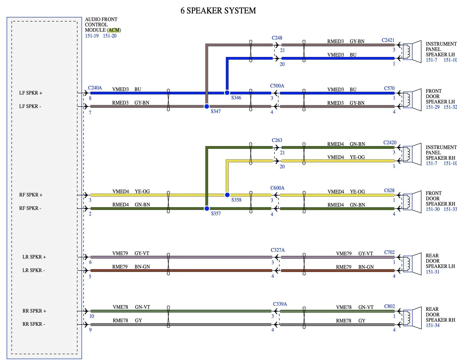

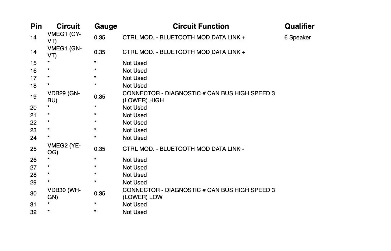

Hey George, sorry I didn't know what you were looking for. I just saw you wanted the pinout of the plug for the APIM. You want to use the ACM (Audio Control Module) which is also in the same area as the APIM. Below is a wiring diagram for your 6 speaker ACM and the plug pin out.
Awesome, ty markboris!
