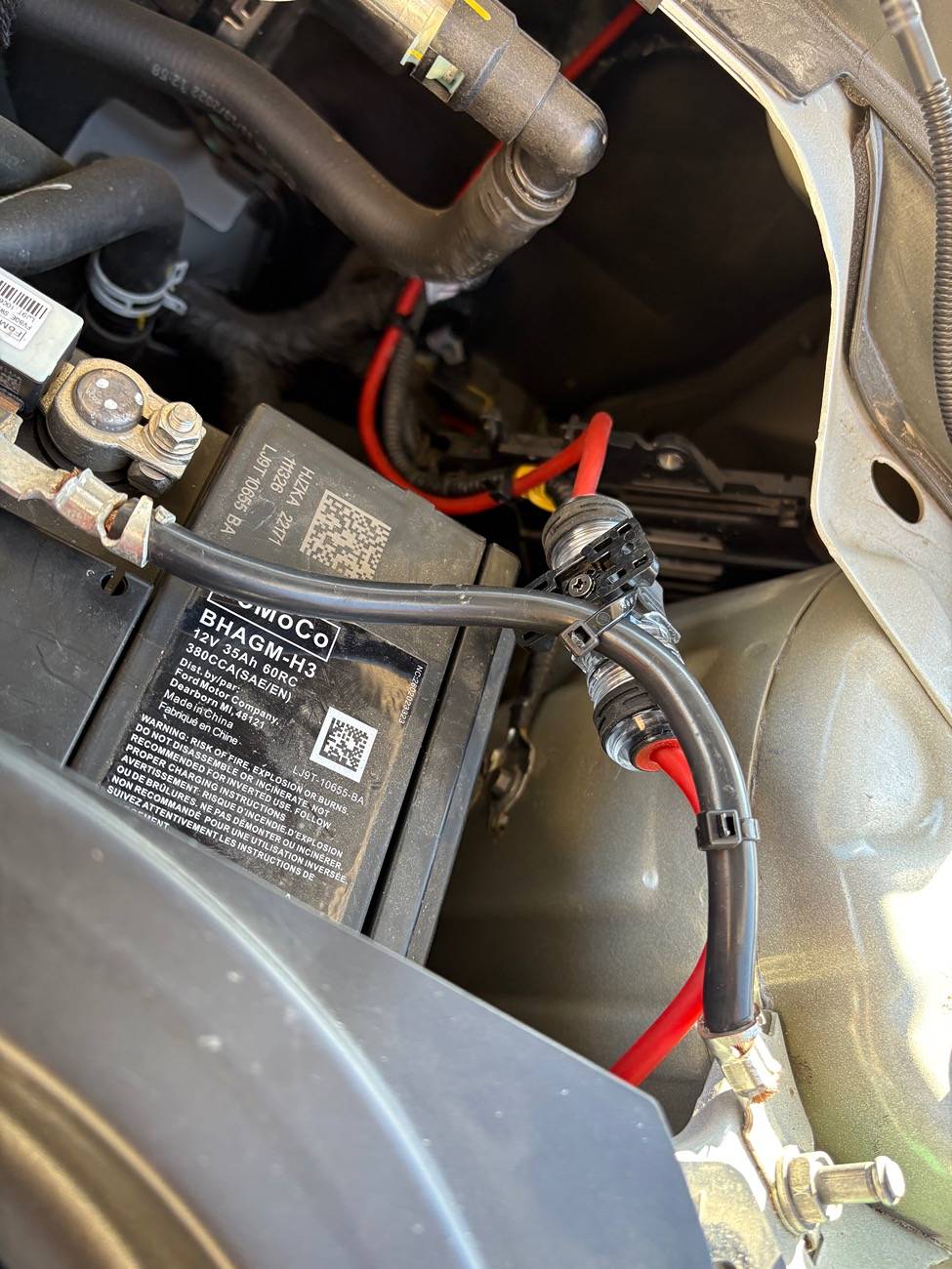

Thanks to everyone on this forum for your help! It’s been a bit of a busy week so I had to piecemeal my audio install.
First off I ran my power wire and zip tied it all up nicely!

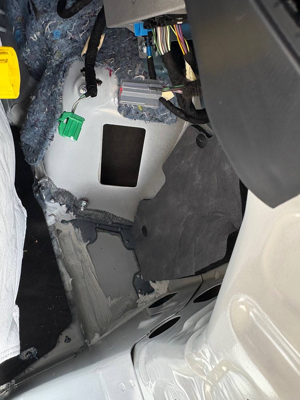

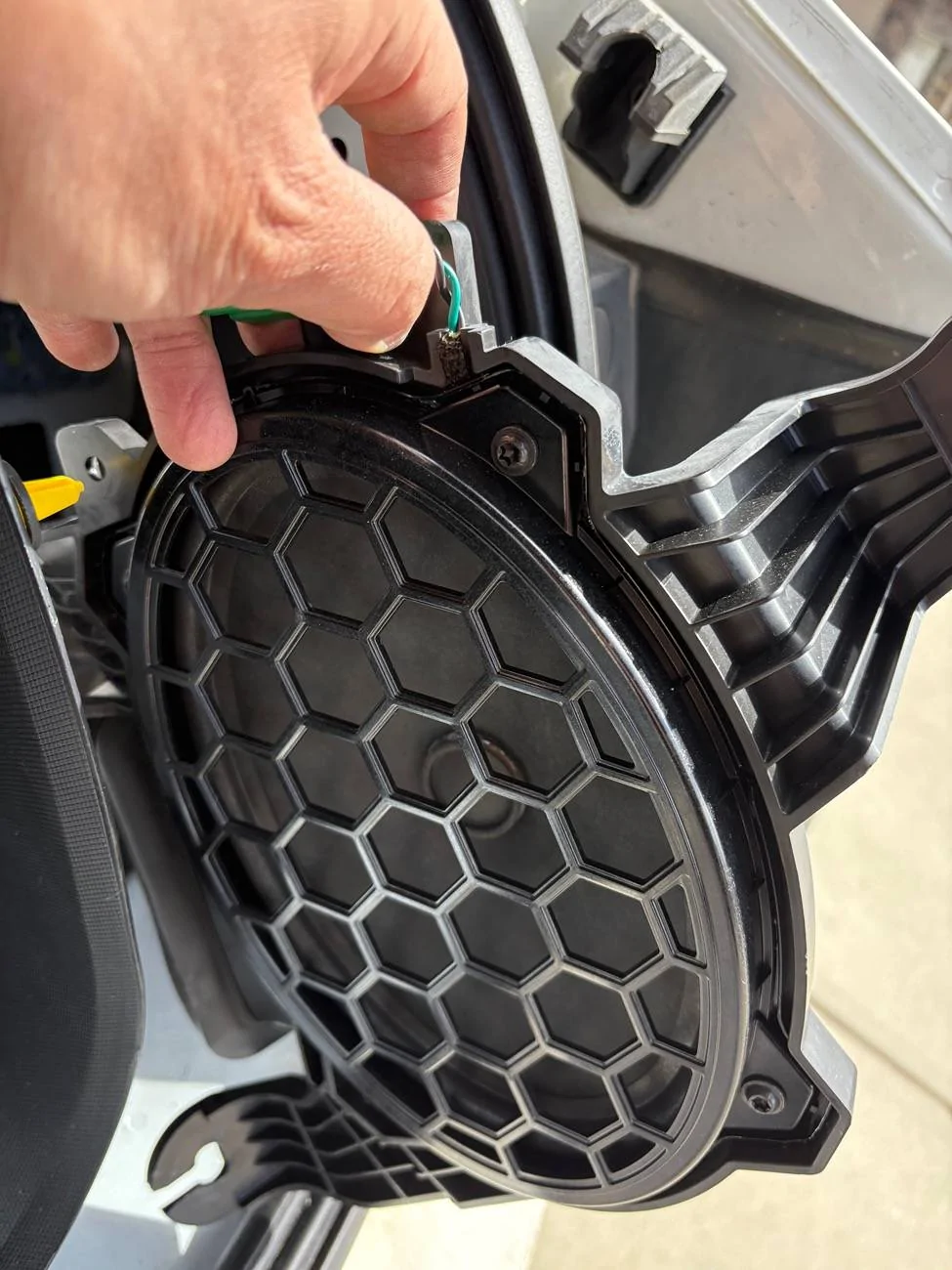

After removing the factory 6x9 “Sub” there was a hole from where it ported to the wheel well.

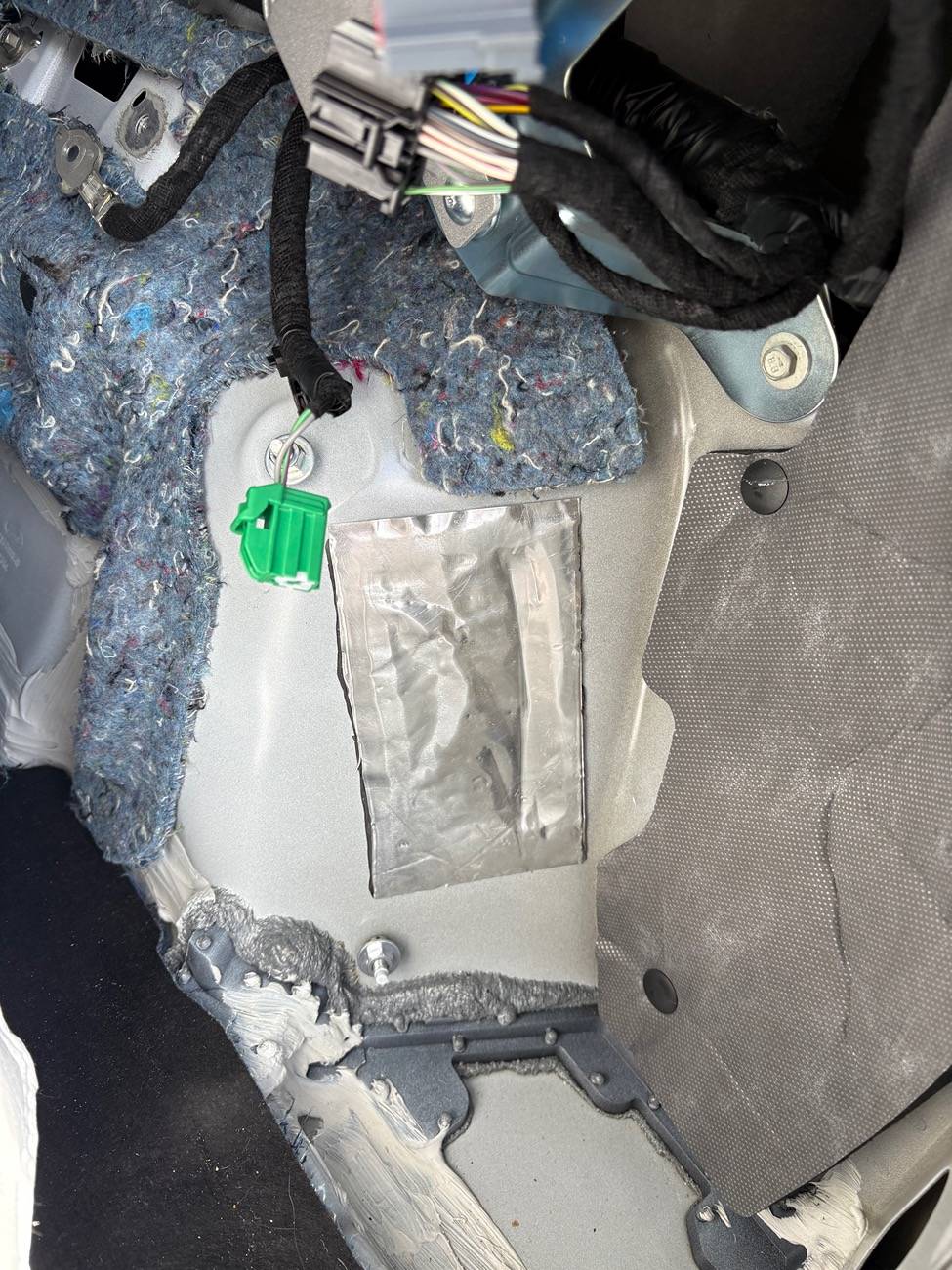

I was able to put a piece of dynamat down to cover it.

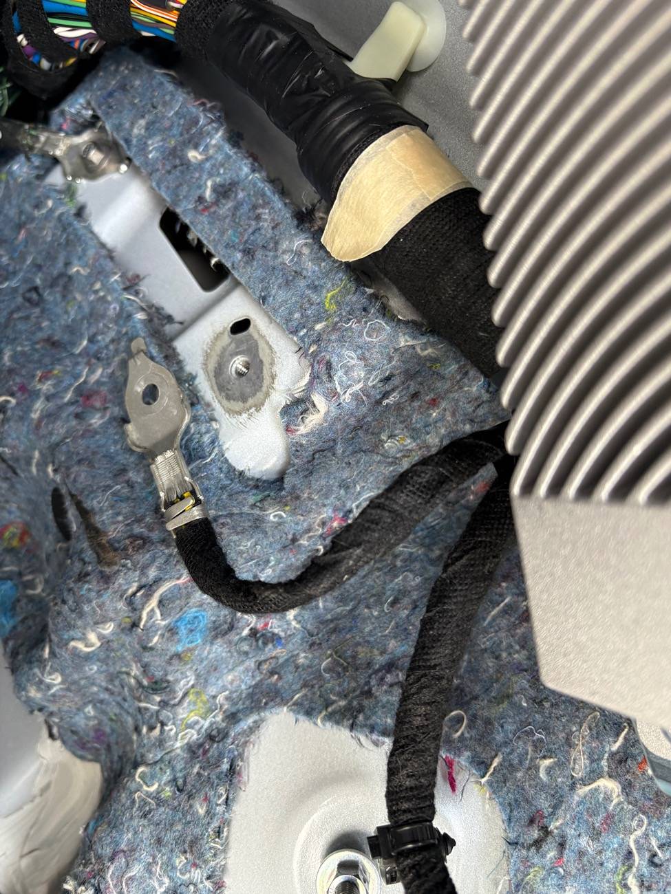

I found the ground point and ran my 8ga from there. I took off the factory connection and sanded the body for better contact.

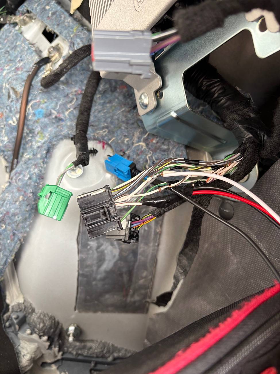

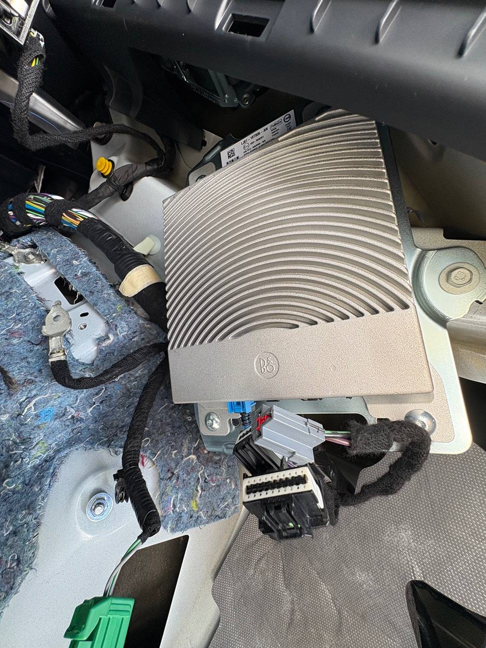

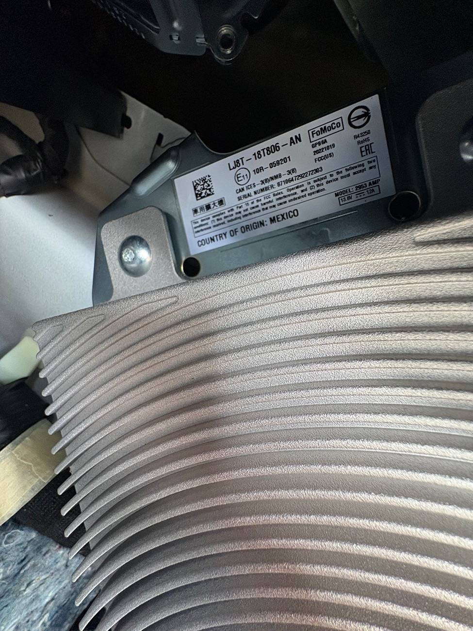

And here are some pics of my factory B&O amp where I tapped and soldered into the speaker output wires for my key 500.1 amp

@markboris, how different is the 2024 amp? I’m still on the fence about installing an alpine Class D amp I picked up inline but this is pretty good for now.
Anyway, I set my gains (which I need to tweak) and am working on tuning now. Sounds pretty darn good so far!

Nice install Matt! To answer your question, the B&O amp is physically different in the '24 models but not sure if they changed anything else with it. To me it seems the system can play a bit louder than it did in my '21 but that can also be some of the DSP tweaking they did.

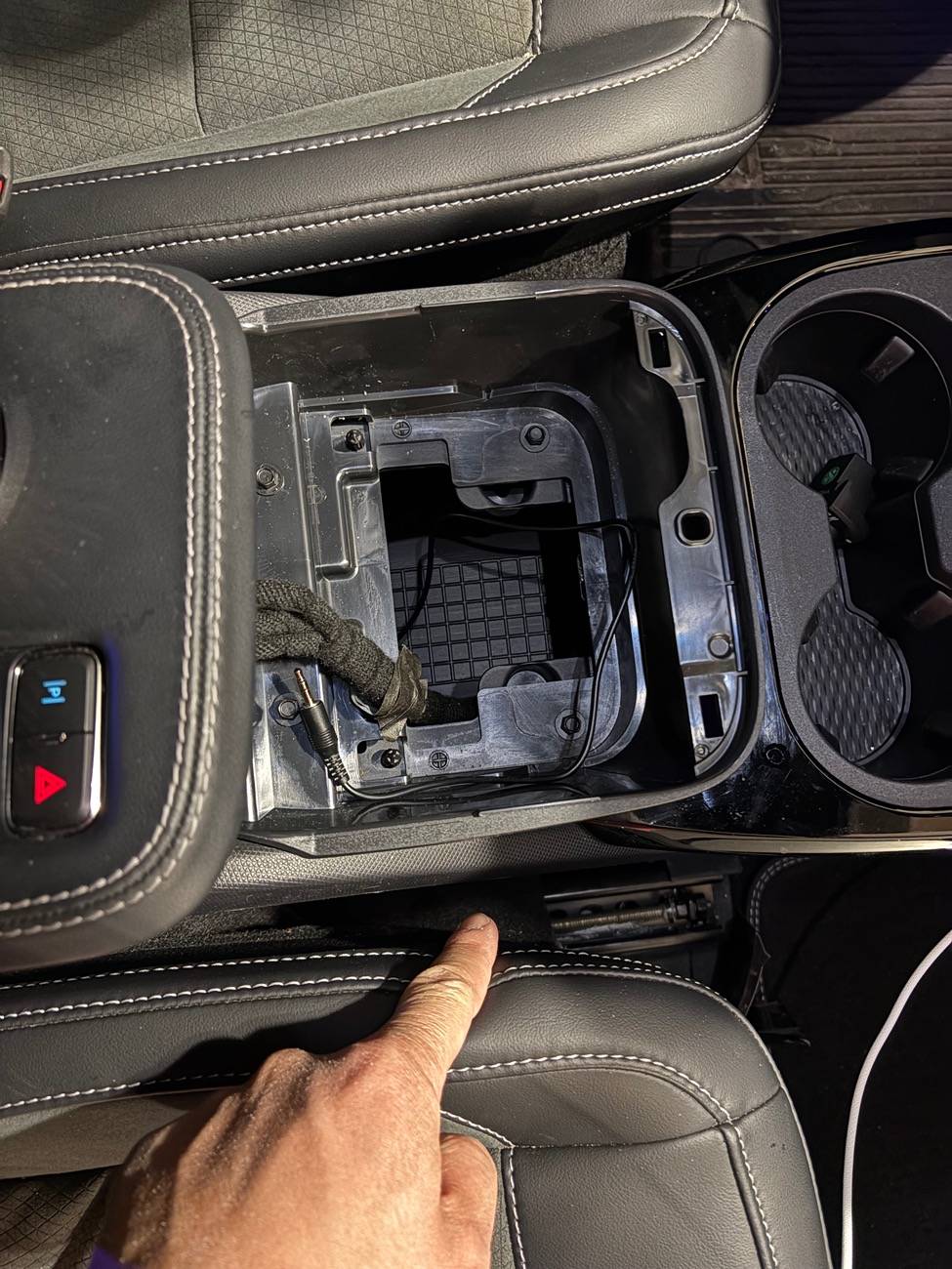

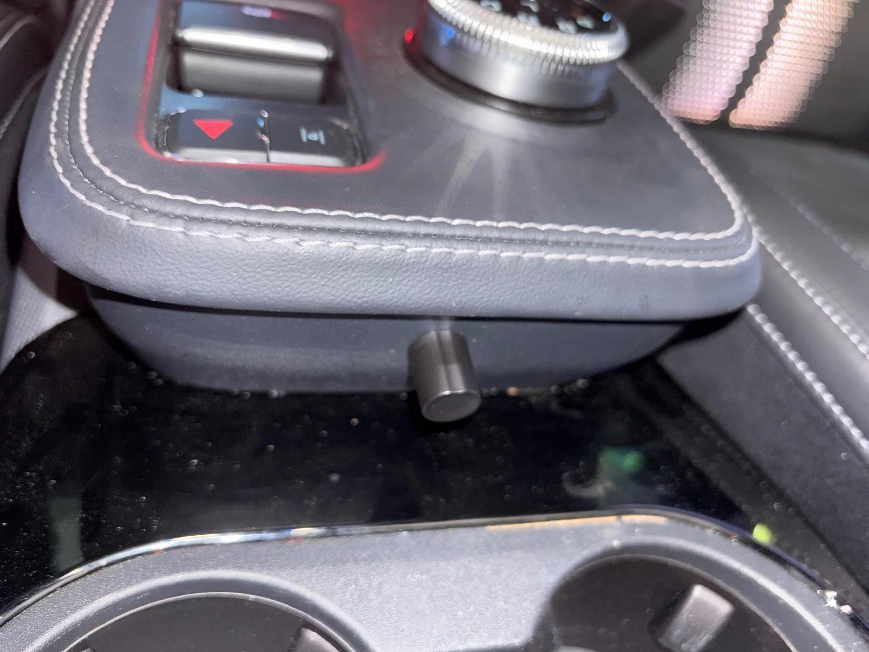

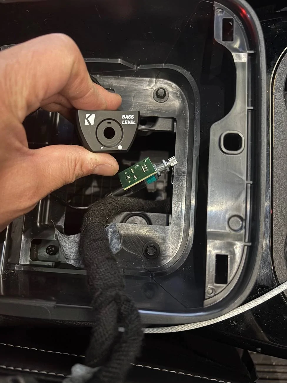

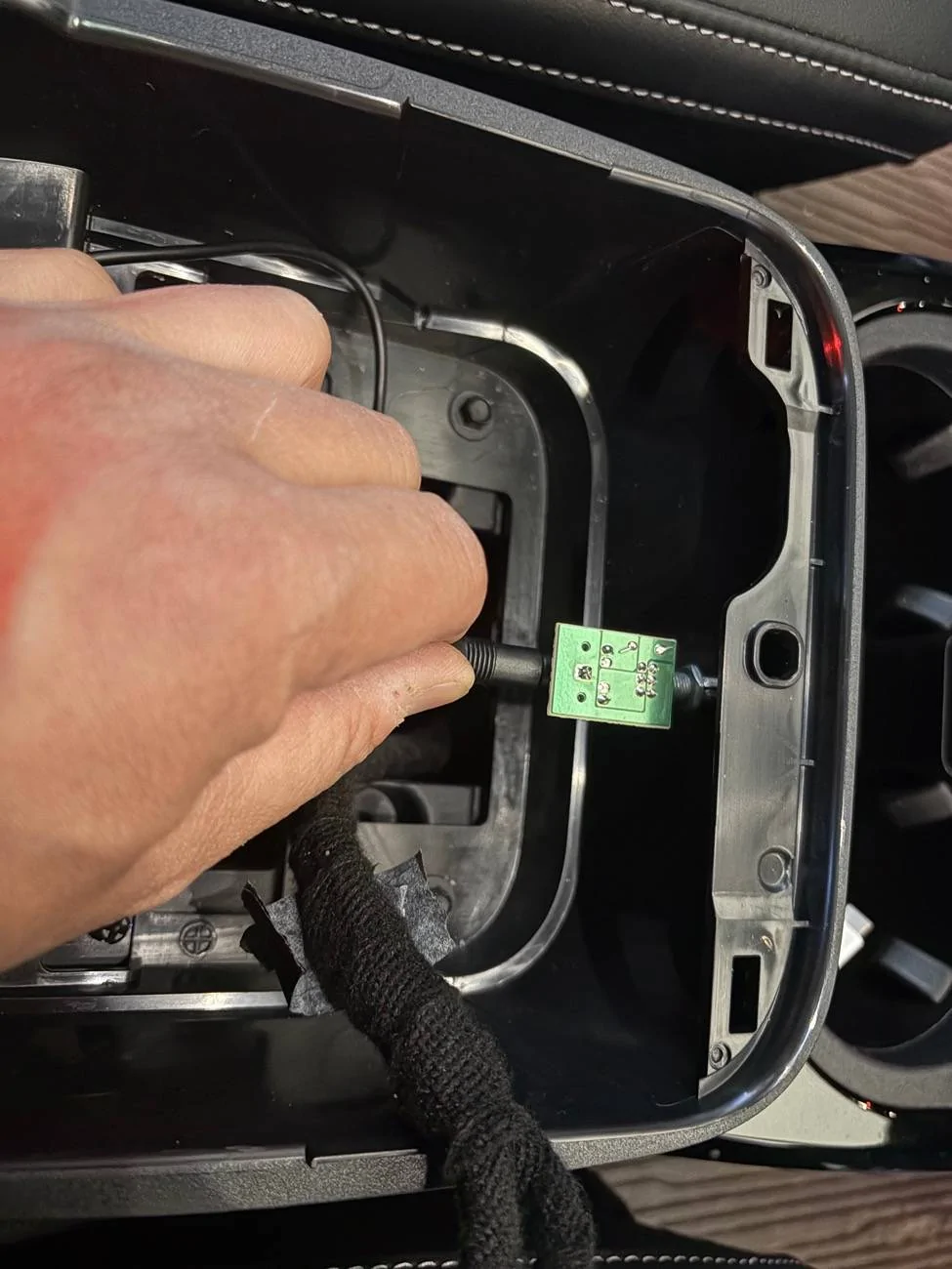

I got to hardwiring the bass control knob today. Quick tip, there are connectors in the shift knob that stick down and make sure you place the knob so it lines up with the gap in the connectors from above.
I didn’t but sort of lucked out but it’s putting some pressure on the internal bass knob pcb. Hopefully shouldn’t affect it long term.

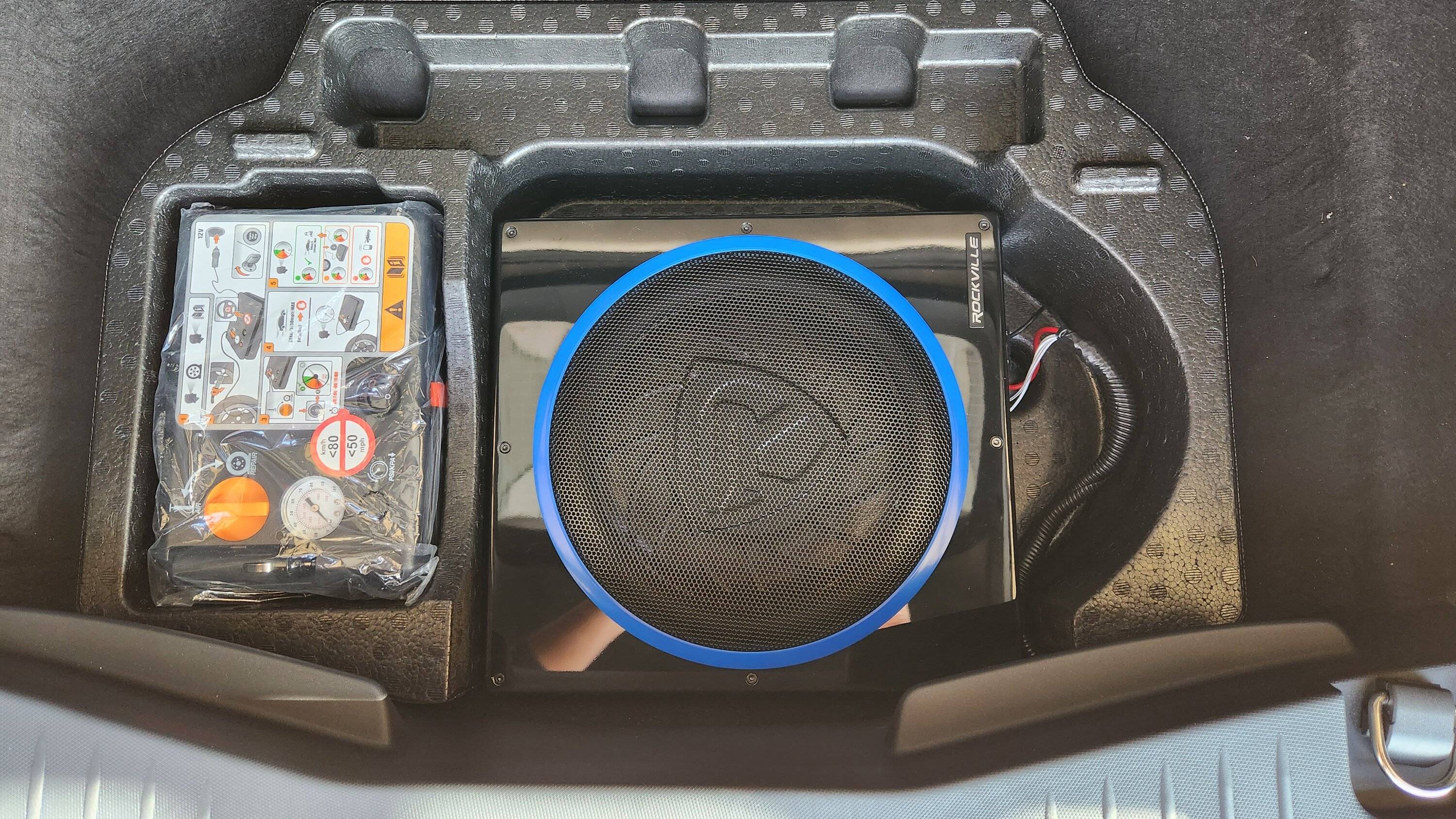

Followed the "Super Easy" method using a Rockville RW10CA subwoofer, which almost perfectly fits the charger storage compartment. 10" woofer really hits.
Think this is what I’ll do in my 24. Seems easy with the least mods. Any others that fit as nicely in the foam like that?

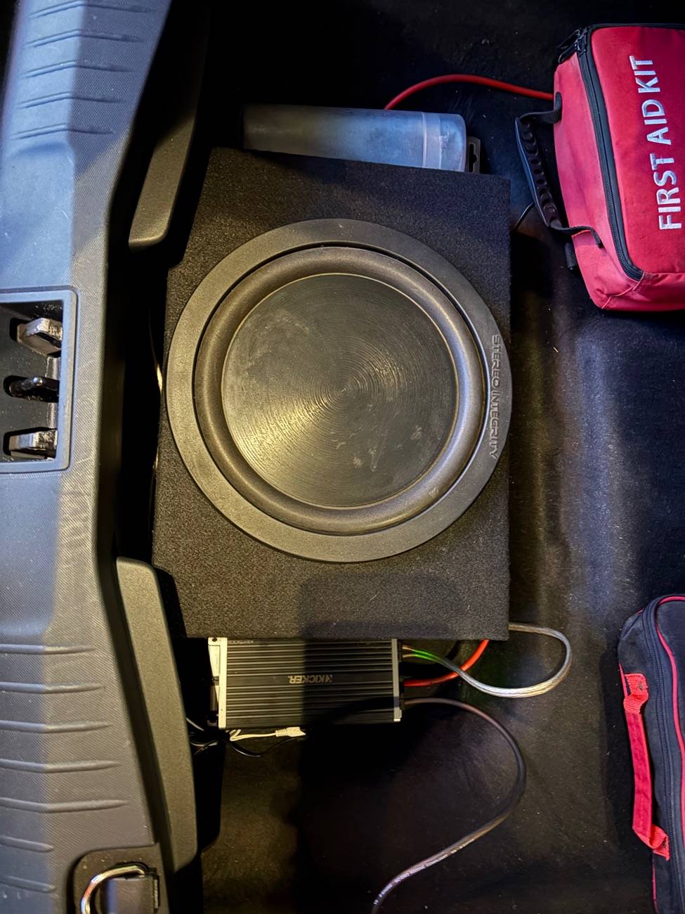

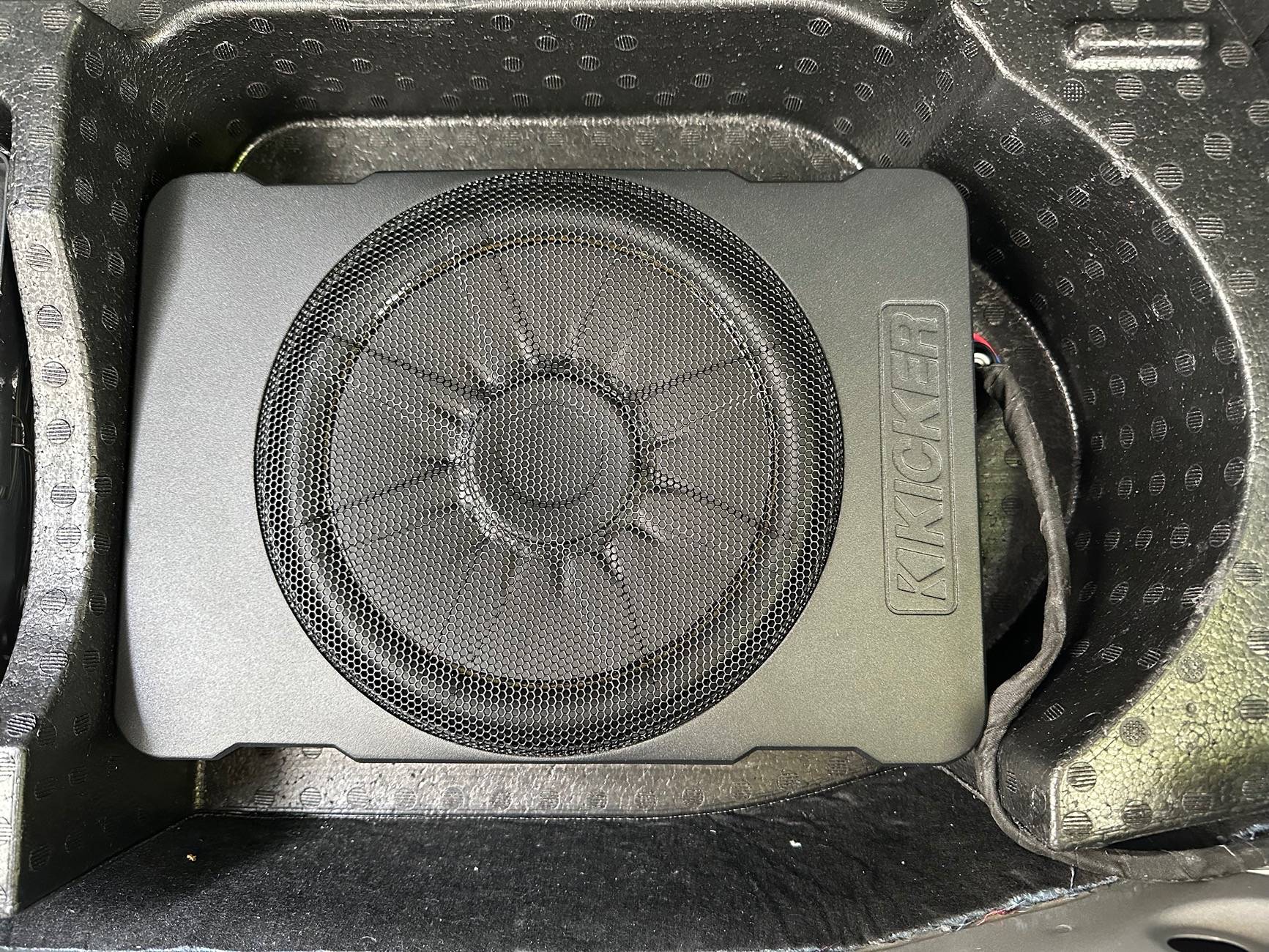

I went with the Kicker 51HS10. Fits like a glove. I picked up an open box from Best Buy. It looked untouched (including the wires) and I saved about $100.
Installation was a breeze thanks to big help from @markboris (of course) who offered me tips and a video showing me everything I needed to do for the "easy" install method.
The bass is better than expected and it might even get better after some break-in.
I set the crossover at about 80hz. This was good without being boomy. It needed a bit more punch and although I hate to use bass boost features, I did crank it up a little bit. I was thinking about what @markboris said in an earlier post about the rolloff below 35hz and since the kicker boost is at 40hz, I figured I'd give it a try. And wow, that was the difference for sure.
As additional info, I also replaced the center speaker with the Kenwood. I find now the system sounds best in Surround.
