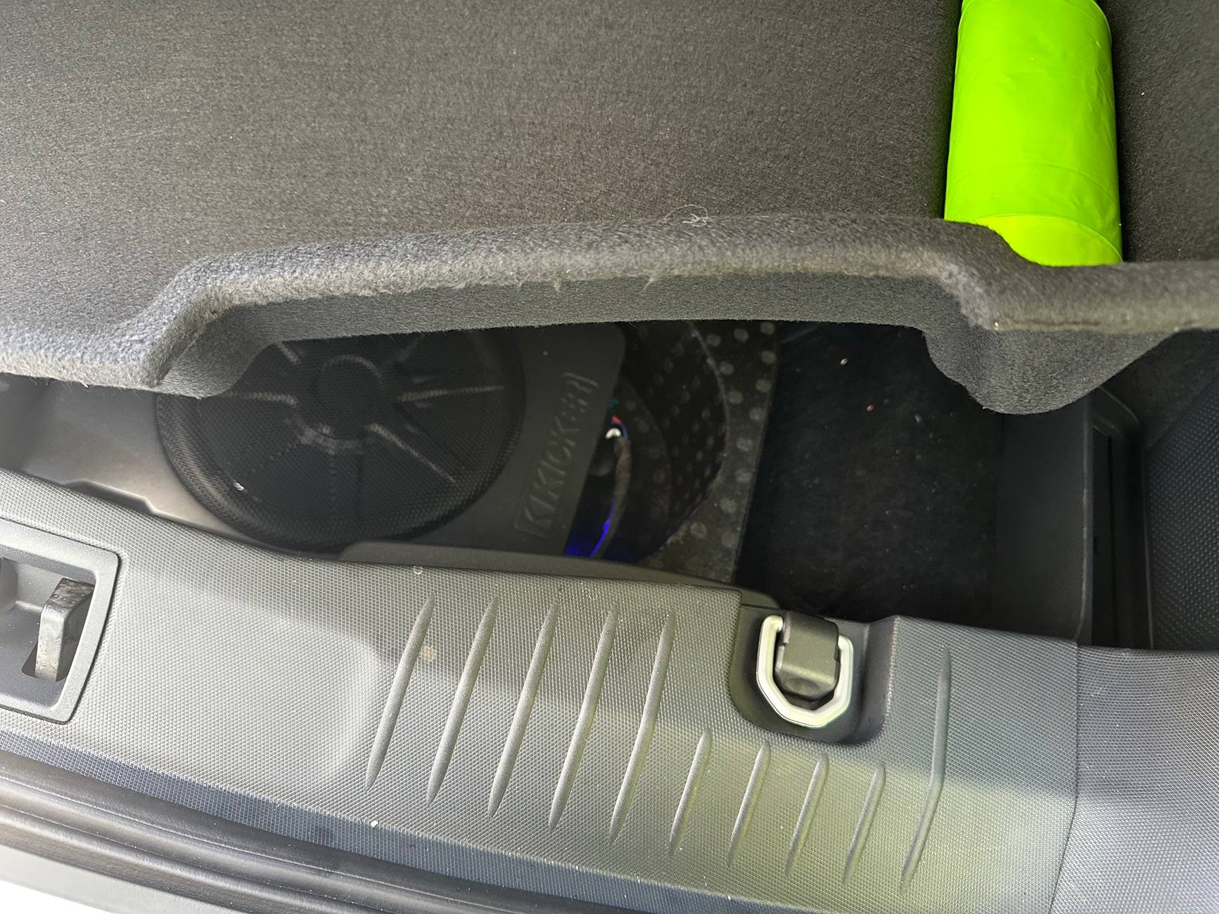

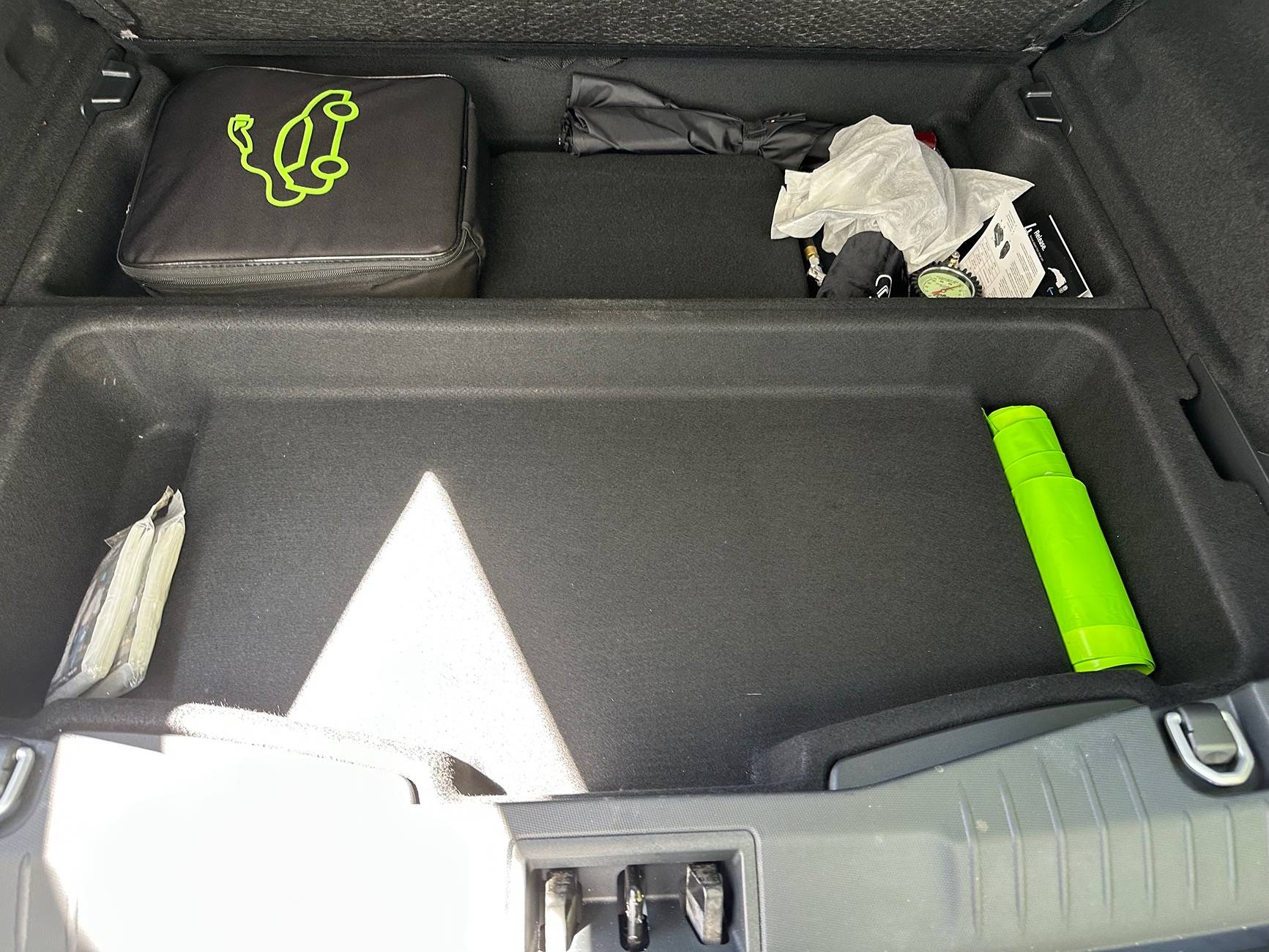

Not the most popular accessory, but I added the storage trays over the sub. Thought they might rattle or block the sound a bit but no issues. Don’t think I’d ever need the cargo cover lowered anyway.

Where do those storage trays come from? I just had my subwoofer installed at Cartoys since I'm not up to doing that these days. I need to cover it back up now, and will probably put strips of wood with velcro on each side.

Yes I’d say it does since it’s resting on the foam.

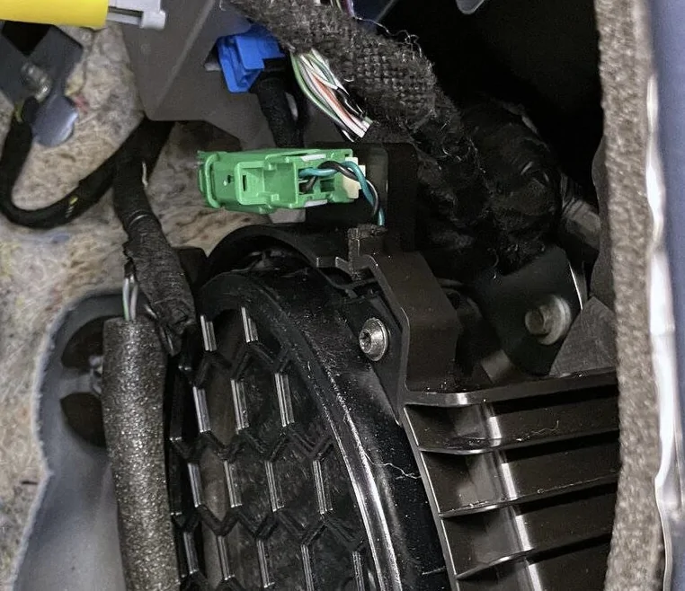

Hi folks, I’m hoping to install a subwoofer but without cutting or tapping into any wires so the mod is 100% reversible.
Could anyone confirm that this is the same connector that’s present in the subwoofer speaker assembly?

Looks like the same connector but I would think unless you actually try it, you would not know for sure.

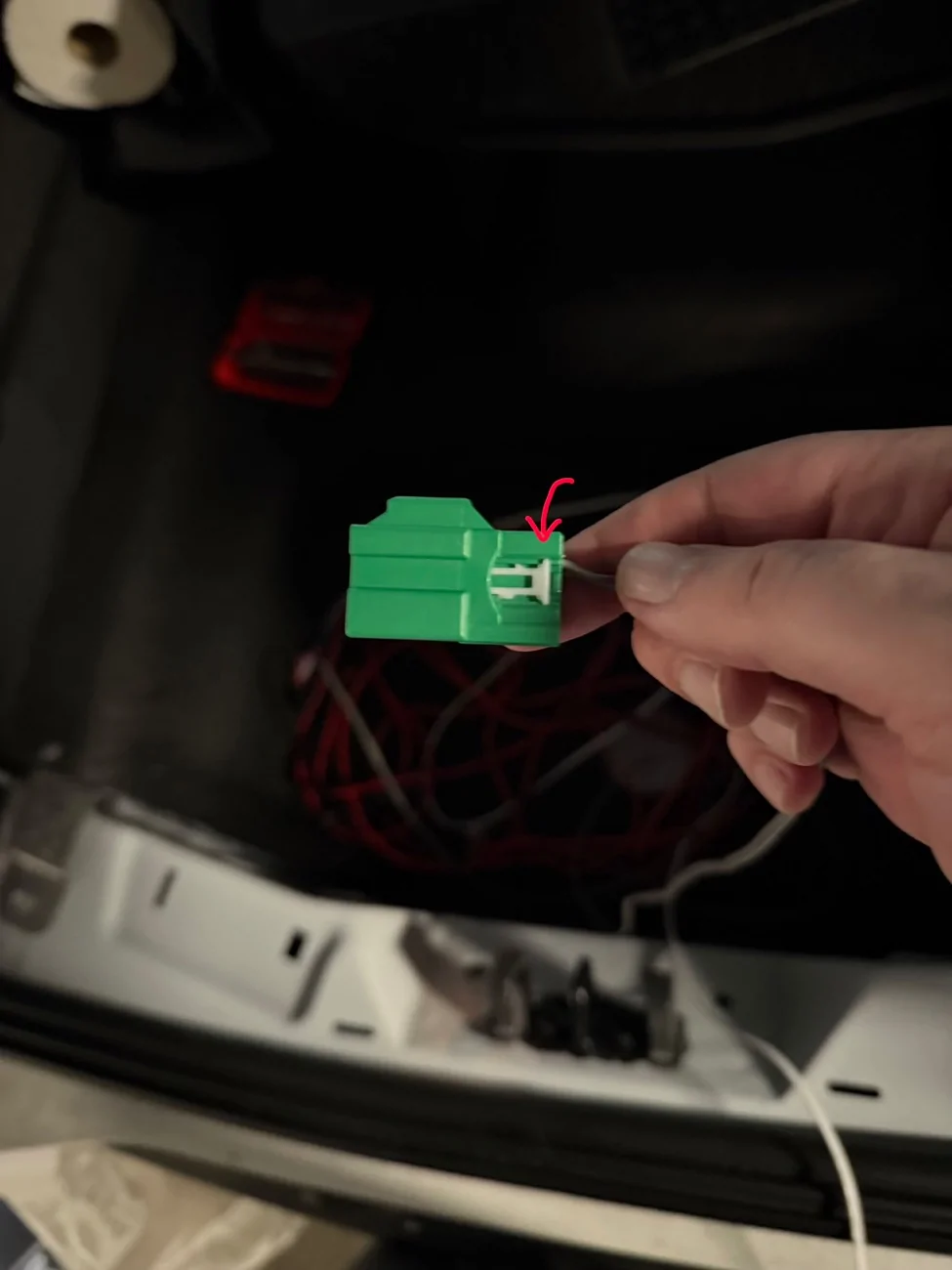

To follow up on this, it took me a while to get all the parts and tools needed, but I can confirm that this is indeed the right connector. Tips for anyone who wants to use it:
- You’ll need an “open barrel” crimping tool.
- Make sure the inner white plastic part sits all the way towards the back of the connector, otherwise the female plug won’t latch. If the 2 connectors don’t click-in easily, the interior white plastic part isn't pushed deep enough.
This shows the correct final position of the inner white plastic part:

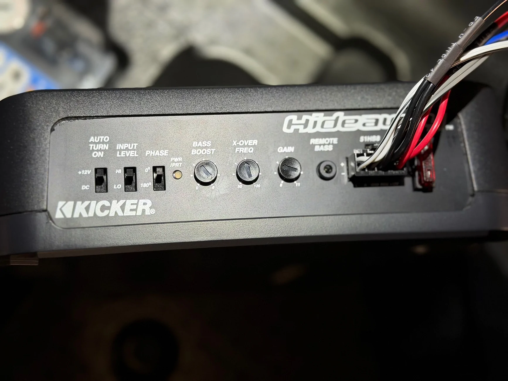

Finally, I’m sharing some notes on how I installed a Kicker HS8 in my 2025 Premium with B&O:
- The connector terminals were crimped directly to the gray signal wires.
- White signal wires were left disconnected.
- Have to use the +12V Auto Turn On mode and connect the blue wire to +12V, otherwise the subwoofer won’t turn on.
- I used this cigarette lighter connector: https://a.co/d/0cWmQVZX
- Input level: Hi
- Phase: 0°
- Bass boost: max 😁
- Crossover: 80 Hz (around the 11 o’clock position)
- Gain: slightly below the second tick mark (around the 10 o’clock position)
All in all, I’m quite happy with the HS8. It blends nicely with the OEM sound system while still being clearly noticeable. Recommended!
