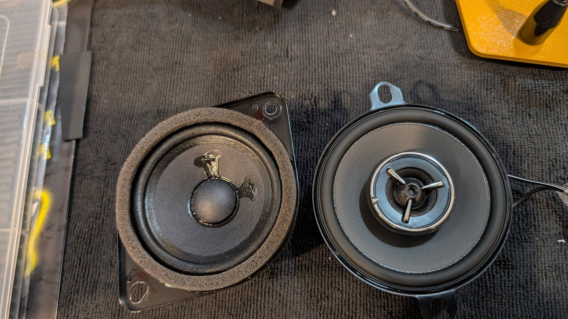

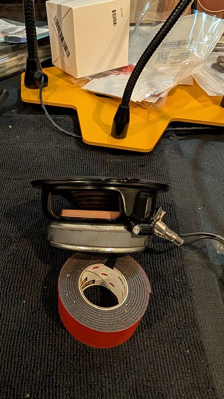

I'll add my two cents to this thread. I just changed out the center speaker on my B&O premium system and I'm really liking the results, but first, a little disclaimer is in order. I'm a home high-end audio two channel guy and definitely not a car audio expert. I've been a senior associate editor for www.positive-feedback.com since the early 90's and the sum total of my car audio reviews equals zero. I do, however, know a thing or two about audio and particularly what sounds good to me. So take the rest of this with the appropriate grain of salt.
I've ordered a subwoofer to install in the back deck, but as I'm waiting for a few parts to come in, I decided to order a replacement center channel and do the very quick and easy installation. I ordered a pair of the Kenwood Excelon KFC-X3C from Crutchfield for a modest $79 and recieved them in two days. Why did I choose this one, you might ask. Well, there were some very definite reasons. Crutchfield says it fits perfectly, the sound quality of this two way is well regarded and it features a silk dome tweeter ( I have usually found silk domes to be friendlier to my old ears), but the big reason is 4 ohm resistance with a very low 83db sensitivity (1w/1m). The low sensitivity is really the key here. The stock B&O one piece paper cone driver is undoubtedly a higher sensitivity (I looked but couldn't find the spec on it) given the simplicity of its design. The problem I heard with the B&O system (besides the lousy bass) is that the center speaker is playing just too darn loud in surround mode, such that it spoils the center imaging and doesn't blend well at all with the rest of the speakers. Even in stereo mode it's still playing, albeit at a slightly lower level, and again the classic two channel center imaging suffers.
Here's where the low sensitivity Kenwood Excelon comes in and saves the day. Installation was a breeze. I swapped out the stock speakers cable attachment so that I could plug the Excelon into the stock wiring. I used the included foam tape to dampen the top and bottom edges of the speaker basket so that it fit snugly in the stock hole with no vibrations. I even added some dampening compound to the back of the magnet and to the basket frame to kill any stray vibrations. I buttoned her up and gave it a short break-in period (just a few hours playing fairly loud in surround mode) and then did some critical listening. Oh, just a note on what I listen to and what a difference it makes in my overall enjoyment - I stream Qobuz using a wired usb connection to Andoid Auto. This gives me better sound then using bluetooth and If I'm not mistaken, the wired usb mode with Qobuz may allow you to exceed AA's default down sampling to 16 bits and 44.1 khz (although certainly not 24 bit 196khz). My other source is a usb flash drive that has very high resolution FLAC files. This is another small step above the Qobuz feed, but nothing major. Using either of these sources sounds waaay better than Sirius XM or the built in FM reciever and takes the stock B&O system from sounding very ho-hum, to not too bad.
I'll cut to the chase. The Excelon speaker blends incredibly well with the dash tweets and the other stock speakers. It has a similar tonality with a considerably more unfatiguing definition. It is no longer overpowering. I can now listen comfortably to surround mode and there is a good spread across the front stage. The center channel no longer stands up, waves it hands in the air and says listen to me. It's now subtle and blended. The surround mode is now quite immersive, the way it should be. Stereo mode now has a lot more seperation left and right as you would expect with the center channel playing at a much lower level. I think I know why B&O mixed in the center channel even in stereo mode. They may have had the right idea, but overshot the results by a big margin. When you mix in just a little center channel with stereo mode, you get a nice arc with the front stage and a little less of the headphone effect that often seems to plague the car environment. There is definitley more going on in Surround mode than just boosting the center channel, but I won't get into that now. I do have a full-on test mic and REW software on my laptop, but I feel ill-prepared to use it in the car audio realm. Suffice it to say, the surround mode that was formerly unlistenable is now quite possibly my favorite listening mode. I've had to change my Beosonic and Equalizer settings to dial it in, but by golly, its really sounding good.

I made the exact same center speaker change you made, including switching over the connector. I bought the speaker from a member who had bought the Kenwood two pack and changed out his center speaker, leaving him with the extra one to sell.
I enjoy music but have pretty much a tin ear. High end systems are more or less lost on me. That said, the Kenwood center speaker is a nice change and makes things sound much nicer, even to my tin ears. In addition I recently got Beosonic up and running compliments of pal who knows how to work that magic.
I’ve also borrowed the trick others have spoken of, of moving the fader more to the rear to get a bit more base from the “sub base” that lives in the fender. I am toying with the idea of a small powered sub that draws < 20A that can be powered off the outlet in the trunk area. That’s not urgent and may never happen. We’ll see.
As OP says above, this center speaker switch out is a really simple, easy change to make. It adds positive value out of proportion to the cost and effort of the job.

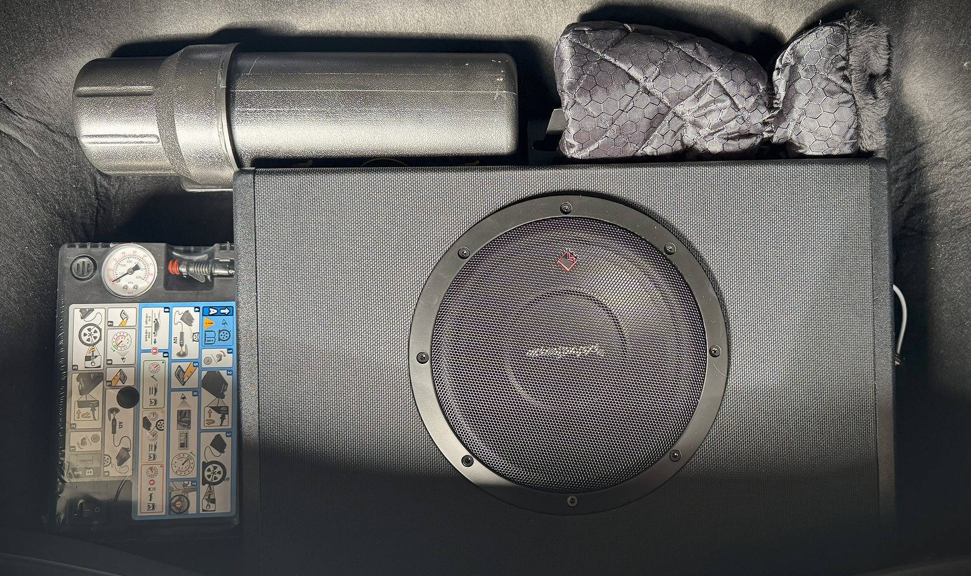

This 8" RF powered sub\amp unit fits your stated criteria - I'm rather pleased with the resulting improvement:
Really appreciate the inspiration and knowledge shared here! Thank you all, and especially the OP @markboris. I went with the Rockford-Fosgate “Punch” 8” vented and powered 300w RMS sub-woofer. It seems to be a reasonable match for the B&O components, the available space under the load floor (even in the low position), the undiscriminating nature of my uneducated aging ears, and the amount of money and time I was interested in spending on the project to add “just a little bit more bass” to a system I was otherwise mostly happy with.

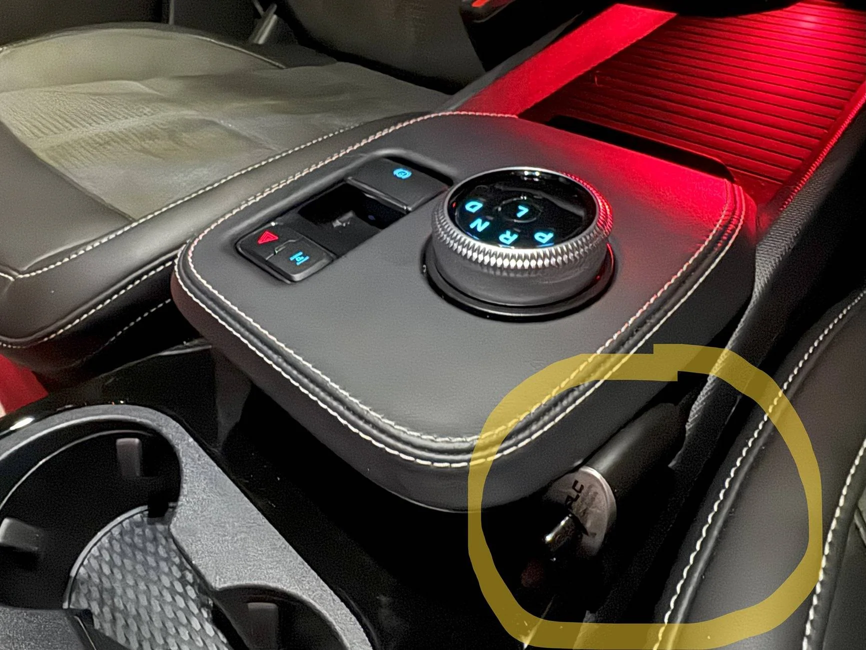

Since it’s only a 20amp unit and the rear 12v is already on a switched and fused 20amp circuit, I just used posi-taps in that corner to tap the power and high-level inputs, while leaving the B&O 6x9 connected to continue contributing some mid and grounding to an existing body ground bolt behind the same panel. Easy-peasy! Plenty of thump to allow me to feel the music in my heart without creating "medically significant" decibel pressures or requiring extensive disassembly of the vehicle!
For not investing in additional sound deadening or "prep of the sound stage" (beyond the removal of the stock Styrofoam and application of velcro to the bottom of the enclosure), I was pleasantly surprised with the lack of rattle and distortion back there even at what I consider to be higher output levels. With 860w total now (560w B&O+300w RF sub), I think it has ended up sounding pretty darn adequate!
I secured the remote knob to the console using a bit of Gorilla Putty (it seems to do a good job of staying stuck until you want to be unstuck, then it's entirely removable without trace).
