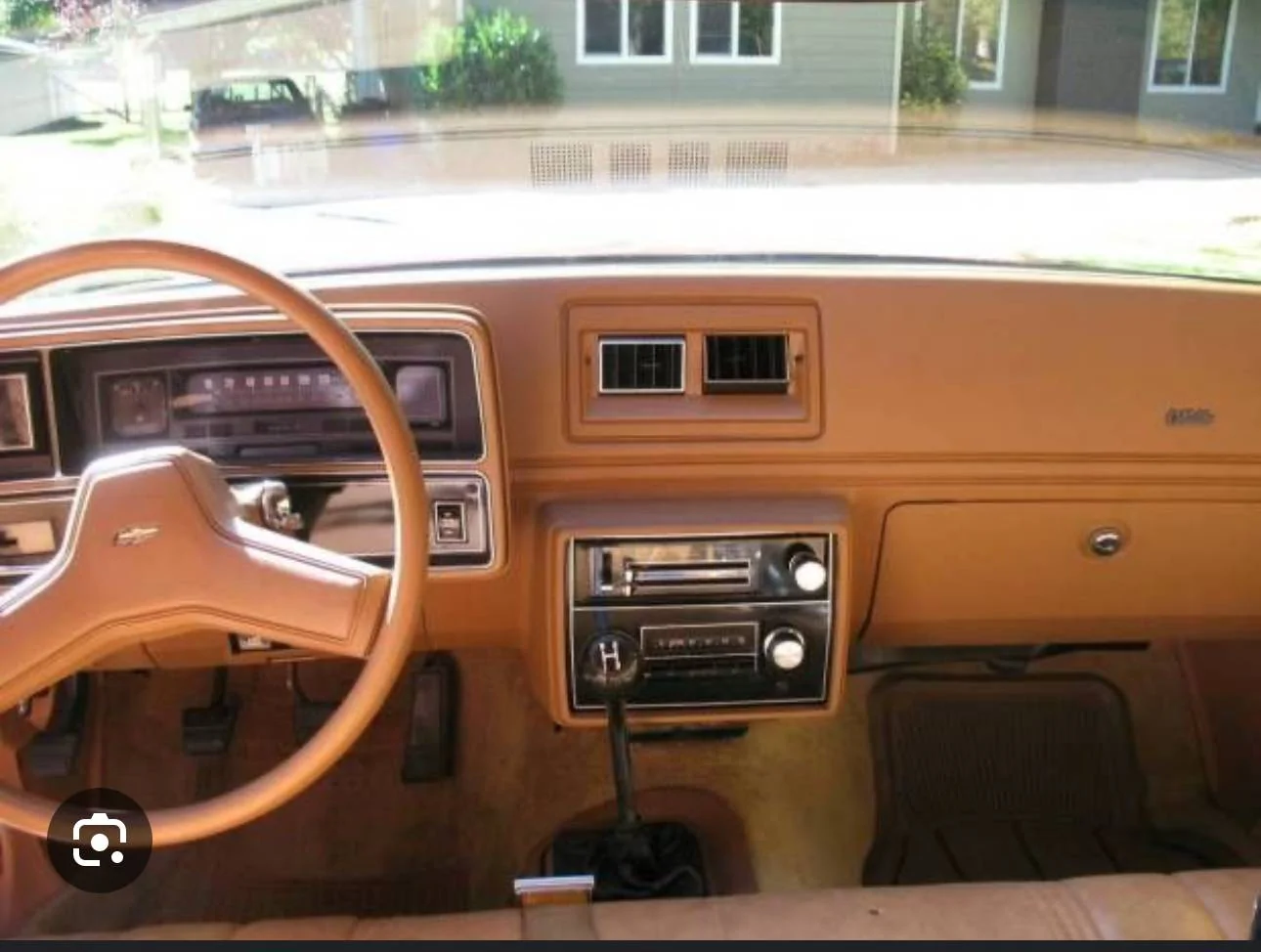

How many of you out there remember when this HVAC and Audio was good enough? I chose this picture cause it was my first car. Unlike replacing this turd radio that included a mono speaker in the dash, unless that center speaker is busted, it’s my opinion it’s not worth the effort.
