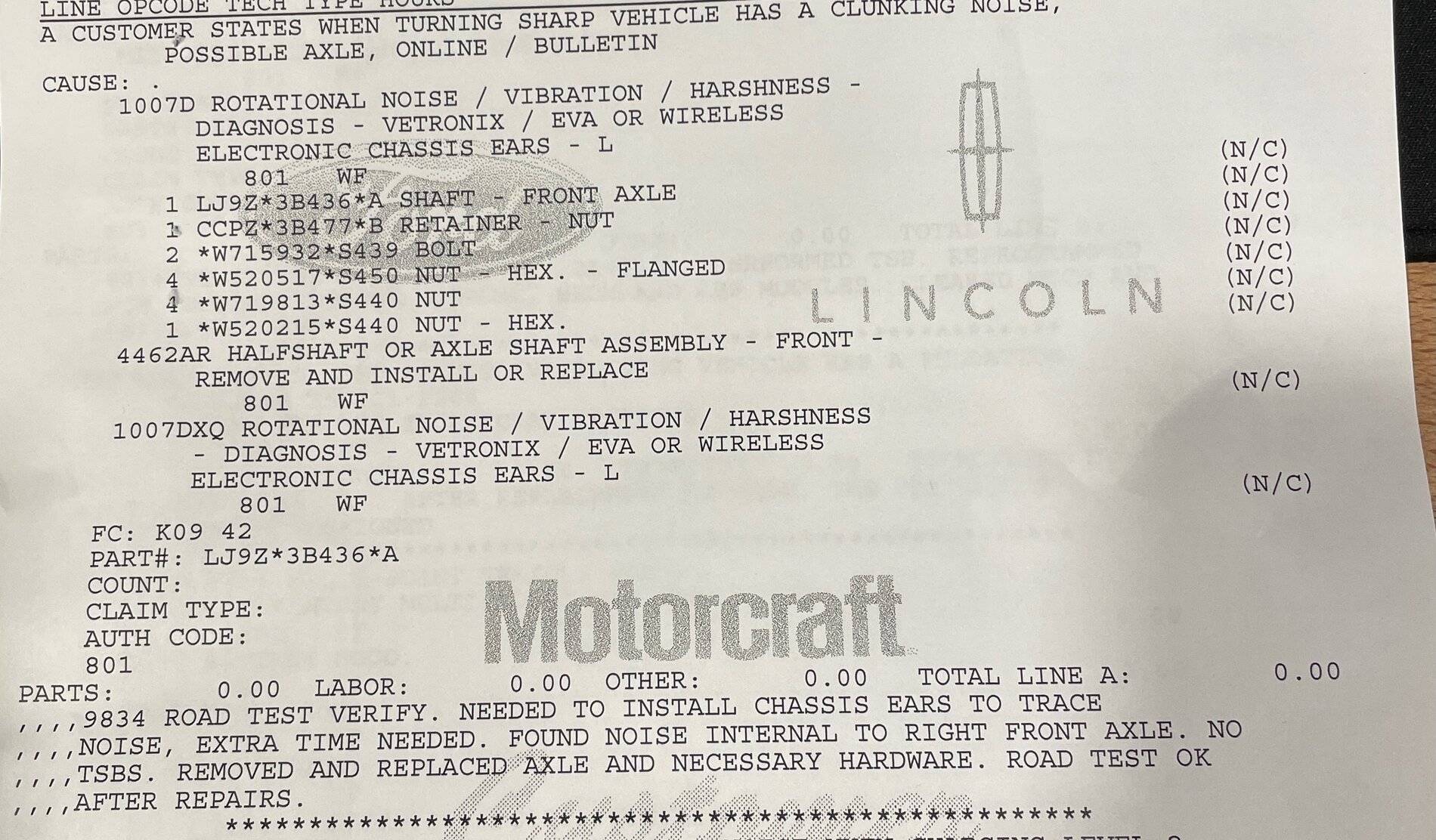

Picked up my Mach-E this afternoon from the dealership. Everything seems to have been fixed. The mileage was just part of their overall testing/etc/etc. Seems excessive, but oh well...
Here's the service sheet for the axle replacement:
ok wow, I needed to refresh this page. Many more messages since your post from the other day, which was still the last showing on my screen ?
OK so that's great to hear, thanks for posting the sheet. Guess it took you just about a few days or so with your car there. I also see "halfshaft" written on your workup so hopefully mine is on the right track then as well. Hoping they have the part in by Friday.
Yea, I was pretty surprised they had it fixed in two days. I was expecting to wait a few weeks for parts...
