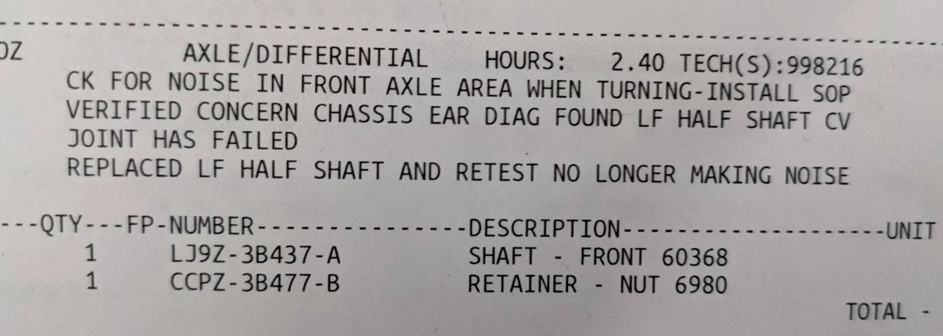

Spoke with service adviser at my dealership briefly this evening and it seems they are having to replace some part/parts of my front axle. He was very brief and is supposed to give me another call in the AM after he has spoken with the technician to get all/accurate info. He did mention that a part is on "emergency" order. Apparently they're a bit shorthanded and busy at the moment....
I'll give another update once I know exactly what they're replacing.
