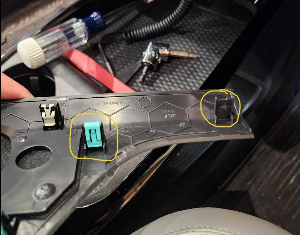

My center speaker had that annoying buzz, so I replaced it with the stock Ford speaker this weekend. It sounds much better now. Very quick little job.
But just a word of warning to those of you who plan to replace it yourself... You may want to put a towel or something over the defrost vents at the base of the windshield. When prying off the speaker cover one of the turquoise clips snapped off and I heard it fall down somewhere - kinda sounded like it ended up somewhere behind/below the steering column.
I didn't find it anywhere in the cabin, and after shining a light down through the speaker hole and up behind the accelerator pedal, there doesn't seem to be an obvious path for it to fall into the cabin. So all I can figure is it must've fell into the defroster vents and went down that way.
Luckily for me I don't hear the speaker cover or the missing clip rattling around while I am driving. And the speaker cover still sits nice and flat.
Even though your grill isn't rattling, if you want any of those turquoise retainers, I can drop some in the mail to you (free). DM me if you're interested.

Replacing the center speaker? Super easy. The grille on the dash above the speaker just lifts up. There are 9 retainers. Use a trim tool and start at one corner. Once off, the speaker is right there. Just unscrew the two screws, lift up the speaker and disconnect the connector. If you look back at post 12 ( #12 ) on this thread I have photos from the repair manual that shows you this. NOTE: I don't use a center speaker. Mine is disconnected and removed. ?
