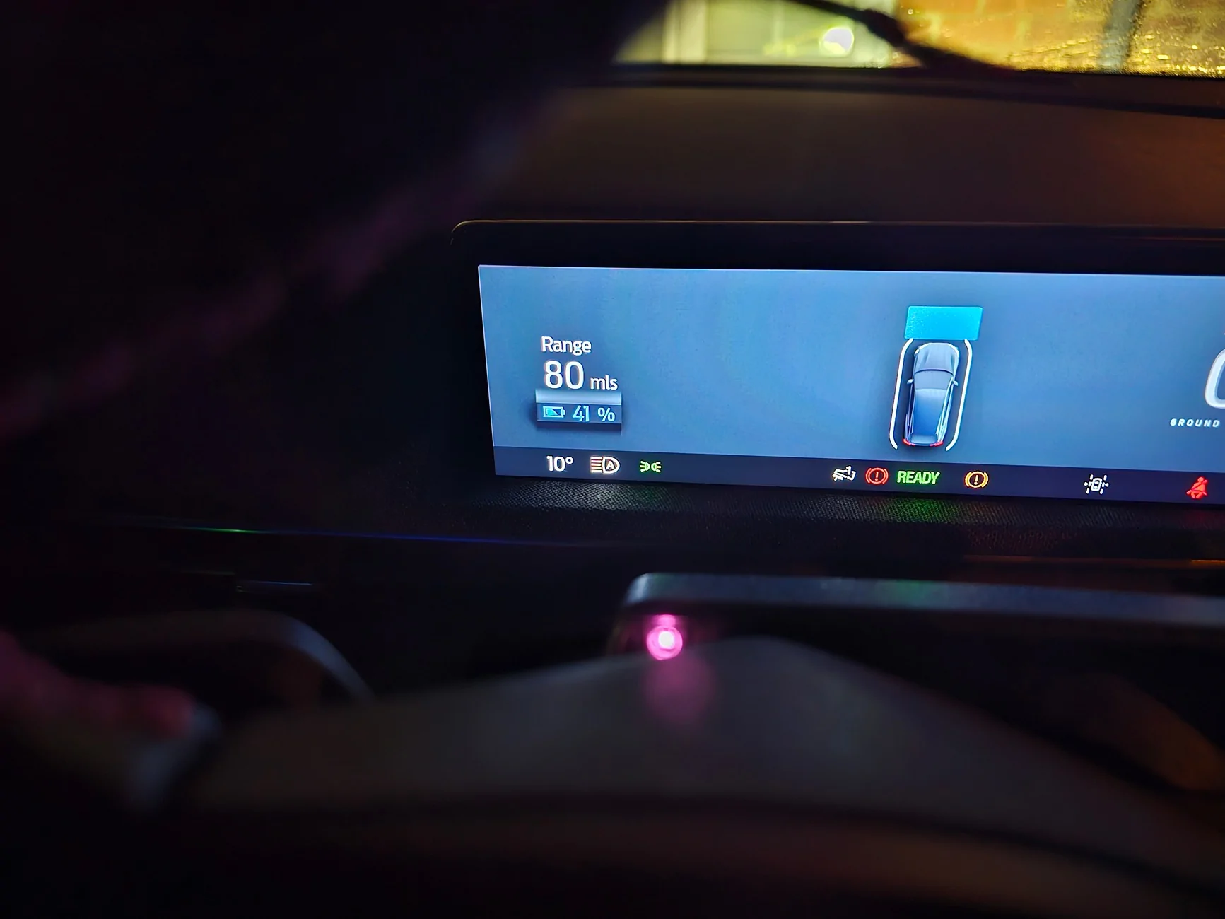

I've recently noticed that my 2022 AWD extended range battery usage has degraded dramatically of late and it can't be blamed on the cold weather as it is quite mild.
I don't drive much and only had to charge every two weeks with my home charger. Unfortunately this is awaiting repair and I am having to go to the local garage to charge which is much more expensive.

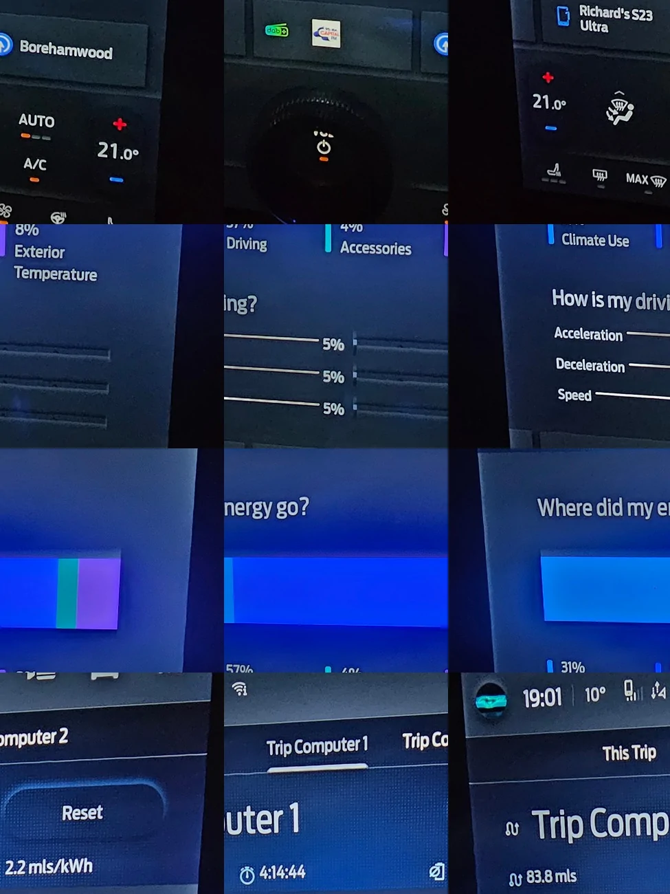

Currently I am only getting about 170 miles on a full charge and about 1.7kwh. I have taken a picture of the current trip screen which I reset after charging the last time and it has 31% climate use, 57% driving, 4% accessories and 8% exterior temp, is this normal and does anyone have any thoughts on this matter.

The climate usage seems very high for ā€œquite mildā€ weather. Try switching off the E Heat and see if it makes a difference.

If 31% of the battery usage is for climate use, try driving it for awhile with all climate controls off (or maybe just heat your steering wheel and/or seats, and note your efficiency. You can’t do anything about the 8% usage for exterior temperature, but heating to 21*C (70*F) with AC on when it’s 10*C (50*F) is going to affect your range. However, I wouldn’t think it would have that much of an affect.

I don’t think I’ve ever had climate use more than 2%, it’s usually zero. I live in California, and in mild weather, I get 1 or 2% accessories, and 98 or 99% driving, with zero for climate and exterior temp. I never use ā€œautoā€, hardly ever run fan speed more than 1 or 2, and always keep heat and a/c off unless I actually need them.
You are using almost 1/3 of your battery energy for climate. That’s where your range is going.

Your average speed is only about 20 miles per hour, which means motor energy use is low and climate use will predominate. Driving that slow is less efficient because the constant rate parasitic loads such as electrical accessories and heat will continue while there is slow progress to complete a mile of travel.
It's 10ĀŗC outside, which is cold enough to affect range due to heater use. It's not insignificant at those temps.
In summary, to be more efficient you should drive faster (about 35 mph), minimize idling, and perhaps reduce climate usage.
Thanks, the E Heat was on, I've turned it off and seen an immediate improvement on just a short trip this morning. Will see what happens when I next charge the car fully.
