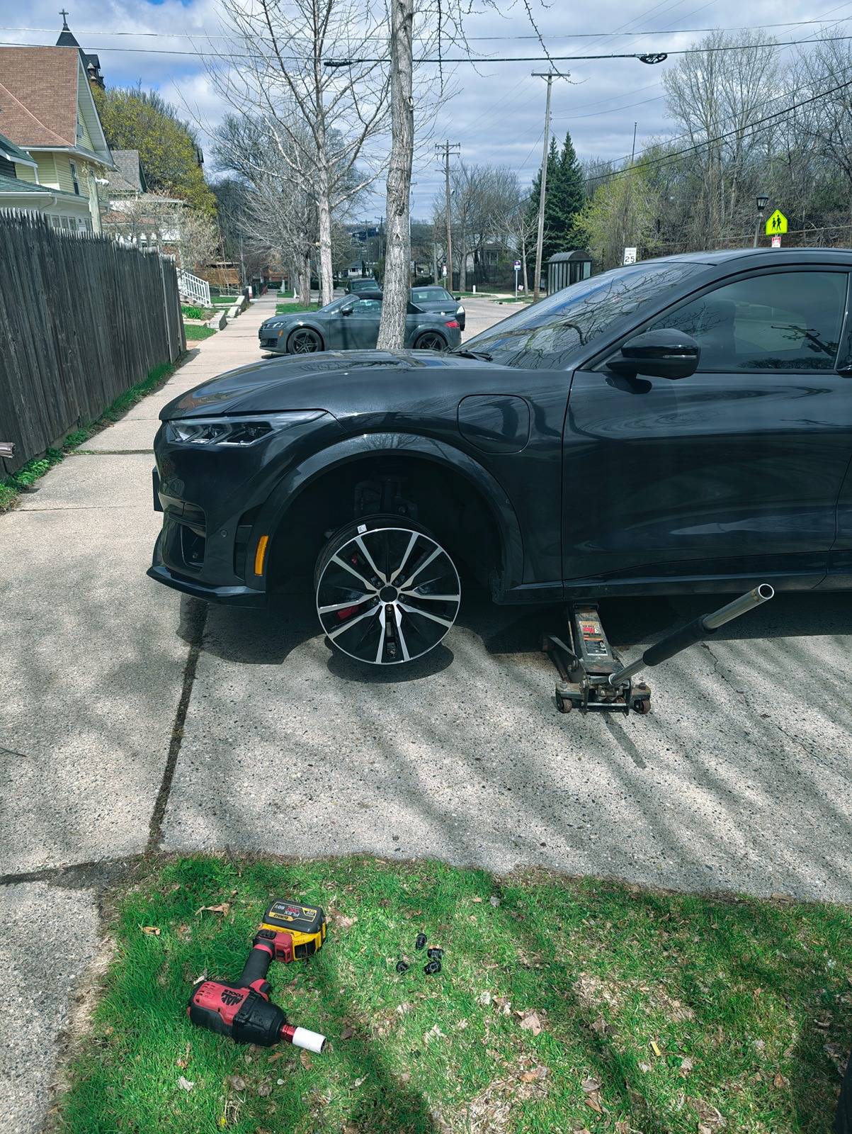

Which 19" wheels are you using? I've thought about switching to 19" when the time comes.
I have two sets a rotiform BUC-M for my summers {ordered but not here yet). The Quatrac are mounted on a set of stock Volvo XC90 recharge 19x8 here is a pic of me test fittings them.

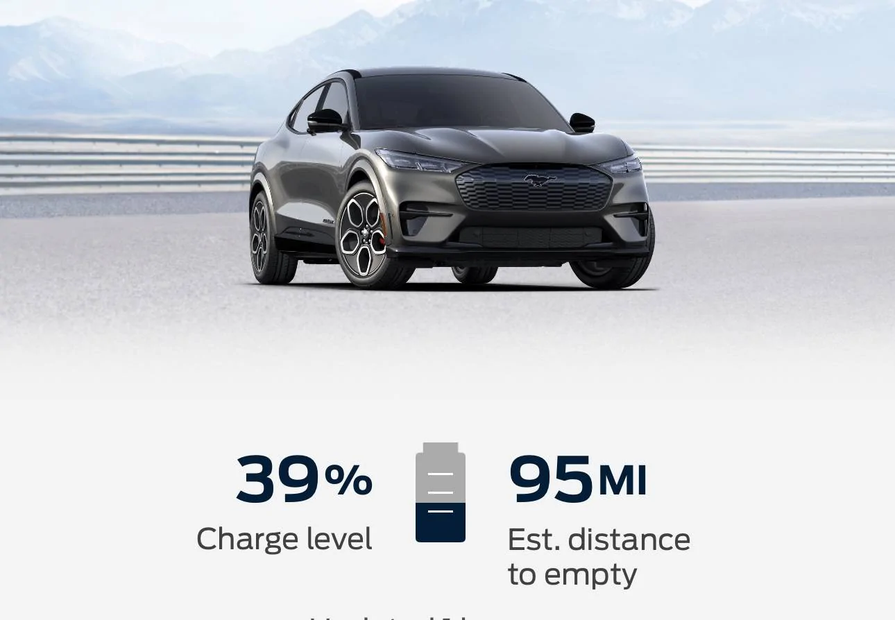

So I went on my first long drive with the car no matter what tires I had on, but today I drove with the new Michelin CC 2’s. so I’m not sure how to interpret my range. I started out at 100% 269 miles. It was in the mid 80s 95% freeway for 50 miles one-way 50 miles back. I was getting an average of 2.8 climate control and accessories were taking up a total 5% so I ended up driving 105 miles using 40%. I have 162 miles left so I don’t know what that tells me?
Not much. You are relying on the GOM which isn't reliable.

I’m just traveling around local so how far should I take it down at percentage before I run over to my free Electrify America tomorrow?

Personally I would avoid EA and only charge at home unless you are traveling. DC fast charging is more stressful on the battery and will reduce the health of your HVB faster than L2 charging. It isn't a huge deal, but I would save those free kW for a trip.
Also, I would not go much lower before charging. Low State of Charge (SoC) isn't good for the battery. Of course when on a trip, don't worry about it, but in normal use, keep it between 40% and 90%. IMO. I have frequently taken mine down to 10% or lower, but only when on a trip. In normal use I rarely let it get below 50%. (More than once I arrived at home with 2% SoC. My son was freaking out. I was fine. :crackup: )
Anyway, what are you trying to measure with the trip to EA? You could measure the kW added and divide that by the miles traveled to get your true mi/kWh. But that will include charger loss, which can reach 10%, especially with L2 charging.
If you are trying to determine the efficiency impact of the new tires, you have to have good data before they were replaced in order to compare to after.
