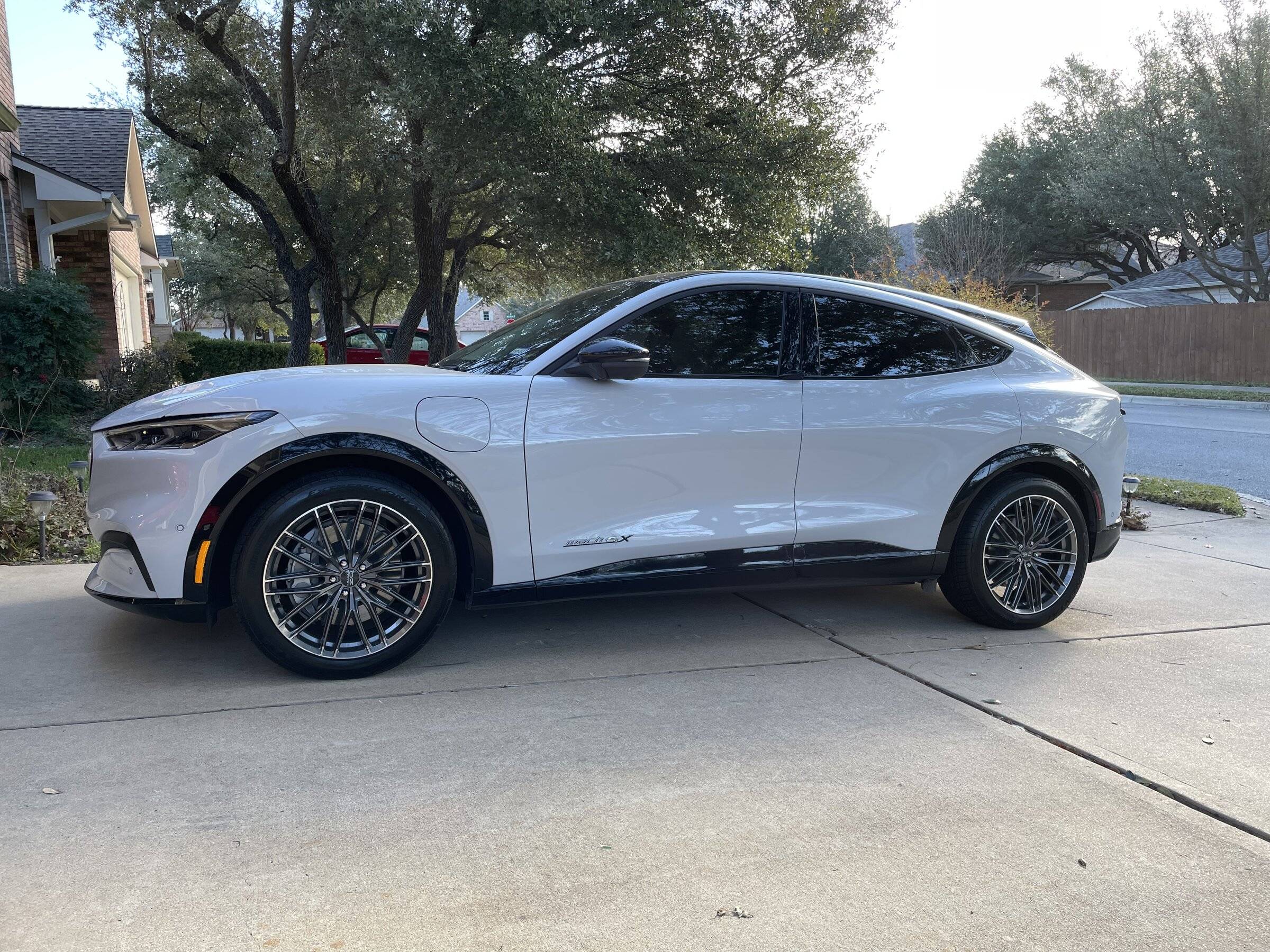

Cool. Apparently we are opposites. My wife wanted wheels for her 4X so we got some 20x8.5” OZ Racing Gran Turismo HLTs with 255/45 UHP A/S rubber. Lost about 10-15 miles of range from the looks of it but well worth it for the increased grip and better looks. ??‍♂
Another thing to consider - although aerodynamics are really important for range, getting a lighter wheel/tire combo also reduces unsprung weight. This improves acceleration, handling, steering feel, and ride. And the lighter weight offsets some of the inevitable range loss due to increased rolling resistance if you choose wider, stickier rubber.

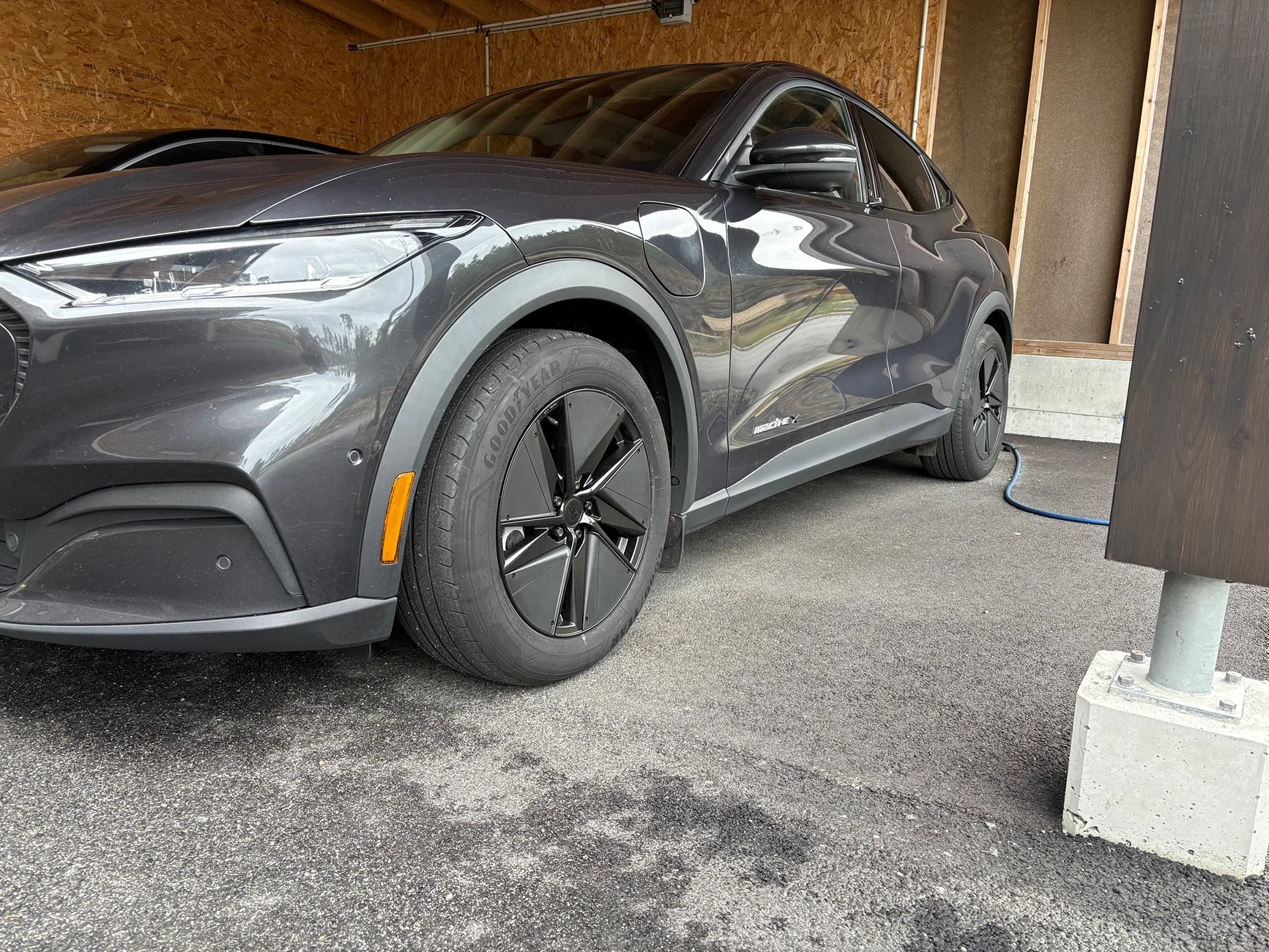

Those wheels look awesome on your Mach-e! I really want to try and optimize the range and efficiency to see what I can get out of my SR AWD. Since I don’t have the larger battery, range loss is more of a factor.

I haven't bought yet, I decided to run my stock wheels for now. I'm going to wait and see what other options come onto the market before I drop $1,000+ on new wheels. Most of the options out there required me to run wider tires and would therefore increase the cost and offset the the limited efficiency gain.

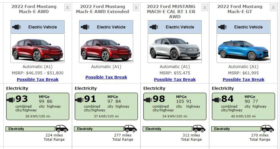

Update: i put a set of CR1 wheels on my GT. From San Francisco South Lake Tahoe, in winter, driving speed limit, i arrived multiple times with 22-24% charge remaining (15-55 degrees). On the GT wheels in the fall, i would arrive with 9-11%. 195mi drive, with a 7,500 foot elevation gain. Pretty impressive results.
For guaranteed results, the California Route 1 wheels and tires seem to be the best combo for max range. The heavier Cal RT 1 AWD ER has a higher MPGe than the base standard range Mach-E. The only notable difference between the two cars is the wheel. The difference between the AWD ER and Rt1 ER is literally the wheel, since they have the same everything. I'm waiting for someone to throw an ER wheel on a GT. Something else to consider: The Rt1 wheel and tire combo is narrower (225mm) than the GT wheel (245mm). The Rt1 Tire is also has a higher sidewall. Increased sidewall height increases the fore-aft contact patch which is better for straight line acceleration. A wider, narrower profile tire has a more pronounced right-left contact patch, which is better for cornering. I can't wait to see some straight line acceleration and efficiency tests on a GT with a Rt1 wheel/tire.
Pulled the efficiency from fueleconomy.gov
https://fueleconomy.gov/feg/Find.do?action=sbsSelect&id=45138&id=45139&id=45140
Aero Covers (a fancy name for hub caps), are certainly more complicated than the similar name change for pleather to "vegan leather", as shown off in this article from Audi. Obviously still not far off from still just being a hub cap, but interesting anyway.
https://www.progress.audi/progress/en/audi-aero-wheel.html
I've been casually looking for a set of CR1 wheels, but they're pretty hard to find right now. It would be interesting to get a set and put CrossClimate2's on them for winter use.
I also think it would be interesting if someone made a new aero cover for the GT petal wheels which covered up more (all?) of the openings.
