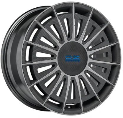

Another option I found during some searching - OZ Racing's Superturismo AERO-E - available in a 19" and 20", wide range of widths and offsets, and it has inserts between the spokes as well as a nice flat cover for the hub. Dimpled for improve aerodynamics, apparently.
https://www.ozracing.com/alloy-wheels/oz-racing/i-tech/superturismo-aero-e
Ford Mustang Mach-E Function over Form - Best wheels for pure efficiency that support the Mach-E? 1647978420107
I don't know if it is available in our drilling or hub bore, but it is likely to be possible as a special order, need to reach out to them. If their similar Superturismo line is any indication, cost for 20" rims would probably be in the $650-750 each zone.
EDIT: TireRack appears to the the main US dealer for OZ, I just sent an inquiry to see if they are available in our drilling and offset range. Will update when I hear back.

Interesting, they are pretty much molded inserts for their wheels … curious.
