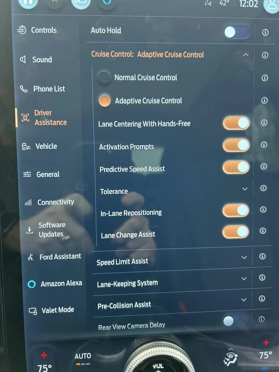

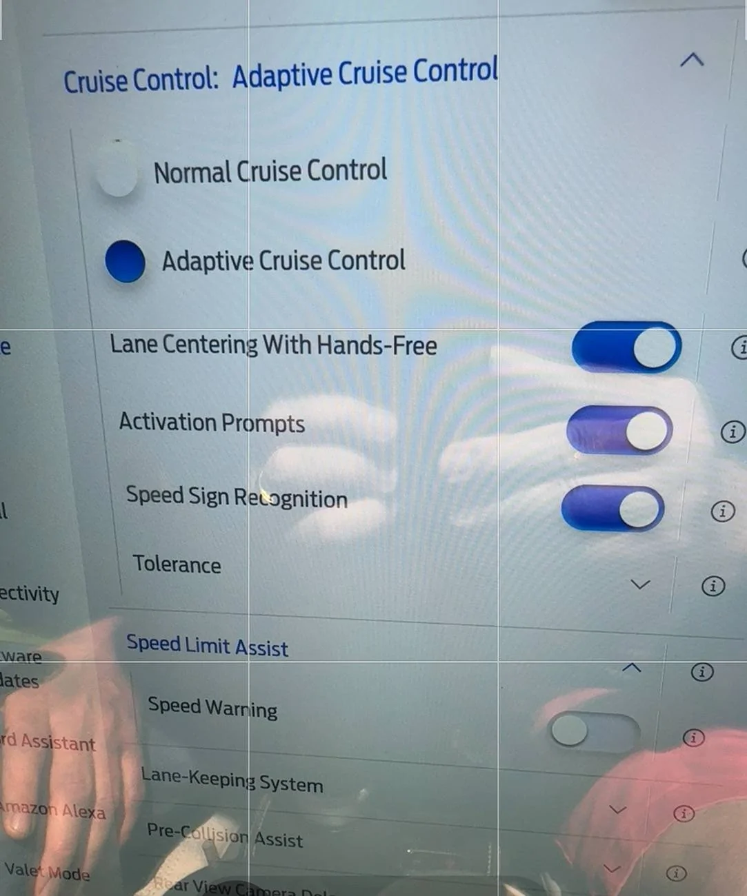

I don't see any In Lane Repositioning option
Ford Mustang Mach-E BlueCruise: How does In-Lane Repositioning work? 20240725_094012

What are the updates that are missing?
my screen lacks in- lane pisitioning and Lange assist.
Not 100% sure. But looking back I see that 6.2.1 (for 2021 Mach-Es a.k.a. 23-PU1103-NAC-VCE for newer Mach-Es) was the last APIM (SYNC) update I got about a month before the BC OTA update.

So, we don't have In Lane Repositioning :sadface:
