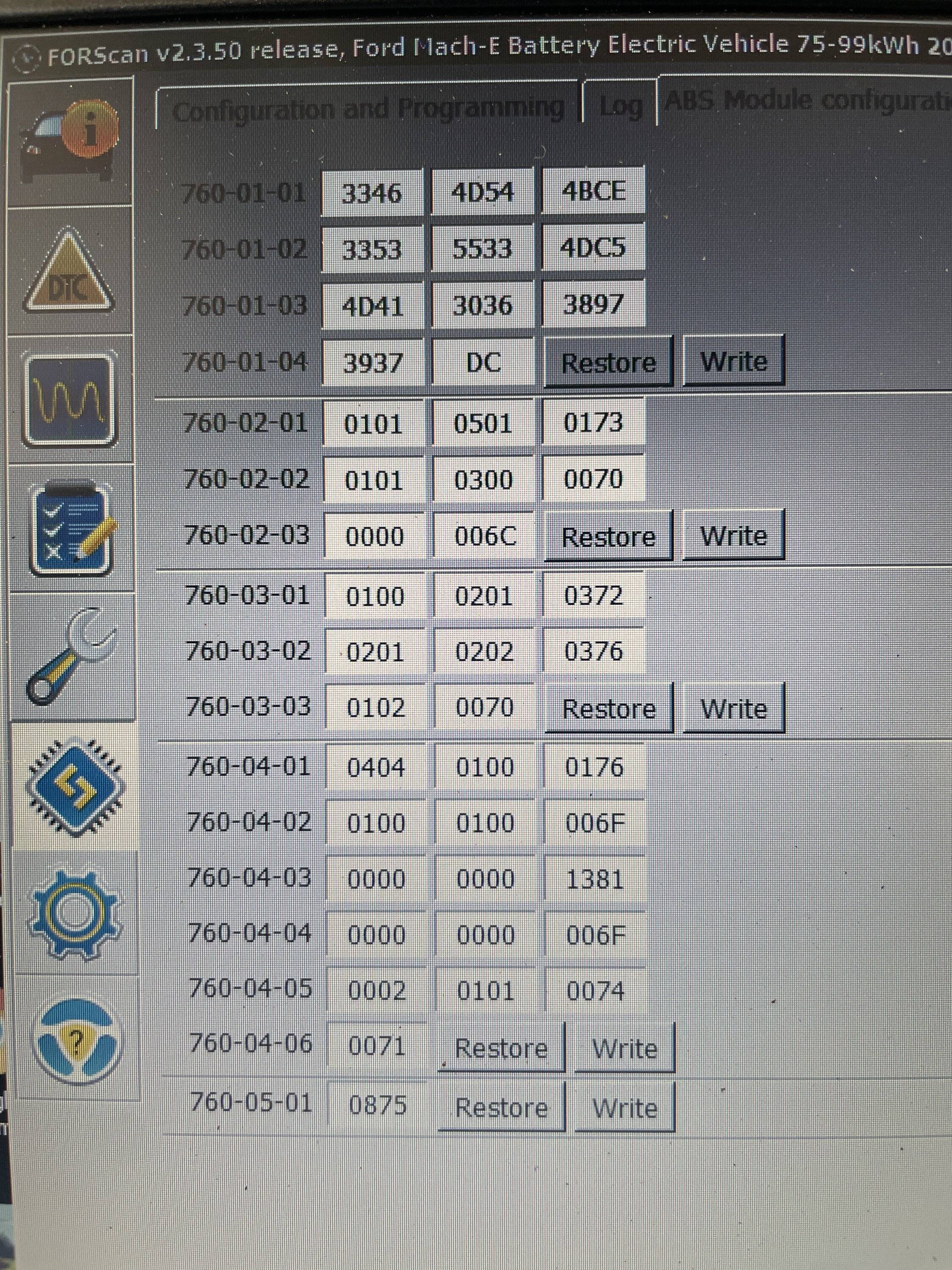

I looked in Forscan today and had a pile of DTCs. Yippie. Looks like my IPMA is still freaking out at random as I didn't have DTC's 2 weeks ago. Looks like any time I get the front collision failure warning it's adding in all these others. I'll reset and do the brakes tomorrow (fingers crossed)
