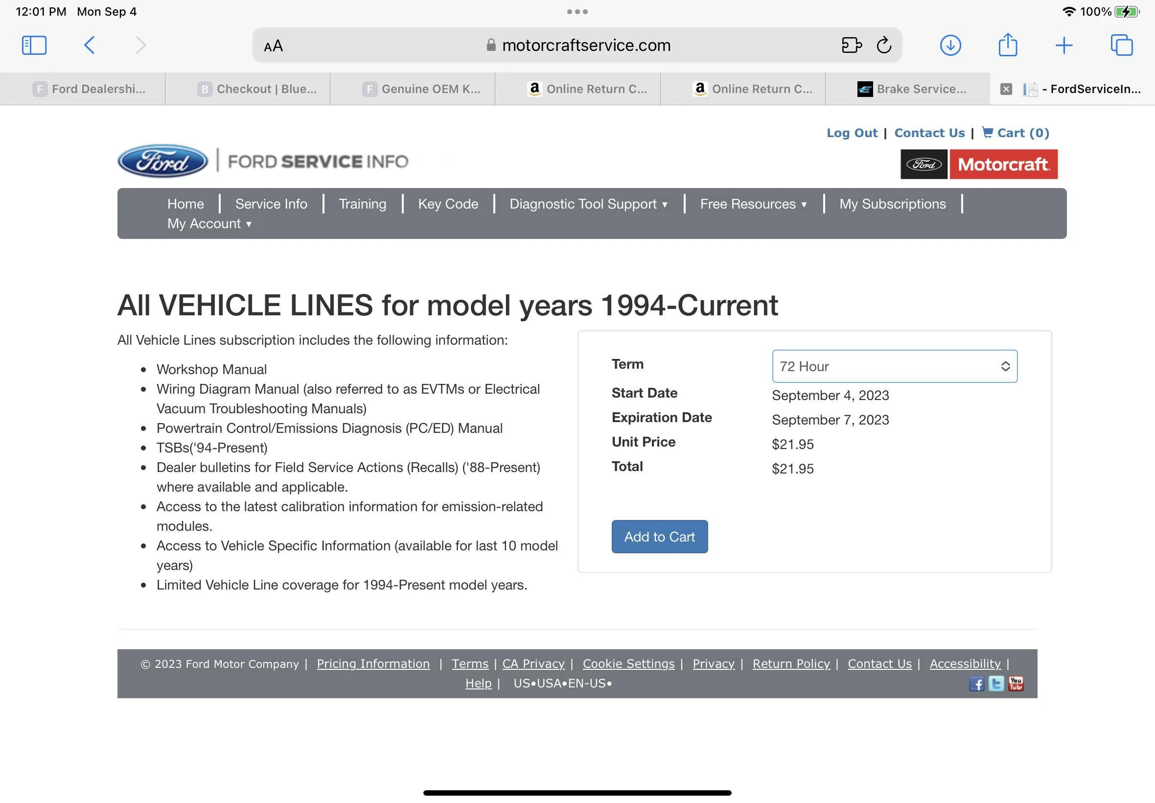

Would this possibly help me?! Service info, wonder how up to date all is?
Ford Mustang Mach-E Brake Service Mode- Final Update IMG_0041

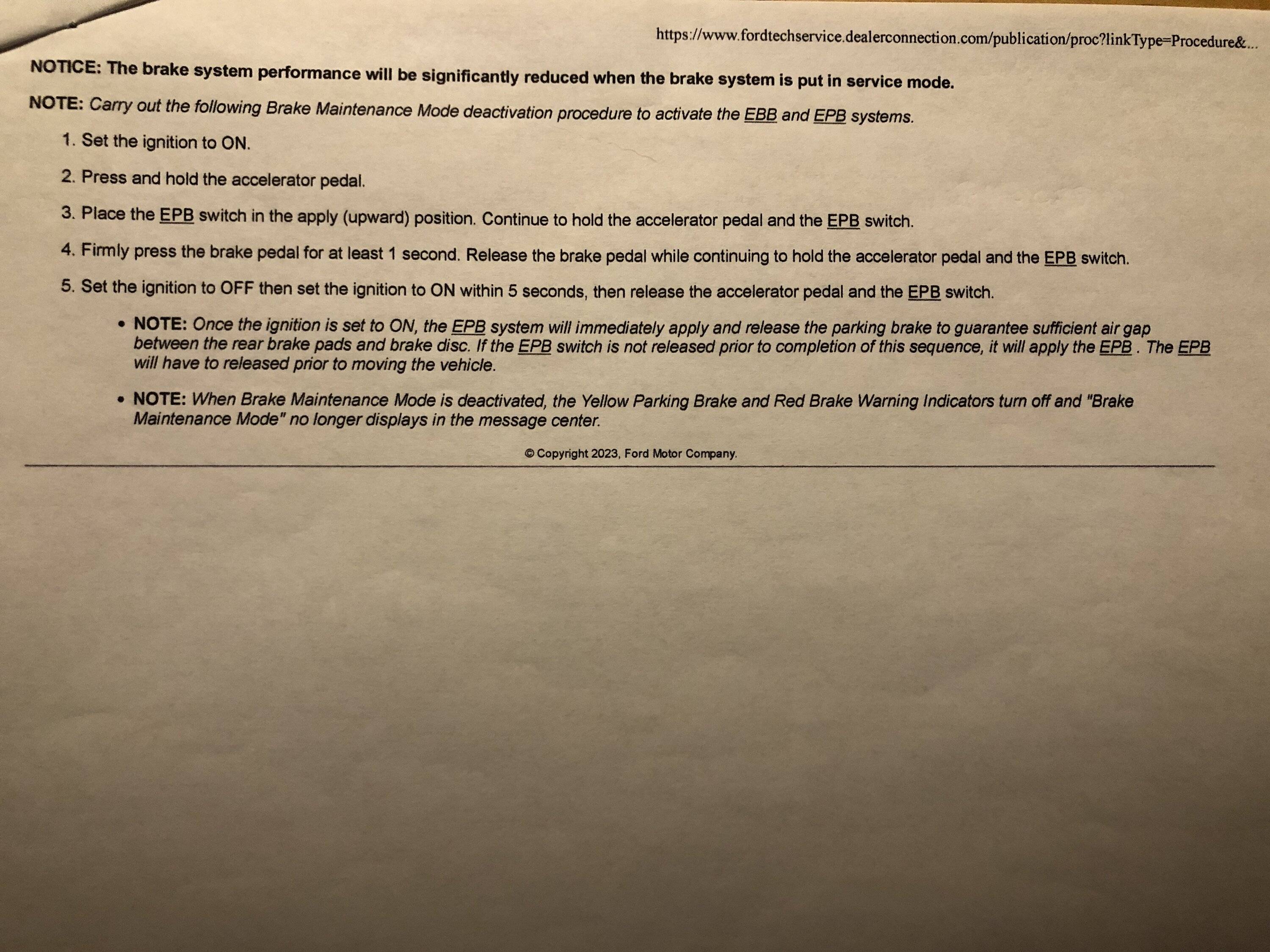

FINAL UPDATE-
1. to dealer on 9/5
Tech cleared any codes using FDRS
Tech then used 8-11-23 workshop procedure to deactivate brake service mode, then activate & deactivated again
2. car OK

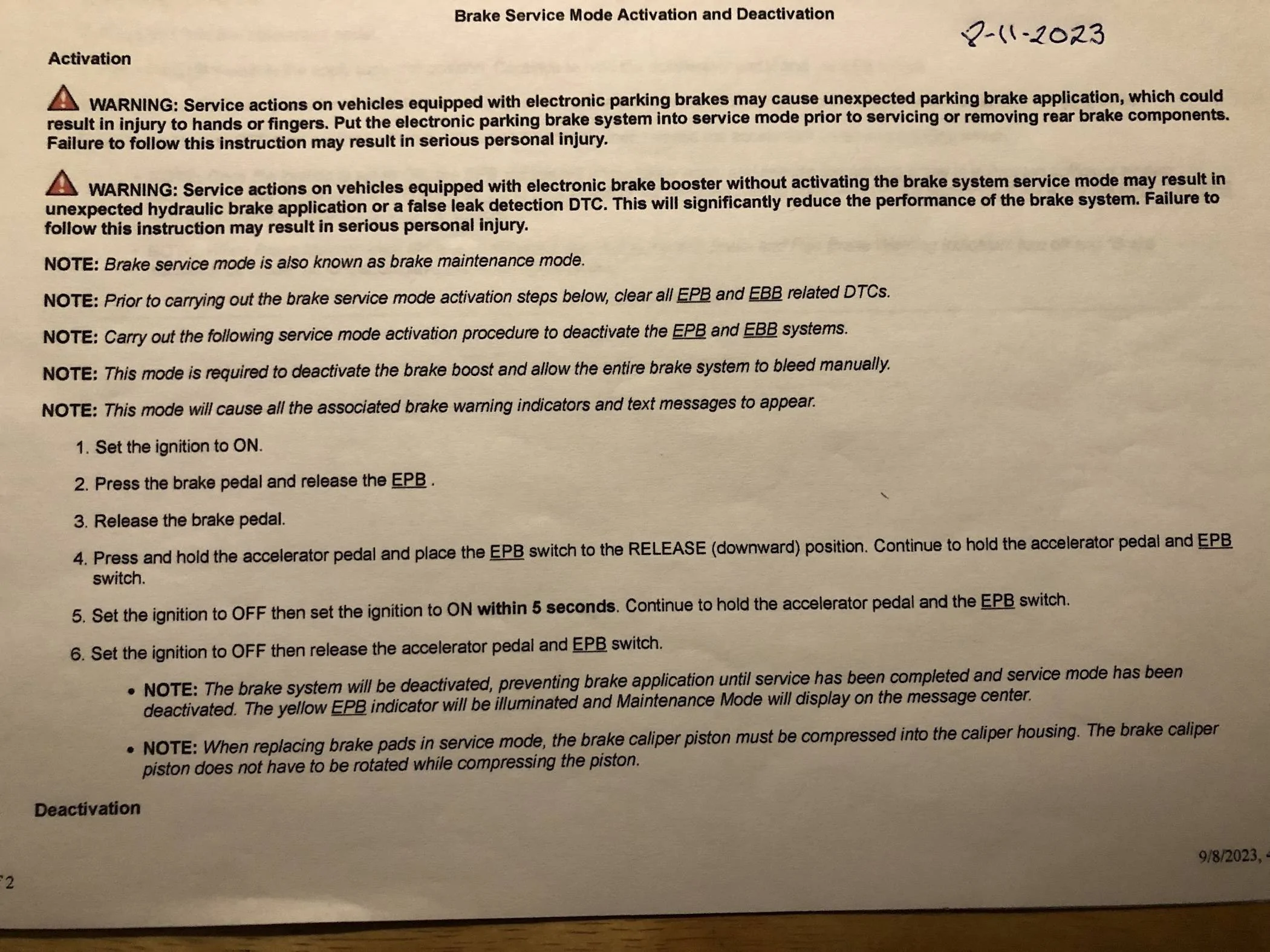

I have updated workshop instructions dated 8-11-23
One thing you must do, is make sure you have no DTC codes in the ABS module.
I will take pictures of the instructions and post on here.

Updated instructions for Mach-e “Brake Service/Maintence Mode”. Bill P
Ford Mustang Mach-E Brake Service Mode- Final Update IMG_0503
Ford Mustang Mach-E Brake Service Mode- Final Update IMG_0504
