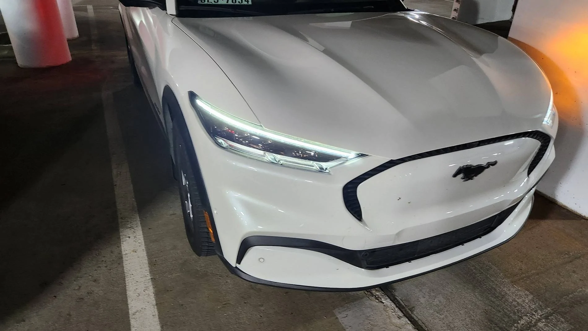

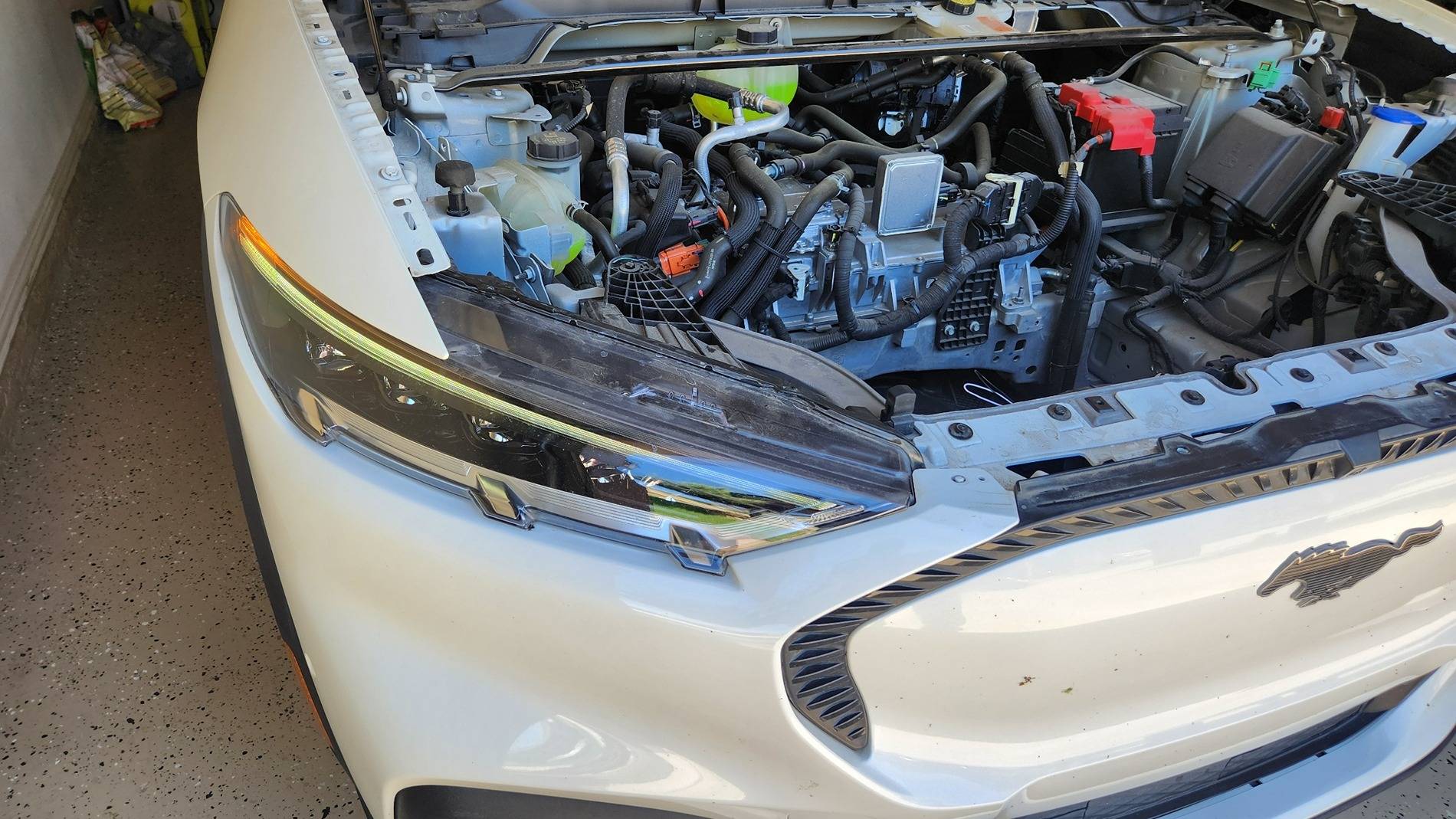

Hi Mark,
I was so focused on the front pony? that I didn’t notice anything else. Today, when leaving work , I noticed the orange side marker light on the passenger side wasn’t working. When I got home, I reconnected the original harness and the light came back on. I’m not sure if the new harness will resolve the side marker issue as well. Any thoughts?

Has anyone else installed the front pony on a Select trim with the low configuration lights?

Hi Mark,
With Front pony Harness
With Factory Harness
I can only assume there is wiring mismatch on the Y cable. I will look into that when I have time but this really isn't what I signed up for. ? I just wanted to help out with the shipping and ended up fixing the faulty connectors to make the ponies light up. Good news is, the connector I sent you WILL light up your pony. I just had a member who has a Select and told him what wire to change on the connector. He did and it works!!

Ash (Mr.GVAK) figured out the side marker issue but takes to pins to be moved, one in each connector. That said, Bruce is going to have all new connectors made with both the proper pony turn on and side marker wiring. ?

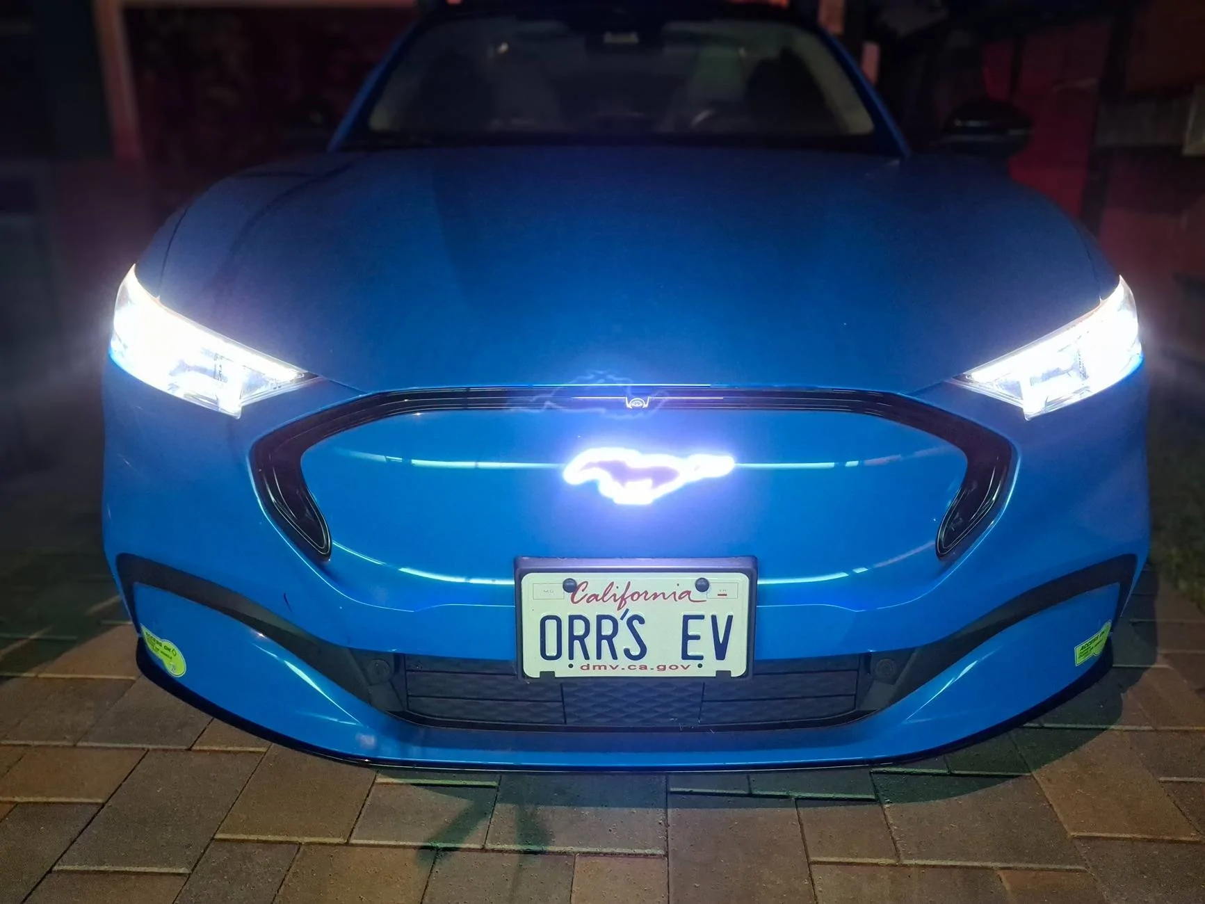

So I installed the pony with the wiring configuration fix Mark illustrated earlier in the thread. Works perfectly. And it's bright as hell! ⚡?
One note I'll add from my install. As somebody mentioned earlier, the wires are really short. If you run it across from the pony to the headlight there's just enough wire. Because of this, I couldn't tuck the transformer/reducer box thingy away somewhere or ziptie anything. But I didn't want it floating around banging inside the compartment. I was going to double-sided tape it to some plastic molding, but then thought, what if I have to remove it for some reason? The recess it's in is really tight space-wise. So instead, I velcroed it to the that plastic piece. That way I can just grab it and pull it out if I need to. Unfortunately, I was in a rush, so forgot to take a pic. But when you get in there, you'll know what I'm talking about.
