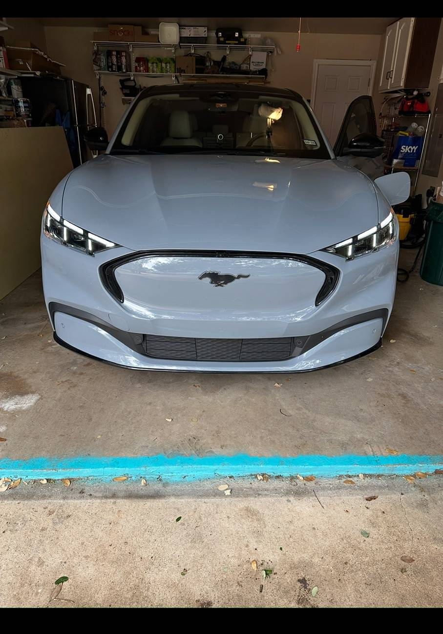

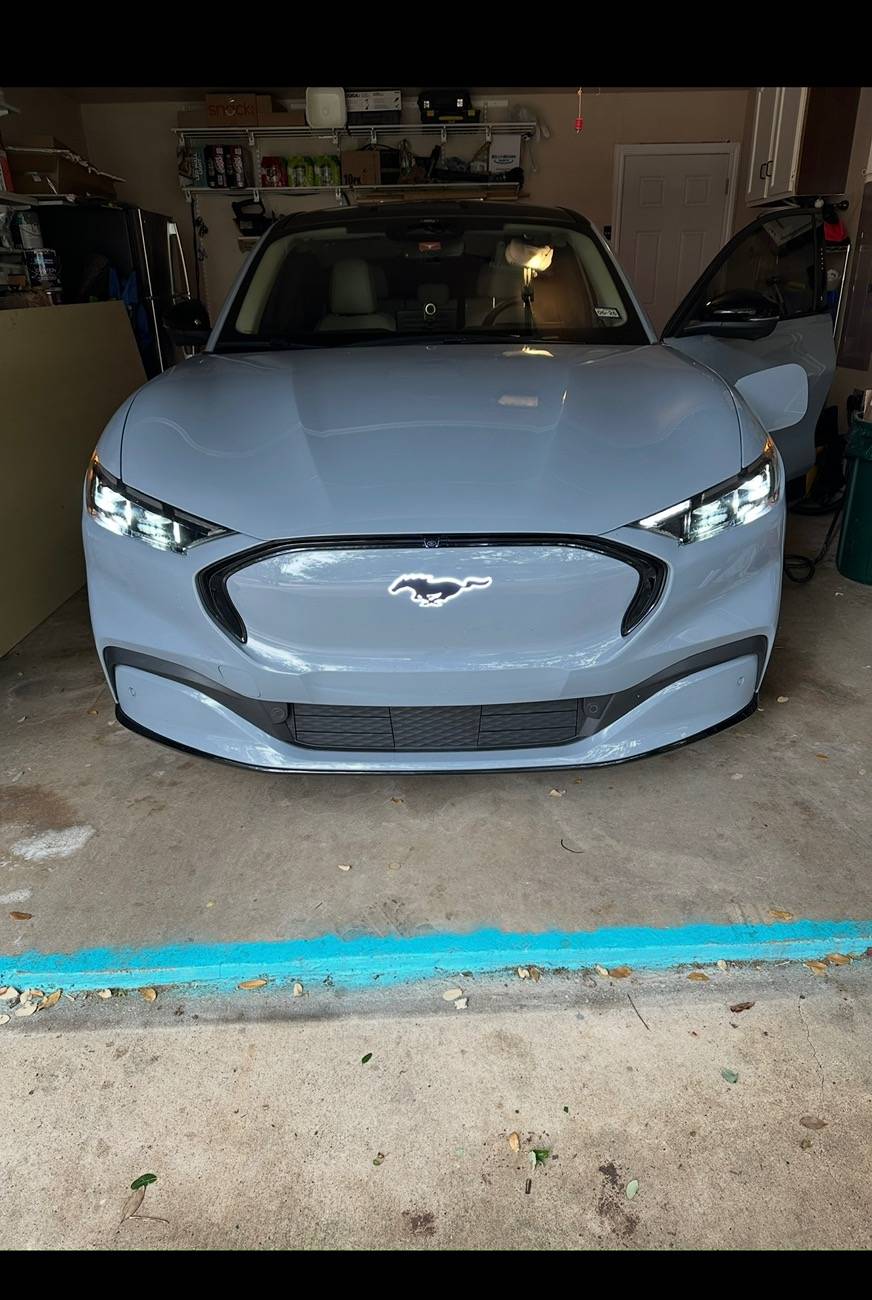

Hey friends - installed both the front and rear ponies this weekend. They look amazing! I have a 24 Premium and did not get the new High configuration adapter but was able to follow the previous posts re-wiring instructions to get it to power up.
My question is - is the front supposed to illuminate with the daytime running lamps / unlock sequence too? Or is it only going to illuminate with the actual head lights turned on.
I did not move the wire from the connector to the other slot as mentioned a few months ago on premiums - I do not have the issue where it stays illuminated after the car is powered down.
Wondering if I need to request the High Config harness and just rewire when it arrives?

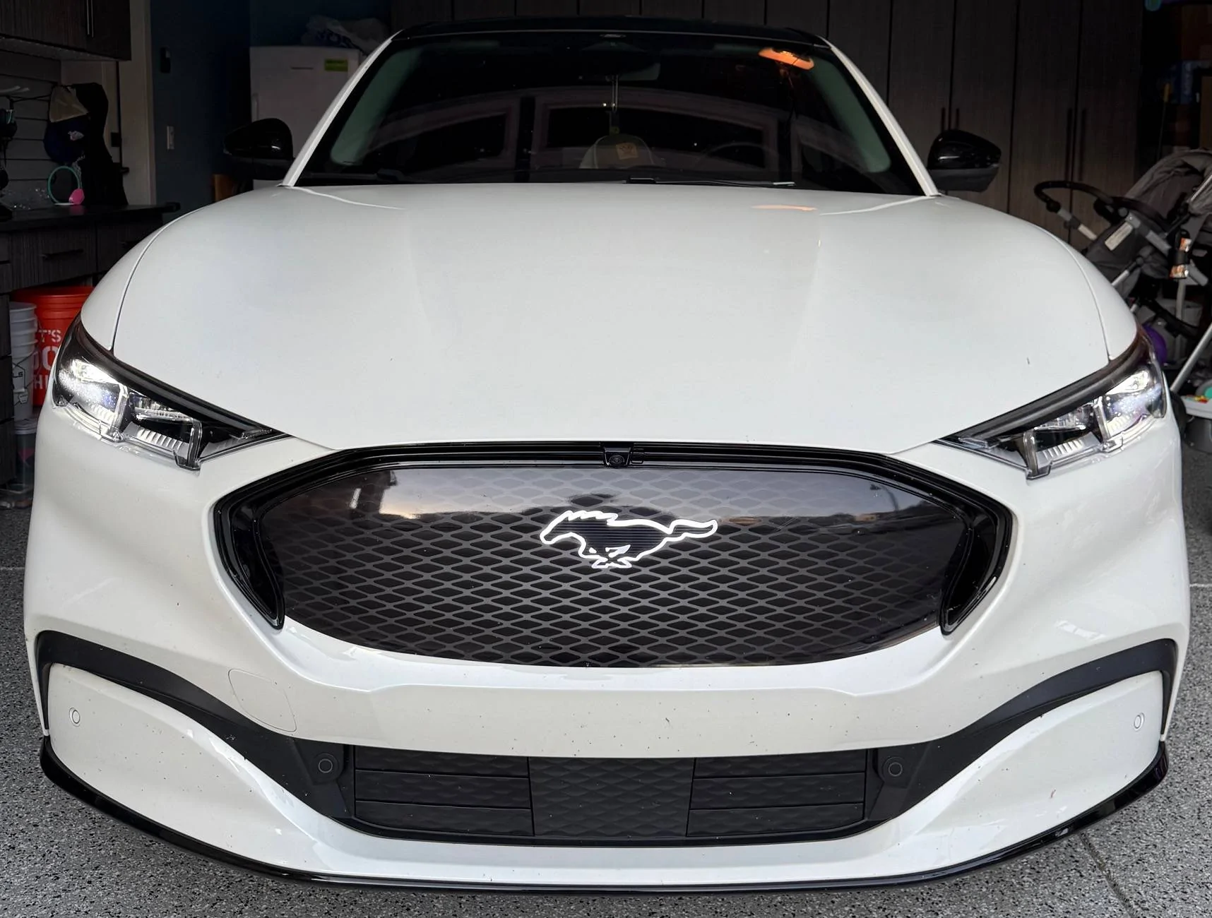

21 premium. Installed front pony after receiving the new harness. No issues. Looks great. Did not have to take off the front camera connections as in the instructions video.
Pony lights up only when the headlights are on. Which I think is expected.
