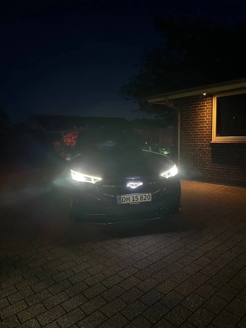

Hi guys from Denmark here, I Installed the front pony from BSKT Design yesterday and made a installation video, there is no issues in the connector, the pony looks amazing and is always on, there is people in the UK that has installed it too and the same no issues, seems this connector issue is just to USA Mach-E’s, however i got good news as im in close dialogue with Bskt design they are producing a new connector that fits in all Usa Mach-e´s coming very soon. Stay tuned ?
Hey Jannick, nice to see those ponies all lit up!
Yes the US has different wiring than the rest of the world and while some US Mach-E's will work with the ponies, others do not. Not only did Ford have different headlamps between various models in the US but they also changed wiring from '23 to '24 models. In any case, as I mentioned earlier in this thread, I talk with Bruce (owner of BSKT) on a daily basis about these issues, future products, shipping, etc for US customers. He is sending the new connector/harnesses to me for final testing on various Mach-E's then I'll be shipping them out. I don't expect to see them before the middle of next month.

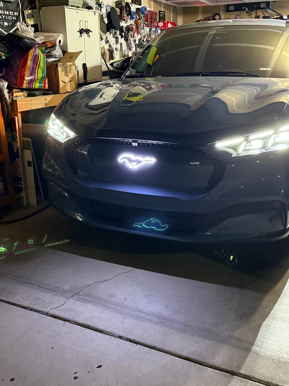

Ford Mustang Mach-E BSKT Design LED Ponies IMG_0247
my lit pony after install. I used the updated harness you sent me and even though it was a pain in the butt to install, I love the look now. Biggest issue I had was removing the old pony due to the clips on the back (couldn't get my hand in there and trying to use a screwdriver to remove them was a major pain.) was finally able to get the old pony off and installed the new pony but could only get 2 of the clips on the back posts. then after getting it installed and all the frunk panels put back in it didn't work. I had to redo the wiring from the harness to the pony. but as you can see it now works. oh one other thing.... the wires were too short. I had to maneuver the harness box into the area by the headlight plug to get it long enough to reach the pony wires. suggestion - make either the pony wires or the harness wires longer.... can always tape up the extra vs trying to make a short wire longer.
