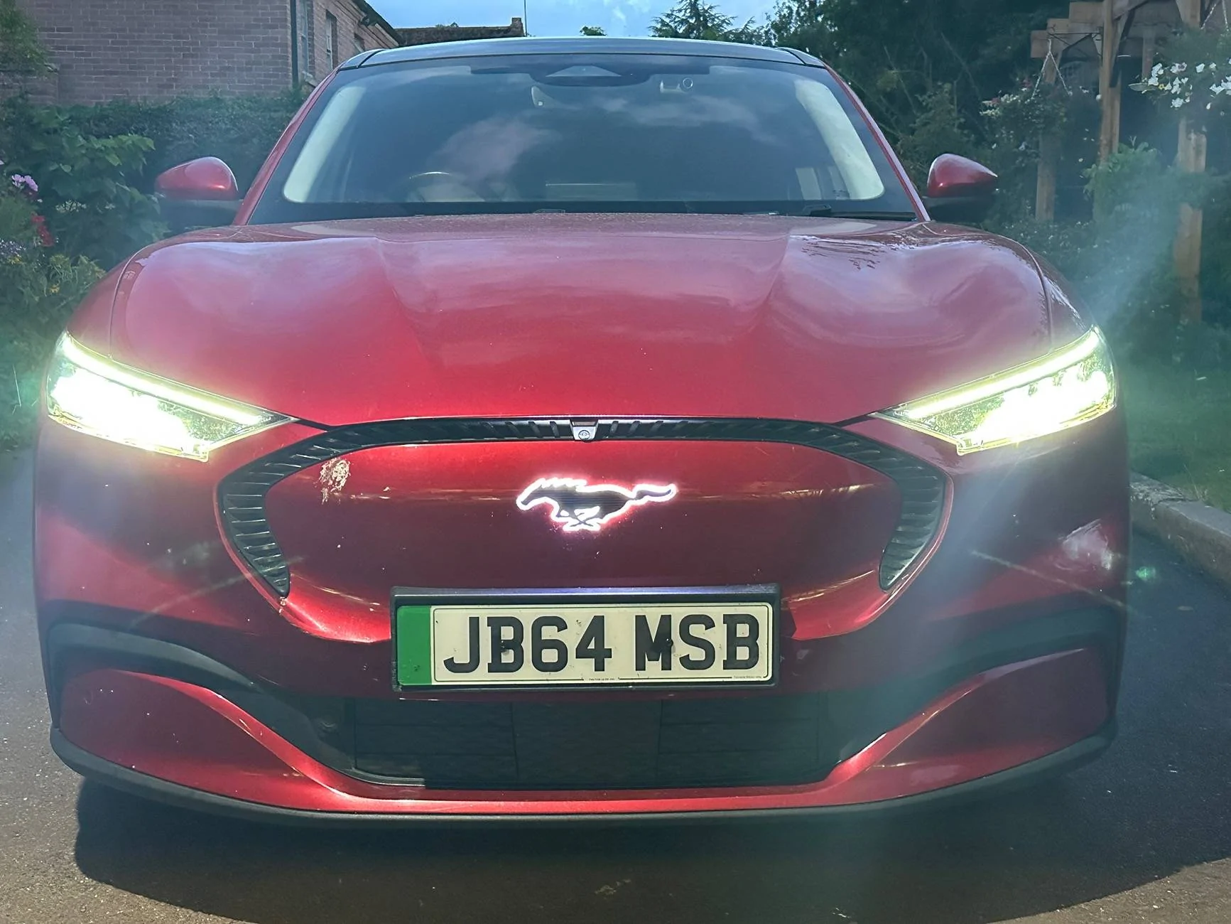

Just had the rest of this from EE-Vida ?
Ford Mustang Mach-E BSKT Design LED Ponies IMG_9020
