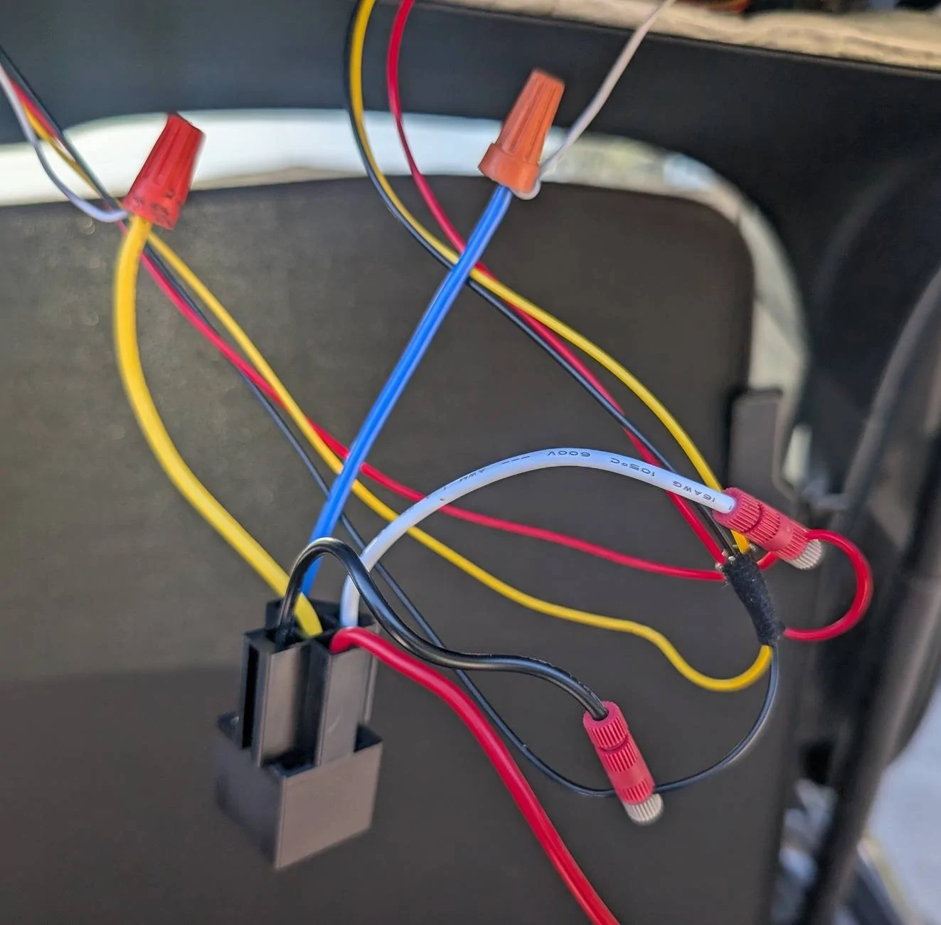

First off, sorry...I'm an engineer who can't leave good enough alone.
I like the BSKT rear pony turning white when in reverse, but it completely wipes out my rear camera view at night. I've tried taping over part of the camera as suggested in another thread, but no luck. So I wired in a relay to inhibit the pony backup light when the taillights are on.
Cheap relay from Amazon:
https://a.co/d/bNn6abY
Triggered by the red wire on the pony harness, the pony white wire is NC and opens when the relay is powered. Pretty simple and works great!
Relay white tapped into pony red
Relay black tapped into pony black
Cut the pony white wire
Relay blue to white wire to car reverse light
Relay yellow to white wire to pony
Cap the relay red wire and tuck everything up behind the plastic cover.
You’re an engineer who can't leave good enough alone - is THAT really your wiring ?
What a rat’s nest of potential failure points, and those amateurish connectors?
I installed the EV-Vida front & rear ponies and the grey wire that should be connected to the reverse light harness I spliced in, soldered and heat shrink wrapped & tied all the wiring nice and secure.
That is my wiring open just after testing so I could take a picture of it and explain the mod. If I'd taken a picture of it after solder, heat shrink, wrapped and ties, you wouldn't be able to see anything. ?
All very well rolling your eyes as if were obvious.
It was not.
You didn’t clearly state this from the outset and, in fact, wrote: “I wired in a relay to inhibit the pony backup light when the taillights are on.” producing your picture as an illustration of this.
A lot of people come here to for knowledge & advice.
When they see an engineer who says he doesn’t even do “good enough” they are likely to follow his/her example and advice.
Without a proper explanation that the picture was a temporary mock up for illustrative purposes, people less qualified looking to the likes of us as experts for good advice & guidance are left misled by this sort of thing thinking it was complete and good in all respects.
So, explanation was lacking.
As somebody who’s been a vehicle fire investigator I feel qualified in saying that people should know the risks of using this kind of connector, and so many, as you illustrate.
As the clamping force of connectors of this kind, or others crimped rather than soldered, on conducive cores of the wiring relax as they might over time, or oxidation of their conductive cores bared by the connectors occurs, the risk of resistance there materialises, with resistance comes heat (look up resistance heating) with the potential consequent effect of fire exposing vehicle occupants, other road users and others nearby to the risk of property damage, injury or even death!
