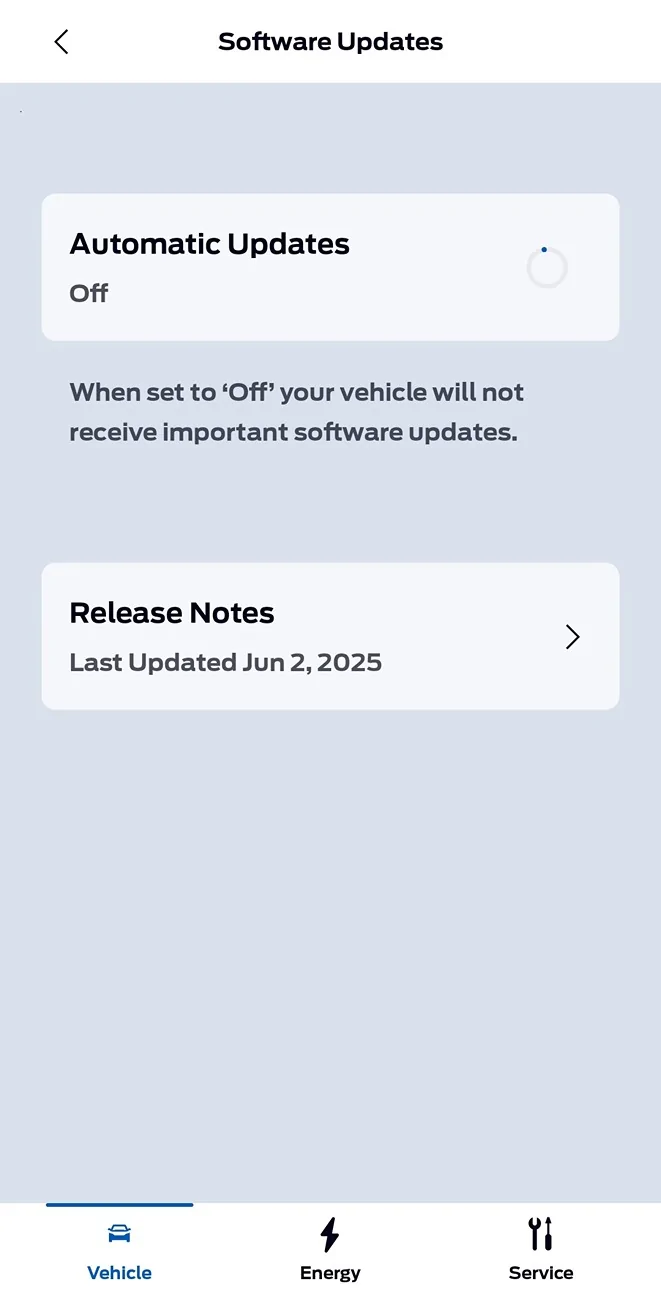

Just noticed that Fordpass had automatic updates toggled off so attempted to turn on but just resets to off. Went to MME controls and attempted to see what the status of the software updates were but that just hangs forever. I'm guessing these issues are related and went thru previous issues with both issues but found nothing that helped mitigate either. Thoughts are welcome at this point. As usual, thanks in advance.

It's a known issue after a recent GWM update. Disconnect the negative cable from the 12v battery in the frunk for 20 minutes. Once you reconnect it, check for updates again and it should make it past the spinning pinwheel in the screen where you check for updates.

Full disconnect did the trick. Thanks for making me smarter at least for a moment. As much as AI can do, there are some issues that need a human to intervene. Appreciate you being that human for me today!

I had this same problem with my 2023 Mach-E Premium eAWD, and haven't received a software update since November 14, 2024. I shared this fix with my dealer when I took my car in for service back in April, but I think they ignored the suggestion and supposedly did manual updates via USB drive. I write 'supposedly' because the software version showing on the in-car display and in the App never changed from November 14, 2024. I finally got around to trying this fix myself and it worked! The 'automatic updates' toggle switch is finally enabled.
