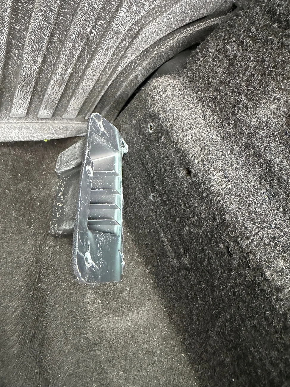

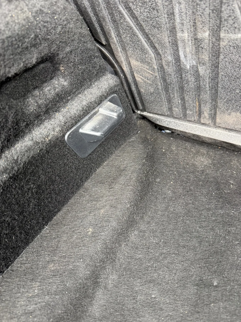

I searched before posting and didn't see anything. Maybe I'm calling it the wrong thing. This part broke that supports the floor in cargo area. It appears it was one piece with some kind of peg that went into the body and that was enough to hold it up. Well, It didn't hold up to heavy suitcases. I was considering drilling hole in the part where the pegs went into the body but I can't tell whether that might pop through to the wheel well and cause rust. Has anyone ever dealt with this? Does a replacement support bracket exist that can be ordered and just pop in? Other solution?
Thank you in advance for constructive comments. I included a pic of the broken one and ok one for comparison.

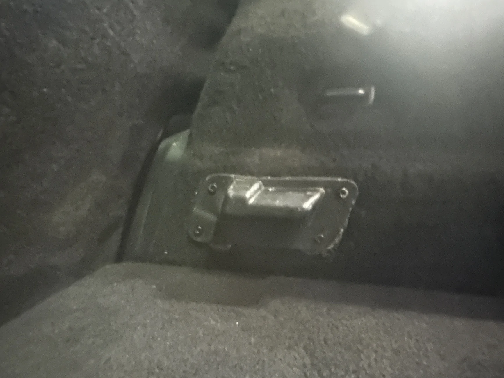

I broke mine with 500kg of tools bouncing up & down on it!
There is a plastic backing plate inside there about the same shape and size as the part of the support which faces the softer trim panel.
It is just possible to get your hand inside the trim panel, hold up the plastic backing plate, drill holes through the post-like sections of that backing plate so when you’ve also drilled holes in the correct places on the support, screws of just the correct length can be used to screw the support to the backing, sandwiching the softer trim panel.
Then, lower the board when you have a heavy load😁

Re-attach it with pop-rivets. No drilling needed.

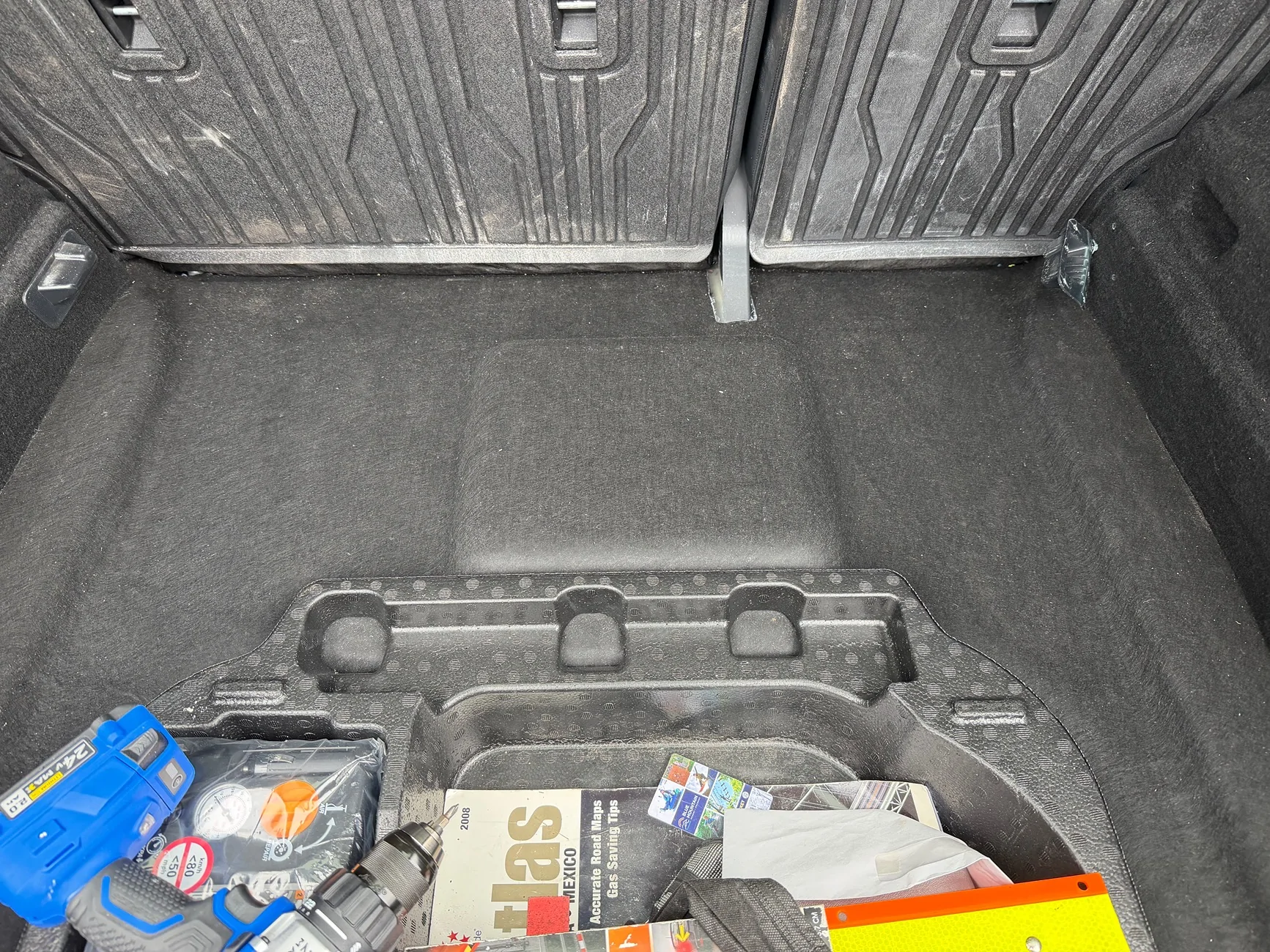

You can also bypass the bracket by lowering your cargo deck so it sits below the brackets. This increases the cargo weight capacity. The bracket is only necessary if you need the deck to be flush with the seat backs when lowered.
